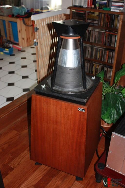

I know that the Ohm Walsh series speakers have a shield at the back side of the omni-driver in order to reduce reflections that radiate to the back against the walls. Just like these Harman Kardon Citation speakers. Omnidirectional speakers As you can see, behind the omni driver there is a baffle that reduces wall-radiation
With dipoles, you want the speaker to radiate backwards, so they need a lot of space behind them. With omnis, you don't generally need them to radiate backwards. Usually, 180°-240° or so dispersion is fine (these numbers are not well-document or anything, it's just my arbitrary guess; point remains the same 🙂 ). Therefore, installing a baffle that limits some direction of dispersion can be very beneficial if you plan to place the speakers close to a wall

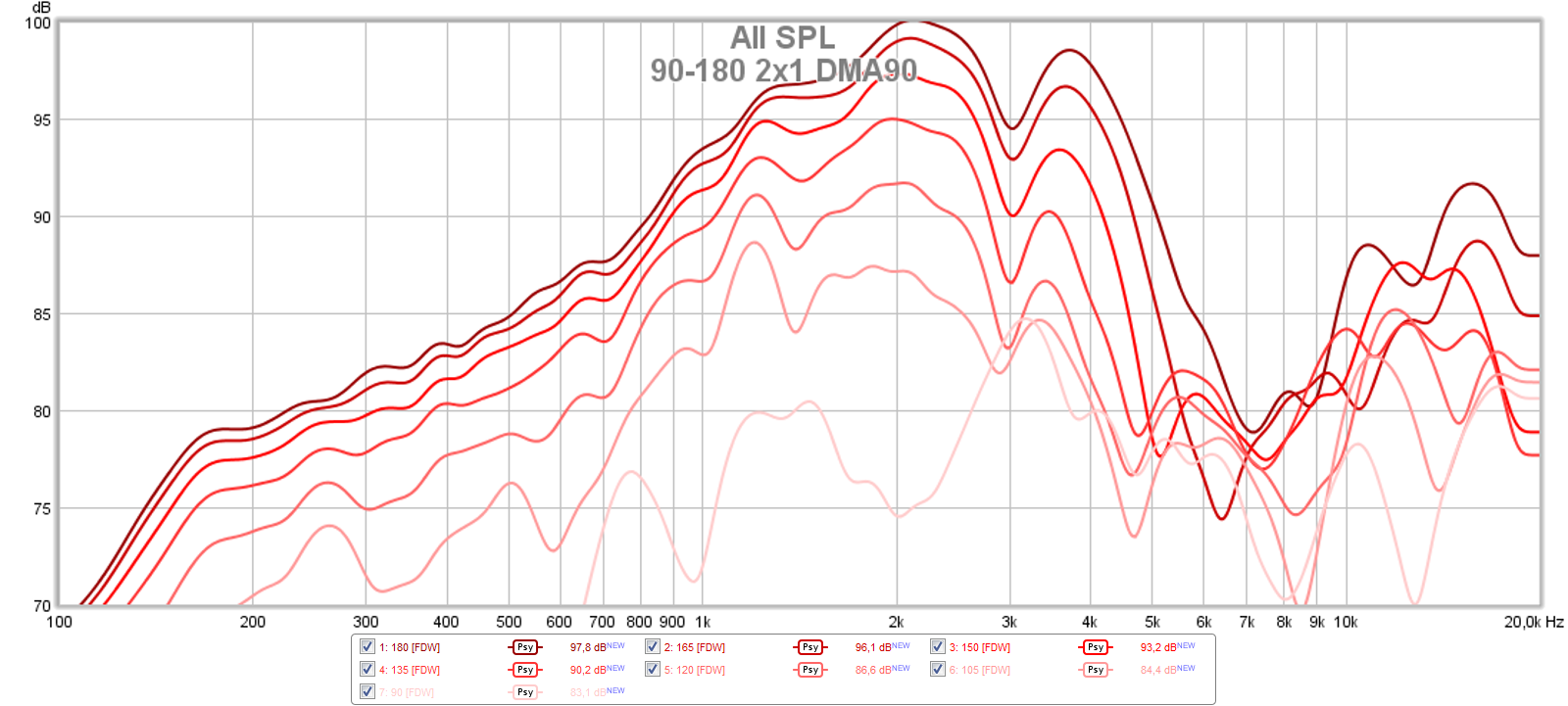

As an example of what I am talking about, here is the rear output from a Dayton DMA90 as posted earlier in this thread. This is a driver that could be used to about 4.5k only from the rear (e.g. mounted face down in a cabinet) if you did not use a low-pass crossover on it.
806589d1578097915-wave-comparison-front-wave-90-180-2x1-dma90-png
The response is already dropping at 4-5k and maybe this can be used as part of the crossover. You would still want to attenuate the output above about 9k, maybe with a notch filter or if you will use DSP, a high order LP with a sharp corner.
Unfortunately there is the dip at 3k. It happens at the same frequency on all axes so it is a resonance. This hints at energy storage and ringing and 3k is where the ear is still relatively sensitive. It's up to you if you want to build that into your system or not.

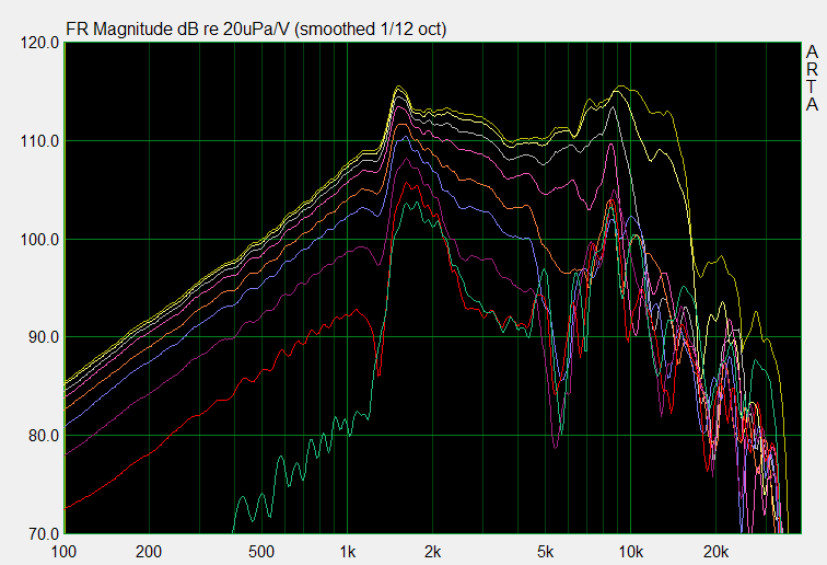

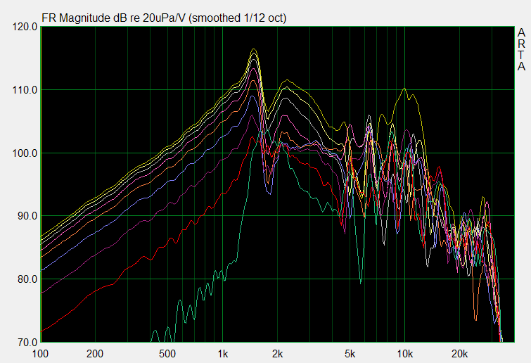

It seems that you cannot tell by looking at a driver whether it will have smooth rear output and at what frequencies there might be issues. For example, I bought a pair of SB Acoustics MR13P-4. Take a look at this driver (below) - it has what looks to be a very aerodynamic motor and open basket. I thought that it would "play nice" as a dipole. But when I measured it I was clear that this would not work well from the rear and would not be easy to use as a dipole (see attached measurements). The rear response has the sharp dip at about 1.8k Hz.
This is a very nice driver, but I wouldn't use it "nude" in a dipole system because of the issues with its response, both to the front and rear. Those sharp features are really problematic...
Also, I should mention that it is very important to take high resolution measurements to spot narrow features. These measurements were taken outdoors with the driver hanging in free space and probably have a 20Hz resolution. When I started measuring in this way, I found all sorts of things that I had not seen before at lower resolution and it really helped to separate the winners from the not-so-greats.

@CharlieLaub
Ahh I see, well this doesn't predict much good for the tangband then (per the graphs I poster earlier). It seems the back wave stores energy at 5k and to a lesser extent also at 3k. Furthermore, it looks like the graphs are in agreement with what you were saying: all good up to 2k, then some bothersome interferences of sorts
This helped me interpret the graphs, thank you 🙂

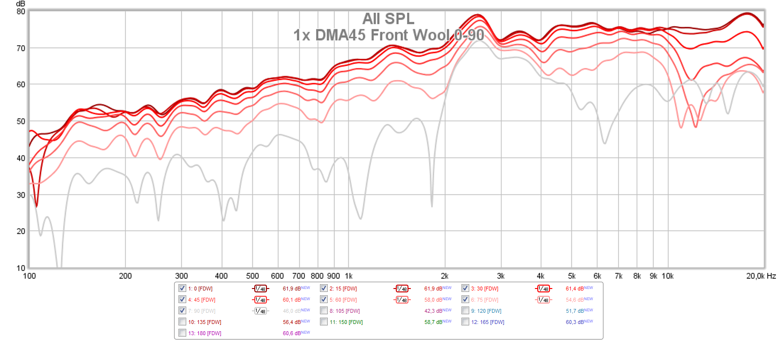

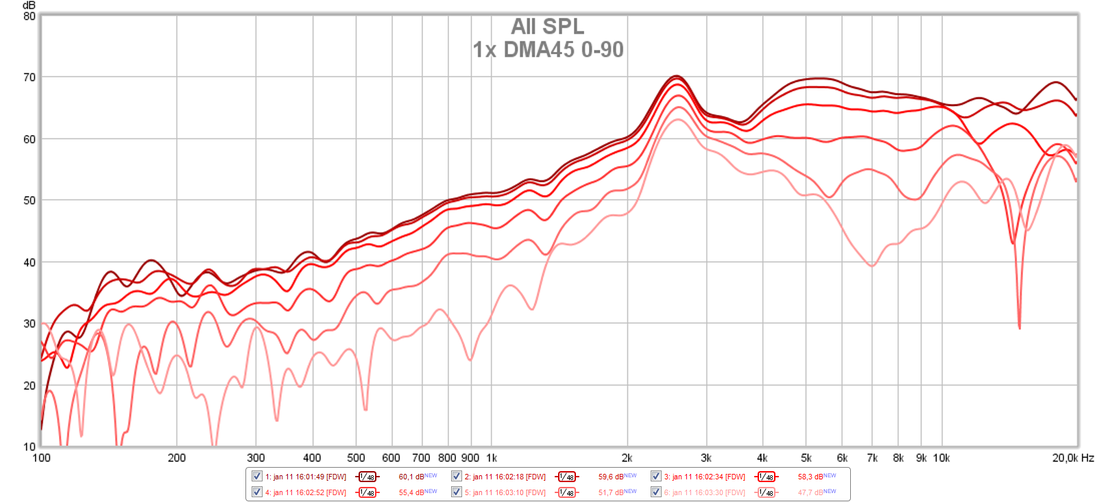

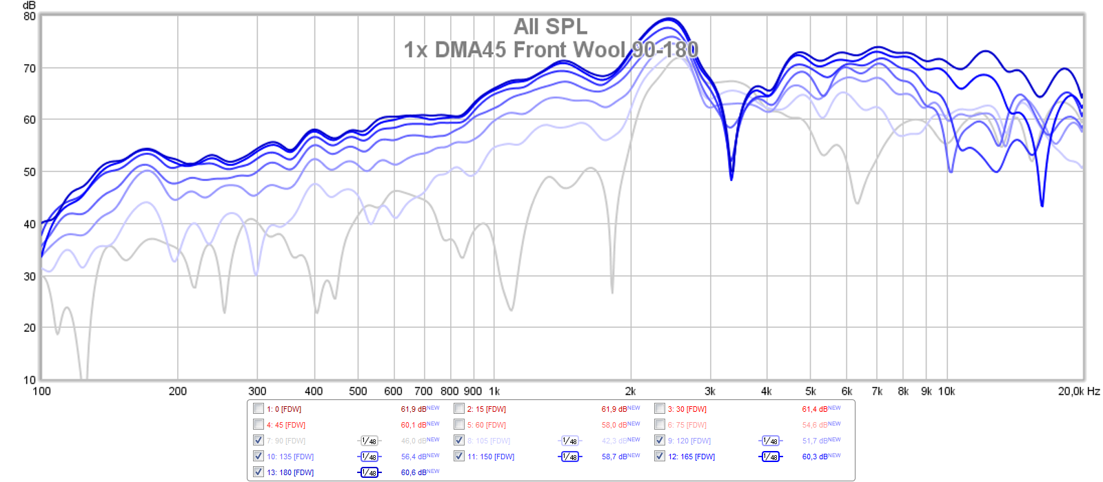

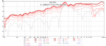

Alright, I have now measured the DMA45 to see if the niceness of the DMA90 is kept but up to an octave higher.
As far as I can see the answer is no. It is good though, if the 2-4 khz off axis bump could be handled but it is not as turnkey as the DMA90.
The last measurement is the driver naked without any wool, pretty much the same but sharper peaks.
