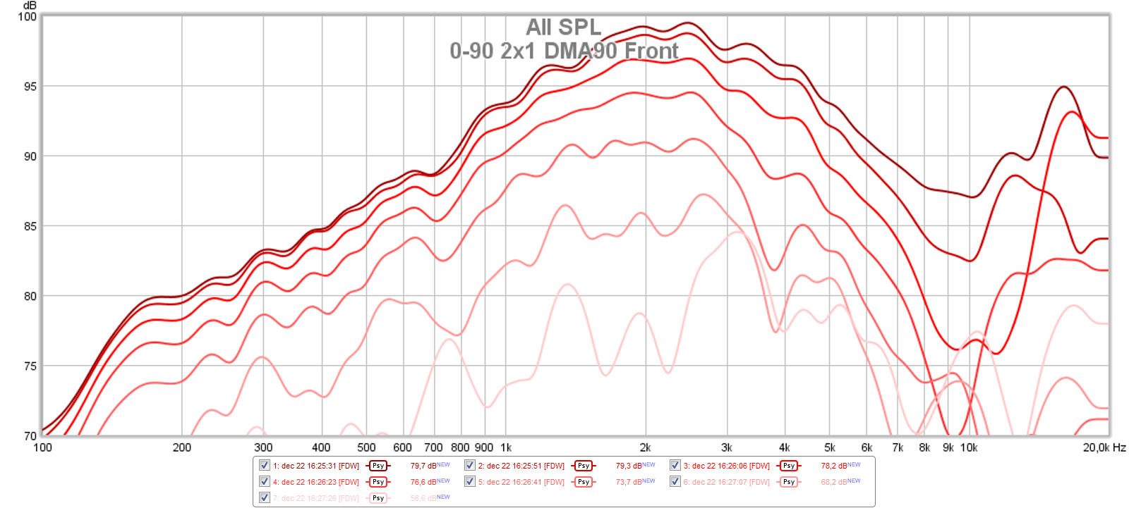

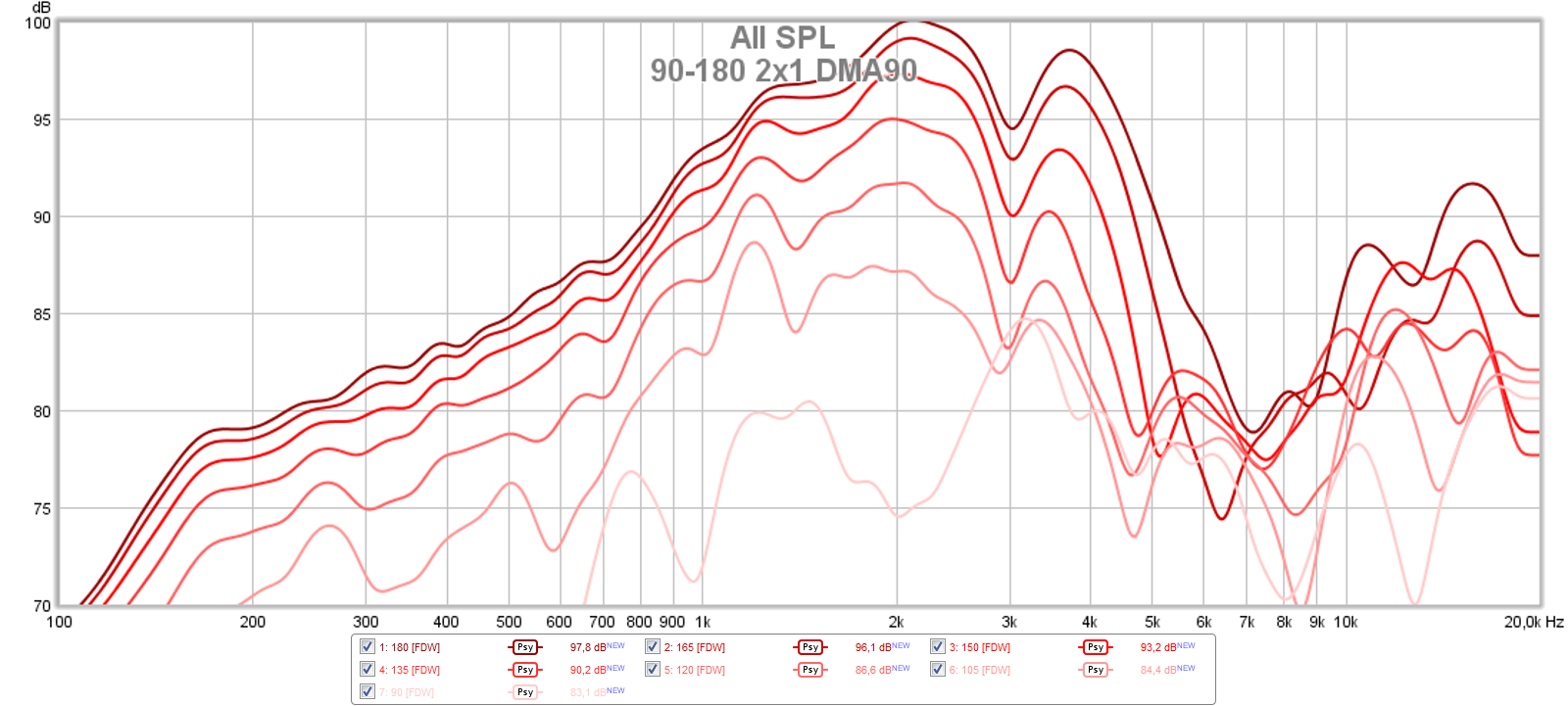

Here are measurements of the 3.5" Dayton DMA90 (which is a fantastic driver by the way).
It has an extremely open back so performes really well as a dipole and is quite small but as you see the rear response is nowhere close to the front response.
Most drivers are way worse though, only open drivers with small magnets perform this well. A normal driver with a big ferrite magnet will have a high Q peak right before the drop and not be as smooth.

This looks pretty good for a cone type driver and would make a great "fill" driver in the 700-2k range, or over a slightly wider range. The only issue seems to be a resonance or something around 1.2k on the back side only, but it's not all that severe.
In nude dipoles I find that it's critical to identify a driver that can cover this mid-band (up to about 2k Hz). A woofer that can reach to 100Hz and below is going to have some issues by 800Hz or so, and a dipole tweeter typically cannot be operated below 2kHz. This gives rise to the mid-gap that requires the "right" driver to stay dipole in this range. At only $15 the DMA90 seems to be a great and economical choice. I will have to get a pair and give them a try.

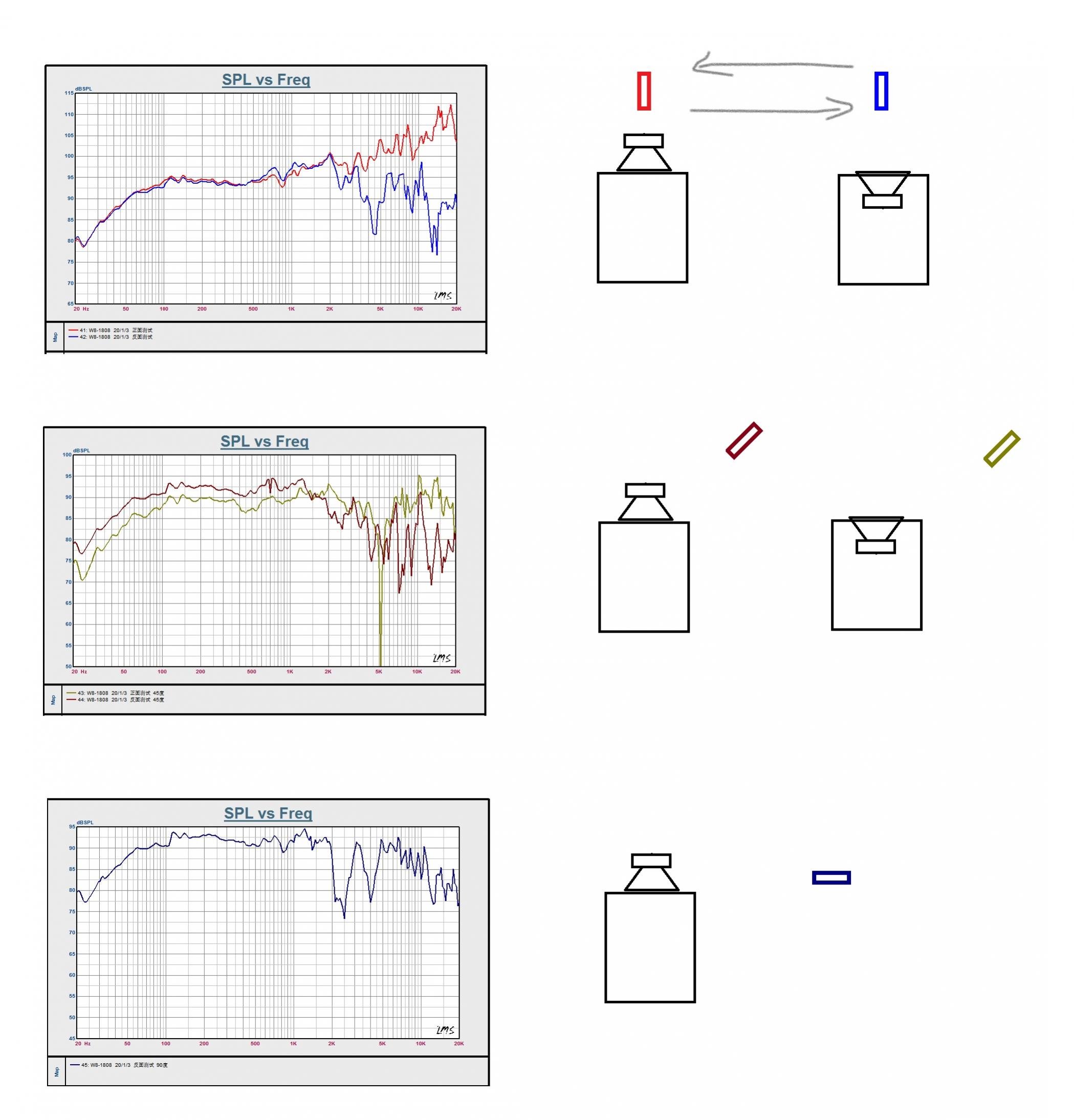

Let's have a look. To me, on first sight this actually looks really good and perhaps even promising??
As someone who has never had a DIY-audio teacher and who had to figure out all the physics and mechanics behind speakers for himself, I find it a little hard to draw conclusions from these graphs. Can someone help me interpret these graphs?
My first thoughts would be:
Graph 1: The dip at 4.5k, is that breakup? or rather a product of the driver's directionality in combination with the exact placement of the listener (the mic)?
Graph 2: Above 4k or so, the graph starts spiking like crazy. Could I still expect the driver to sound good in the higher regions, or would this imply nasty cone breakup stuff that I don't know much about yet?
Graph 3: 2.5k and 4k, again, normal dips or nasty bad-sounding cone breakup?

Well, well, well. Super nice of them to do that, you caught someone's curiosity.
I see they got the on axis swapped buy fixed it with the arrows.
The second row at 45 degrees is where you'd likely be listening. But even 9- degrees off is surprising. I'm surprised at the amount of high end still coming off the back of the driver.

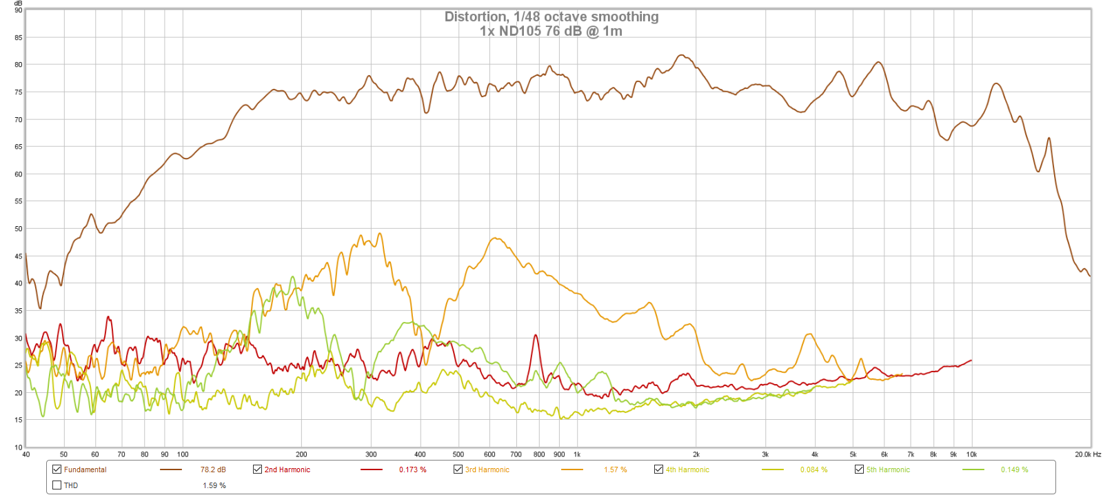

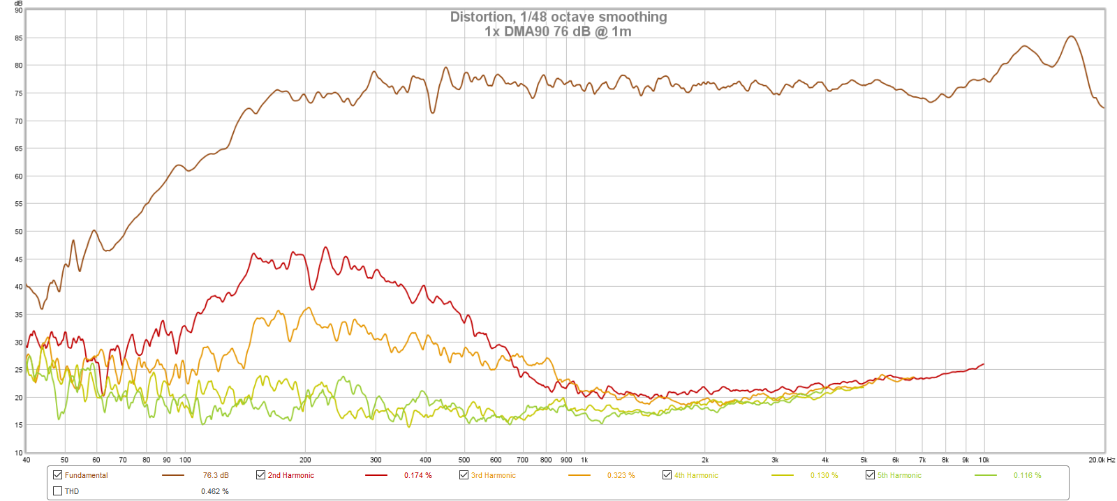

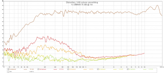

Of course I measured distortion =)
The drivers were measured naked and suspended at 50 cm distance. They have moderate EQ applied such that the response targets a flat response with 140 hz 24 dB highpass. They are both given the same signal except that the ND105 has the LR2 highpass shifted from 140 hz to 155 hz as it had a bit more efficiency on the lowest end.
But look at how smooth the DMA90 measures over the whole range! The ND105 has lots of peaks and dips and while it technically has more xmax it isn't as clean, look at those ugly odd order distortion peaks. Unless you have an array of them you probably want to cross them higher thogh to avoid that distortion bump. My current plan is a line of ~ 16 of them where every other driver is inverted to null some of that 2nd order distortion on the low end.
