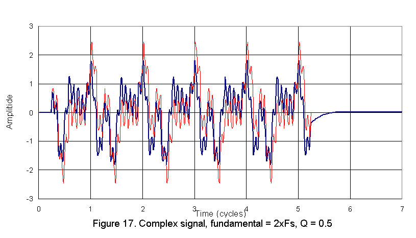

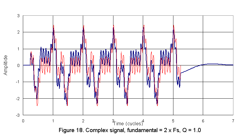

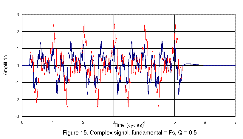

Can't say as I'm sure about how to think about Q, but I would point out that the perfect driver has no Q, so to say. Any "amount" of Q means the driver has a "voice" or sound characteristic and we want to strive for no voice at all in reproducing signals. Isn't that obvious?
And on the other hand, Q arises from features of driver design/manufacture. Some classical woofers that seem good to me have light cones and large magnets and maybe the Q is high. Mounting a driver (enclosed or not) means working with the selected driver's Q or choosing a Q that seems more harmonious with the intended mounting.
In that sense, there's no "correct" Q, just a correct tendency-of-Q. For sure, total nonsense to think there's some auditory correctness to a Q=1, which only has computational simplicity and not audiophile benefits.
Q is just a factor for a 2nd order system, HP, L, or a 2nd order parametric Eq, for example. A 4th order system can be factored in to two 2nd order systems, each with its own Q, and similarly for other orders. A perfect driver with no Q would necessarily be flat from DC to infinity with no resonances. But a sufficiently wide band pass response will have a region with flat amplitude and close to zero phase.
And don't forget, your CD or digital audio player, phono preamp, preamp, power amp, recording mic, and all other recording equipment have there own bandwidth limitations thus imposing phase shifts on the recorded signal that weren't present in the original acoustic event. That's why all this is fun to talk about but in reality it doesn't mean a hill of beans because no matter what the speaker does, it's just another component which imposes its signature on the original music. The input signal is effed up to start with.
