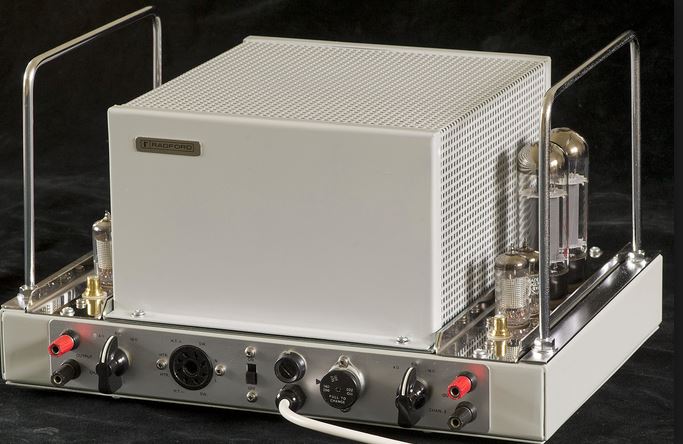

Amp was a Radford Valve Amp:

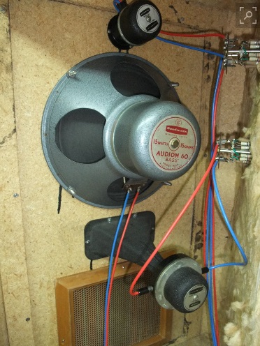

Speakers were some huge, maybe 6 cubic foot 12" plus 3" Goodmans closed boxes built into the library walls of a big, well carpeted room. This sort of thing.
I tell you, you thought you were actually in the Concert Hall! That good.

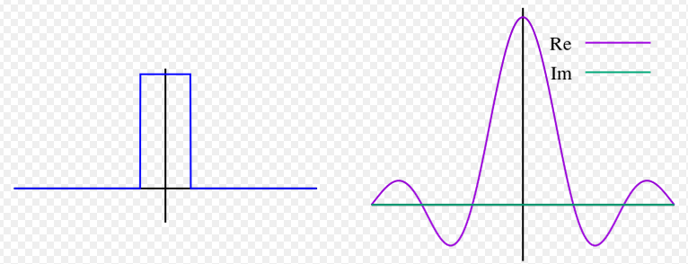

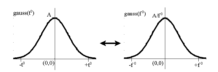

There is an interesting relationship that Radio and Antenna engineers are familiar with:
Smooth functions in frequency lead to smooth functions in the far field:
Brick-wall functions lead to horrible time delay:
What I am saying is Reflex is steep, Closed Box is shallow.
Further reading for the interested student:
Proves my point, I think.
I bet the reason said speaker sounded more realistic has little to do with it being a sealed box, and a LOT to do with it employing an old-school, dynamic 12" with a low resonance.
