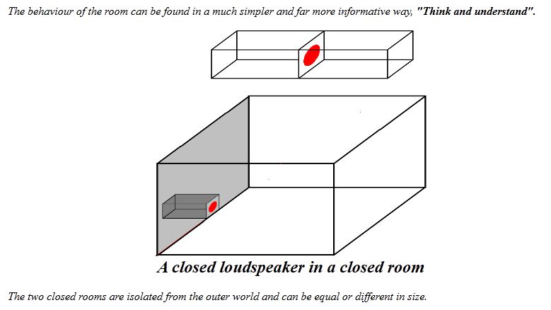

The listening room has orders of magnitude more influence, and that is what you actually hear.
Just look at the transient response of speakers vs the RT-60 times in a room.
0.5 sec at 50Hz is 25 full wave repetitions before the signal is 60dB below the original level. And that is exceptionally good for a listening room.
Iow: the Q of a speaker is meaningless.

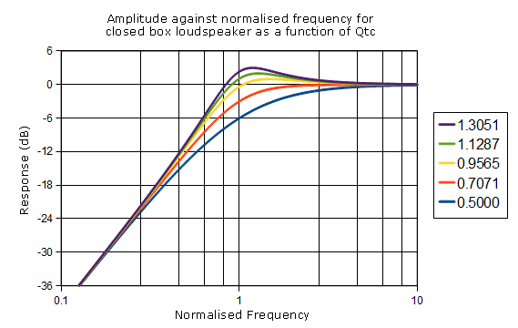

A good closed box driver has a Qts of 0.5. Put it in a cabinet, and the Qtc is higher. A reflex driver has a bigger magnet and a Qts near 0.38. In each case the optimum box is the Vas volume.

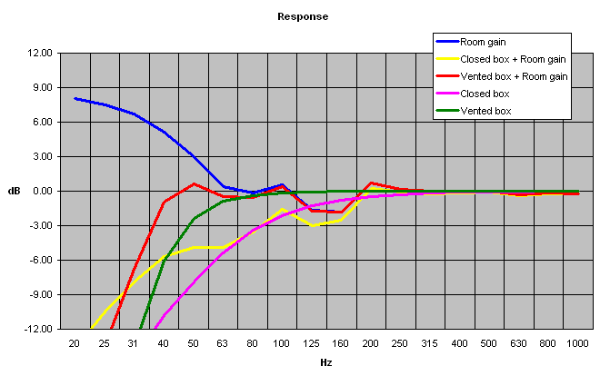

Now put it in a room, and things get more complicated. Room gain affects the overall result as Bill Coltrane says.
A big reflex in a small room sounds overwhelming.

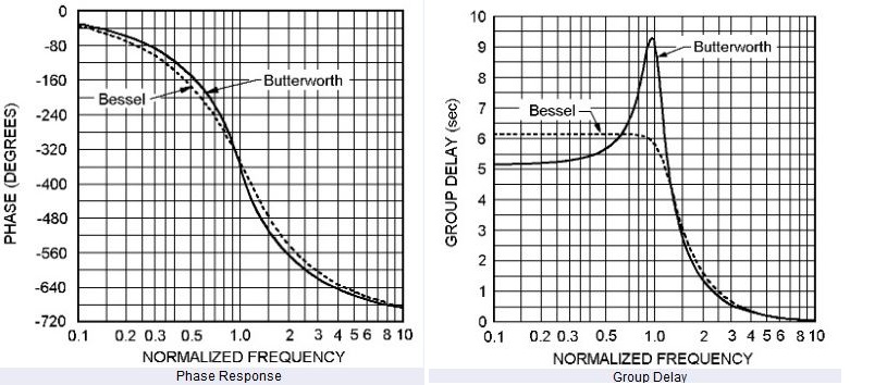

Steeper filters have more group delay, so 24dB/octave reflex is slower than 12dB/octave closed box. Overdamped closed box where Qtc gets near 0.5 is best on transients, but worse on power handling:

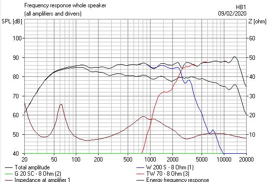

Most speakers look like this when you look overall:
You are seeing bass rolloff at the low end and bafflestep sloping there.
The Hilbert transform relates slopes, phase and group delay as differential coefficients. This is pure maths:
Our hearing is very good at differentiating between direct sound and late reflections and room reverbaration. I have no problem differentiating between a clean dynamic drum sound and an overly compressed and lowpassed drumsound with a very dull sound and lack of transient attack in a normal living room, despite room reverberations and echoes.

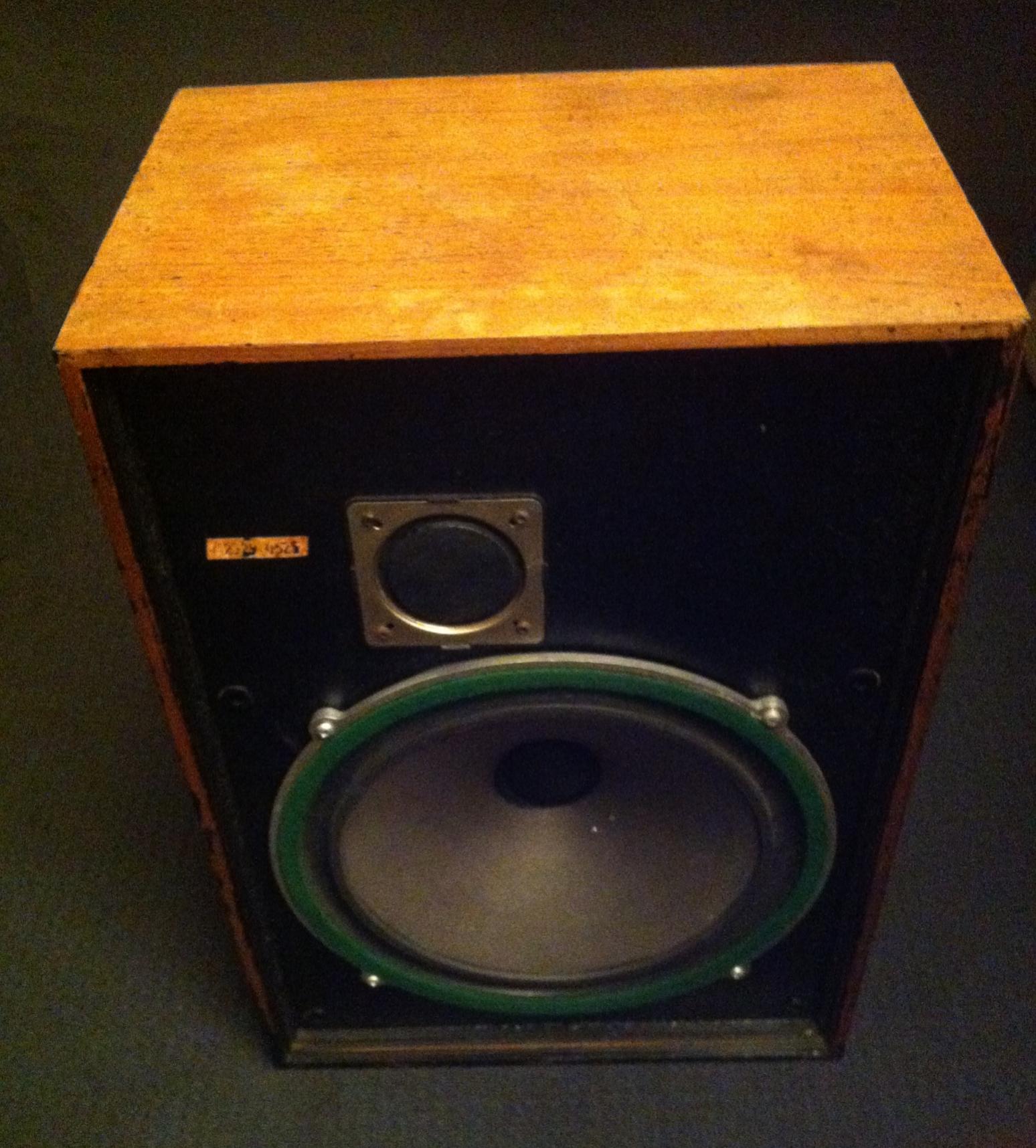

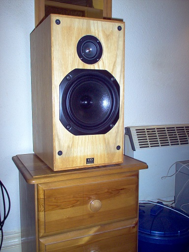

Here's an old closed box speaker, the 12" plus 2" Wharfedale Melton 2, which I used to own:
Everybody liked that speaker, despite some engineering difficulties getting a tweeter that could keep up with the bass. Great timing! 😎
