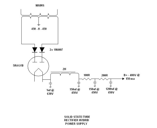

What I could do is put two 1N4007 diodes upside the heater plates like attached. This is essentially a SS rectifier with the 6X5 tube rectifier acting as a soft start...could this get rid of the hum? I could just detach from the plates all together...I now have the hole in my chassis...

I said the rectifier "may" be part of the problem. I just don't know, as I haven't used the same winding for both. But thinking about it, I see no reason it "should" be a problem. Is it really certain that the heater supply is the problem? Is the hum 60Hz? Checked with a scope? Tried lifting the heater supply? Maybe strap up 4 D cells for a quick check, before you do too much work.

I have ungrounded the Heater supply, put in a .1uf cap to ground, directly to ground, and a pot to ground. When the filament Centertap is just connected to the IEC Ground it sounds the quietest, but still noticeable hum...
OK, tried the 4 D batteries...ad very little hum. SO I slapped together a standard rectifier circuit and it is now supplying 6VDC (a little starved) to all heaters. Very little and acceptable hum.
