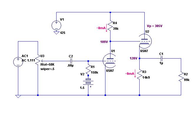

I wanted to go with a basic Grounded Cathode stage directly coupled to a cathode follower. I felt that "balancing" the two stages current draw would be appropriate so that is where the OP's came from. I experimented with battery bias on other projects and was pleased with it so decided to throw that in also.
attached is a draft of what I am thinking.(the 99K output resistor R2 approximates the load at the input of the Xover) Any suggestions as to bias setup? Battery at the grid is how I biased the other projects, using a battery at the cathode is another option how do I implement it? and does that eliminated the input coupling cap?, thus one more component out of the signal path?
I will "float" the heaters at some higher voltage (probably split the difference @ about 60V)
Should I "decouple" the two stages B+ with an RC?

That general style of circuitry is quite popular. All iterations of the Bottlehead "Foreplay" use it. With a digital signal source, you could easily run into excessive gain and a "hair trigger" volume control. In addition to SY's LED bias suggestion, think about making R1 a voltage divider and connecting the grid to the tap.
Getting rid of the I/P cap. is good, if and only if you can absolutely, positively, guarantee that a DC offset will never be present at the line stage's I/P. A Soviet surplus PIO part is my preference, for tonal and DC block reasons. YMMV.

As far as I can tell the FCA-202 has an output impedance of ~1K and has DC blocking caps, if I decide to add any other inputs or a phono preamp onto this chassis I would be sure that there would be NO DC present (add coupling caps at those inputs.
LED's are one possibility but I am leaning towards battery biasing at the cathode with a NiMH cell.
As far as the source is concerned the FCA202 has maximum of 2dBV (big V) so I see no issues with "overdriving" either stage since I rarely run the "volume knob" up past 10. I plan to use a linear rather than audio taper pot and might increase the value a bit.
As I said before a unity gain solid state Xover will actually sit at the outputs. This will have individual attentuators for the outputs.
This layout IMHO seems the simplest way to get some gain and present a low impedance source for the crossover. Besides the foreplay, VTV's preamp and many others used this configuration. I am simply combining all the things I have gathered over a couple of years and "cobbling" together a preamp. I am somewhat of an "Octal Maniac" hence the 6SN7's

Have a look at the anode follower. I'm using one in my 300B DeathTrap 500 amplifier. You could build one anode follower with one 6SN7... I use it as a driver for a 300B and it's the best sounding 6SN7 driver I've been able to come up with. It has reasonably low output impedance - you could make it even lower by using unity feedback around the second tube. That would give you a preamp with a gain of about 20 V/V...

Input cap gone, two red leds in the cathode for bias, and you're good to go.

Any suggestion as to what LED's to use? I know I should be looking at fairly "run of the mill" RED LED's but finding good Spice models and accurate data sheets for forward voltage at specific currents is almost impossible.
I really want to stick to about -1.5 to -1.7V about 8 mA.

So basically what I'm looking for is an "off the shelf" red LED with about 1.5 forward voltage @ 8mA
You'll be closer to 1.7V with a red LED. Which is fine, considering the tube tolerances involved. Best "new" LED I've found is the HLMP6000. And they're really cheap. Otherwise, old surplus units seem to work nearly as well- I bought a bag of 2000 red LEDs of unknown origin for $20 and they have a dynamic impedance under 5 ohms, compared to about 2-3 ohms for the HLMP6000.
