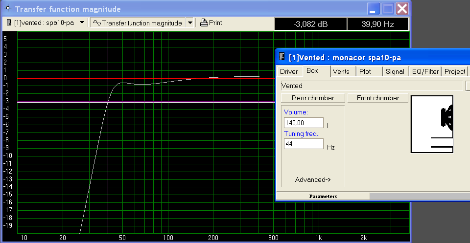

Easy way is to use two 12" woofers BR with a 1" horn tweeter 1kHz up. Or a 1,4" of fatial pro 600Hz up. Then you have about 98-100dB 1wmtr and cut off at 40Hz.I am guessing not which would be fine. Sometimes I crank the volume to hear my speakers outside and thats how I damaged my budget SLA's. They stil sound fine at low volumes but when the voule is turned up you can here the damaged tweeters.

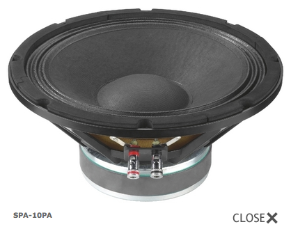

Like this 2X spa10pa (80euro) 140liter BR and Faital PRO HF144 1,4" and horn Faital PRO LTH142 Horn 1,4" 60° x 50°. Or a nice one from jmmc.

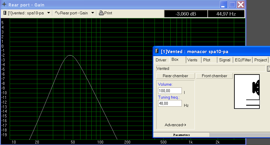

Does the response ( linked to by Helmuth above ) in post 75 of this threasd include the port response. It is often quite easy to get a good looking response until the port combined response is factored in.
Look a bit closer it is combined response -60cm.

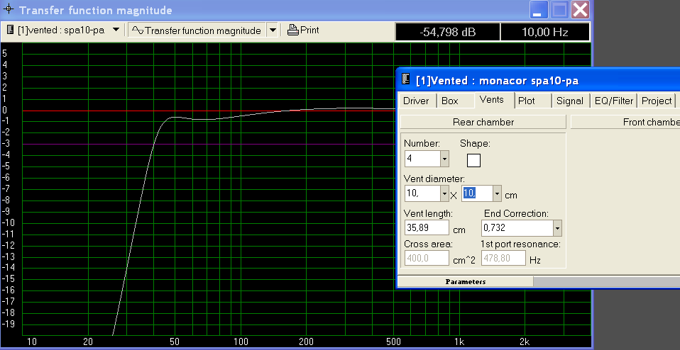

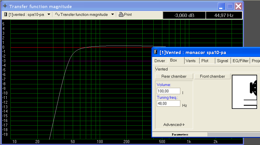

My simulation of the spa10pa isn't right to big volume. This one is better and smaller isn't that great.
Will be great project because of low cost and high value. two woofers 82euro 1,4" driver 171euro and horn 45euro. Total 298 euro one speaker! That probably 1/5 of the price of a comparable system.

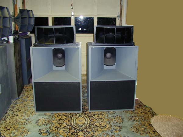

Here another example classic altec A7. Horn loaded BR.
