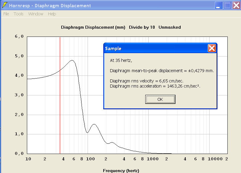

For example when listening at louder level as high as 90dB 1meter we have a extrusion of 0,42mm. For higher frequencies the extrusion will decrease rapidly. For example at 65Hz the extrusion at 90dB is 0,0733mm.

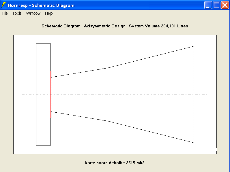

I do have the MiniDSP, so I can give this a try. But first I will have to build the front horns. My friend John who is here on diyaudio has designed a front horn for me with a -3db at 72 Hz. It is with the Eminance Deltalite 2515 driver.

Yes, it is a sealed enclose with a front horn. The efficiency from 72 to 500 Hz is 110db/W and it is ruler flat in that region (Hornresp).
I need to build it first though. It will be my first front horn ever, so it's going to take a while.
John suggests going for a folded bass horn for subbass duty, but there is no space in the current living room... maybe one for the future.

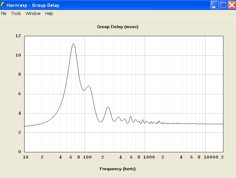

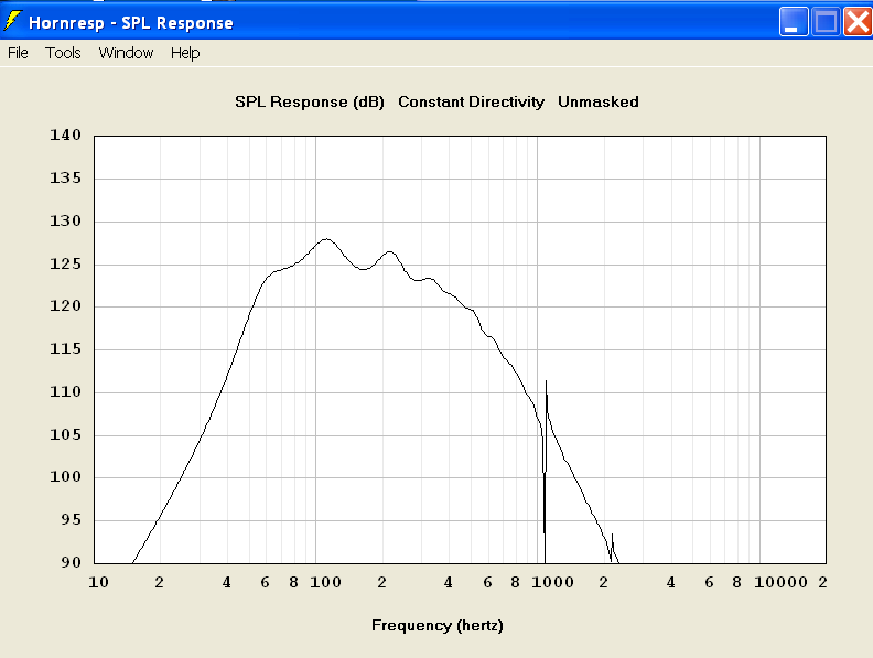

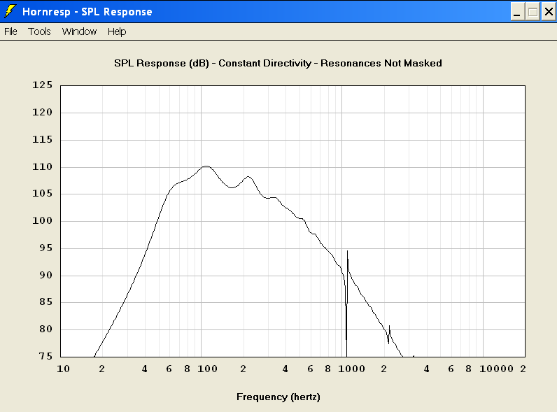

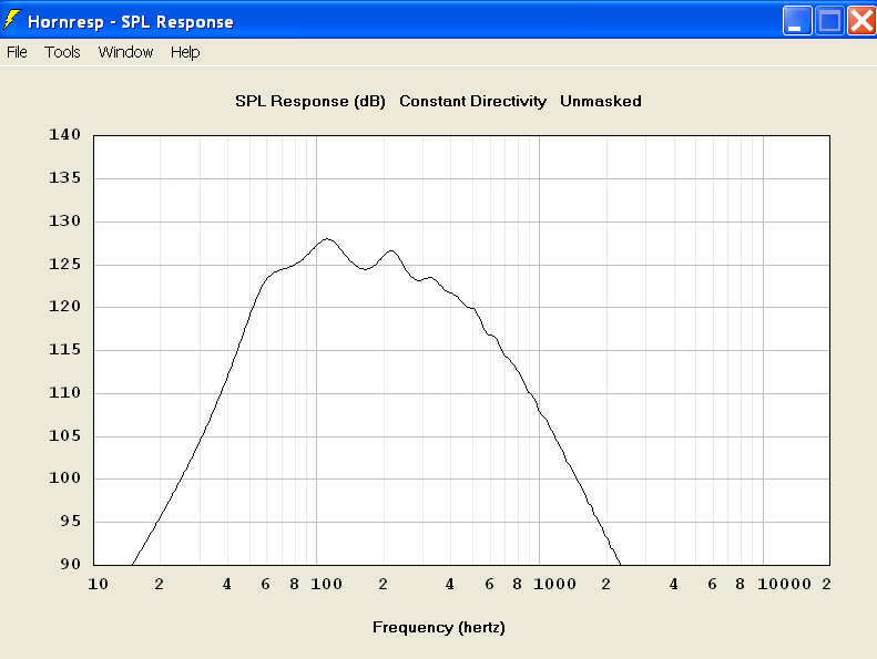

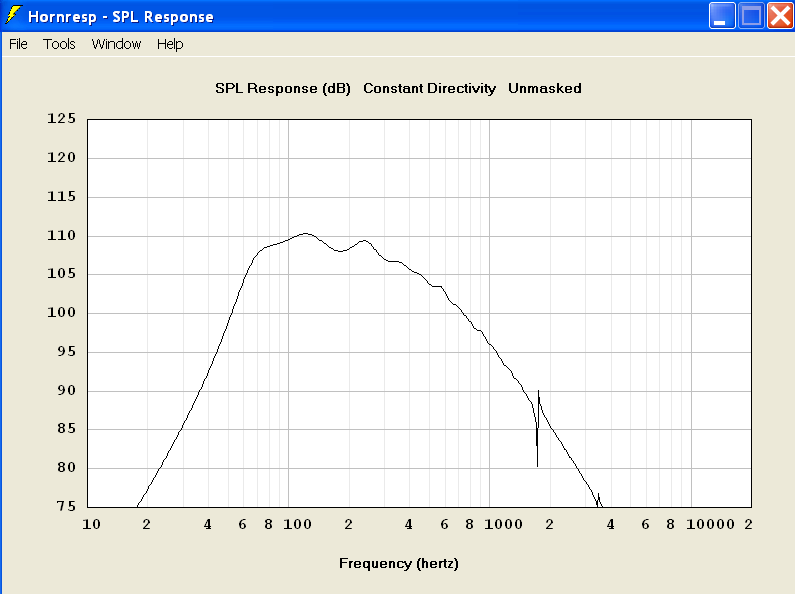

I did place the deltalite in my 1 meter horn almost the same result as the 18sound -3dB at 66Hz 1phi. At 0,5 phi -3dB at 60Hz. Group delay of the 18 sound is better.
The delta-lite has a sharp price tag dough.

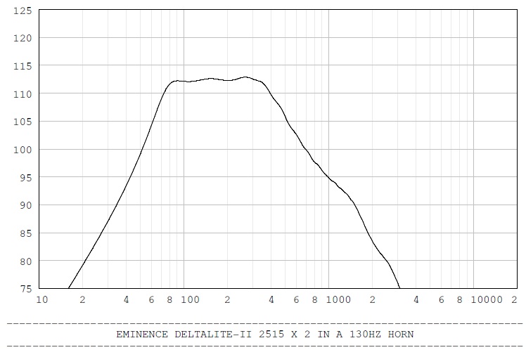

Here's the simulated response of the Eminence Deltalite 2515 in a front horn.
Don't ask me anything about the simulation. I did not do it, but I can get John
to perhaps comment here.
Nice roll off beyond 400 Hz. Exactly what Lynn wanted I think. John tells me
that the little throat before the expansion is key.

Looks ver nice flat ra7 (depending on if it is 0,5-1-2phi) he did place a volume for the cone to design the roll off. And yes the throat that is one of the key variables to play with reducing the throat gives a more linieair acoustic resistance but a small throat limits the low end.
But why would one want to have that when a filter is used then in fact it is more a disadvantage for linearity.
I reduce that effect to the minimum to have extended response.

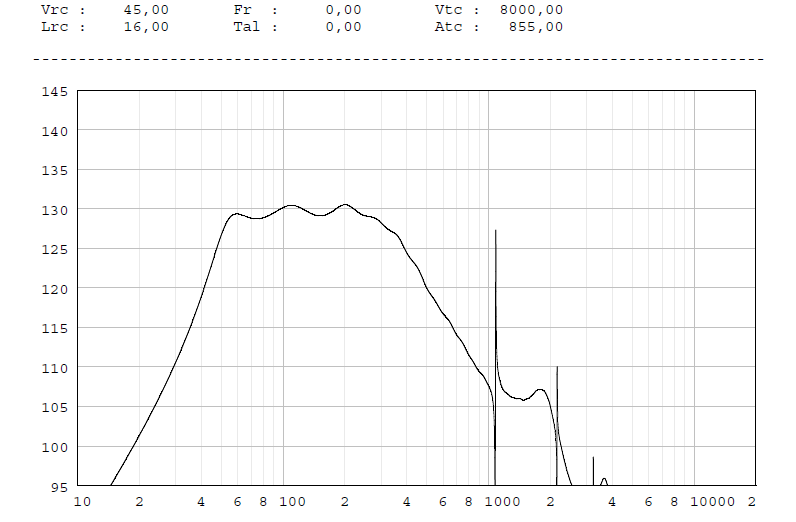

Here I did the same with my latest find this one does 50Hz-450Hz 1meter la scala horn and i added a front chamber to get the roll off. 0,5 phi

Like with the previous post with the front chamber (Vtc in hornresp) you could even play with the steepness of the response.
The extended response is with front chamber the falling response is the same horn with no front chamber.

Could you post a picture of the input screen?
Frode
input screen of the monacor spa15pa. The peeks at the 1kHz area can be reduced by reducing Lrc (the maximum length in the sealed enclosure) see result c.
