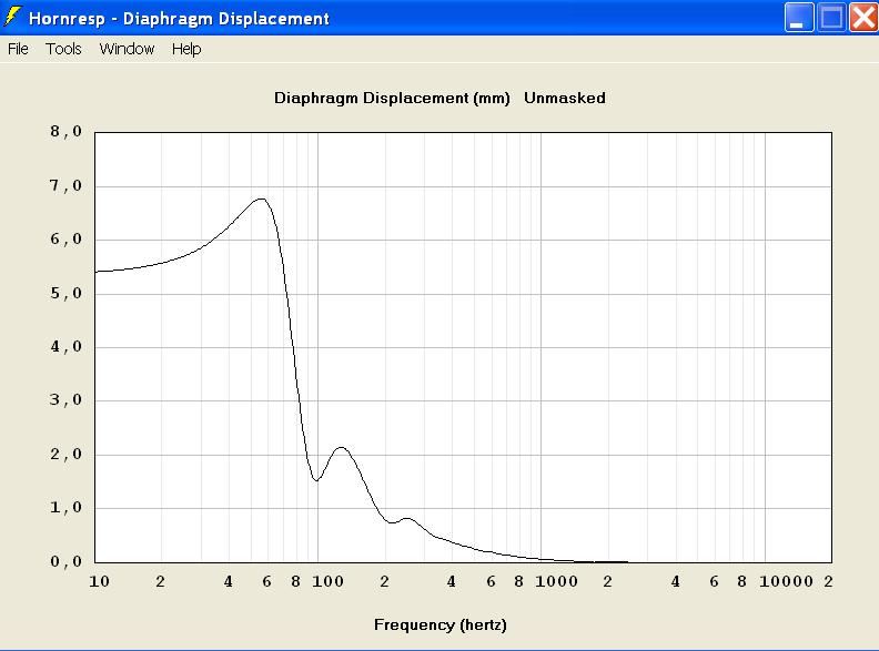

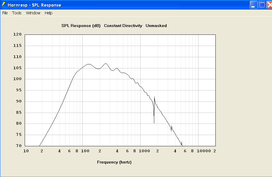

The horn construction as above has also horn loading below 60 hz but it is decreasing fast. It would bee a good solution to build it the dimension like I did post with the simulation and let it below 60Hz work like a close box and compensate the low active because the dynamic range of the use LF-driver is huge. Connect a DSP for your tube amp.
I make a simulation the driver will reach X-max (6,5mm) at 200W = 40V. It means 110dB at 30Hz enough to blow the living room and with 30Hz as -3dB the mean level can be 113dB at 1 meter.
So I advise this sub active compensation dow to 30Hz. Advantage You can compensate the delay with the Dsp and have the huge sound of the bas mid horn of 1 meter and XO at 550Hz 48dB/oct. with this nice 2" driver of also 18sound.

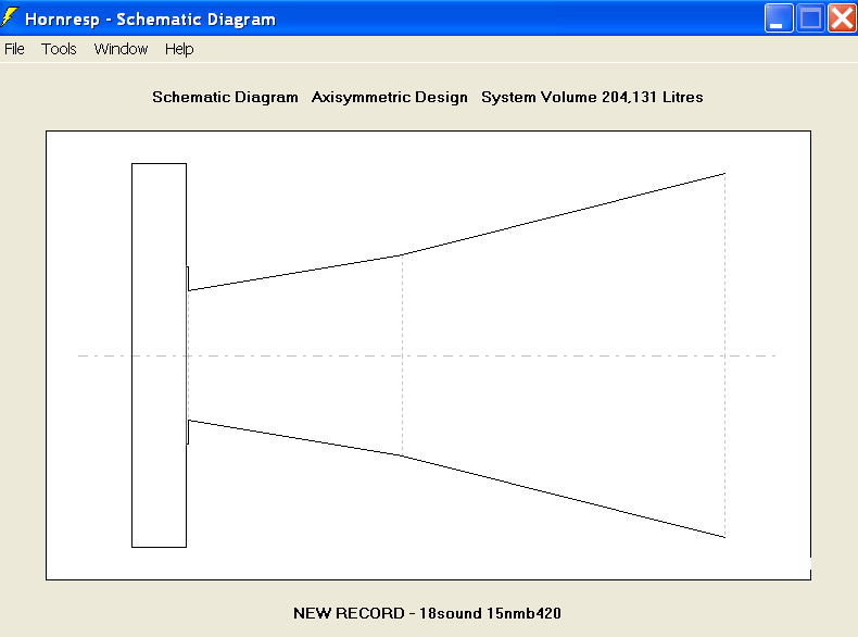

This horn folded like the klipsch la scala. A cube of (60cm X 60cm X 60cm) is enough. Big size but it is low 60cm it is the size of furnature.
With a nice 45cm wide mid/high horn and 28cm high we would have 90cm perfect ear height.

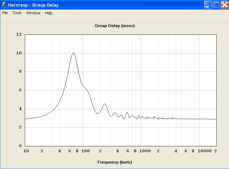

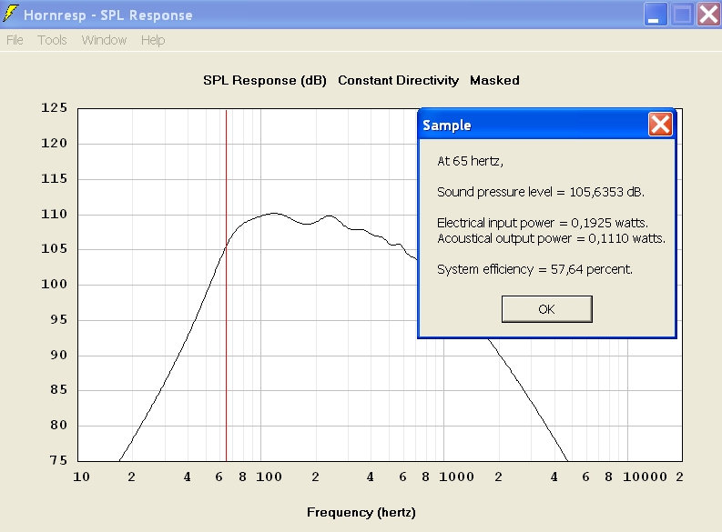

To see how much active correction we need to get subbas out of the horn. The woofer is placed in a sealed enclosure and the horn enclosure also helps because it is radiating 2-1phi.
At 1W we have 35Hz 90dB 1meter, and then the fact we use a 15" woofer with a xmax of 6,5mm of 420Watt we can use this room to correct the low end active and maintaining the nicer group delay of the short horn and the less coloration due the short horn.
We see 105,6dB 65Hz and 89.6dB at 35 Hz we are talking 16dB decrement of spl from 65-35Hz. Depending on amplifier power available we can stretch the low end I would say flat to 35Hz is good enough.
16dB correction at 35Hz = 40W even for a tube amp a reasonable value. Because then we have 105dB 35Hz.
