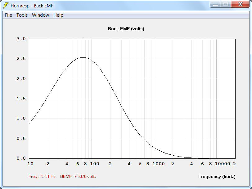

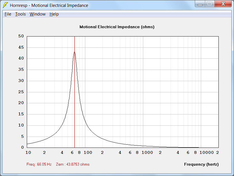

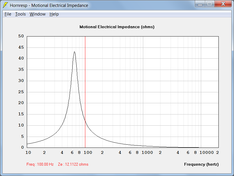

Back EMF and motional impedance are two sides of the same coin
Back EMF is measured in volts and varies with Eg.
Motional electrical impedance is measured in ohms and is independent of Eg.
The attached charts show the theoretical Back EMF (at Eg = 2.83 volts) and motional electrical impedance, for an Eighteen Sound 10W400 driver mounted in an infinite baffle.
The obverse and reverse sides of the coin look pretty different to me.
So your pedantry is wasted, and you forgot a minus sign....
You will find that "Back EMF" is positive by definition. The negative sign is only required if "Back" is omitted, as in EMF = -10 volts.
I forgot nothing.

Back EMF is measured in volts and varies with Eg. Motional electrical impedance is measured in ohms and is independent of Eg.
It is precisely because Back EMF is proportional to input that motional impedance doesn't change with input. I can run sims in "software I wrote" that prove my point as well, but I'll spare you. Believe me David, I know what you have produced and you don't have to get ridiculously puffed up about a perceived slight.
Motional impedance is the result of Back EMF. True that motional impedance is not an EMF, but anyone but a pedant can forgive a little sloppy language when dealing with hobbyists.
Motional electrical impedance = Back EMF / Voice-coil current

Subtract the back EMF from the input voltage, then calculate current. Calculate impedance that would cause that current given the input voltage - Hey what do you know, you have calculated the motional impedance knowing nothing but the Back EMF and the input voltage!
The result calculated using the above method is not even close. For the example checked:
Correct motional electrical impedance = 12.1122 ohms
Result calculated using the above method = 107.3608 ohms

How does one measure the volts of it? Is it by looking at the change in the impedance curve and calculating the difference in volts from that?
Hi shredhead,
As pointed out in Post #49, the diaphragm displacement method requires specialised equipment to obtain accurate results, with either an accelerometer or a laser normally being used.
Also as pointed out in Post #47, Back EMF can alternatively be determined by measuring electrical impedance. The advantage of the impedance approach is that less specialised test equipment is required. Unfortunately the calculations become more onerous.

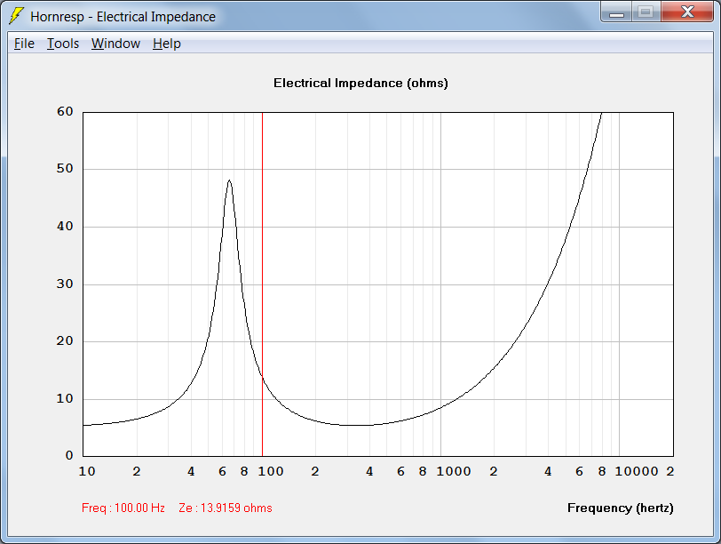

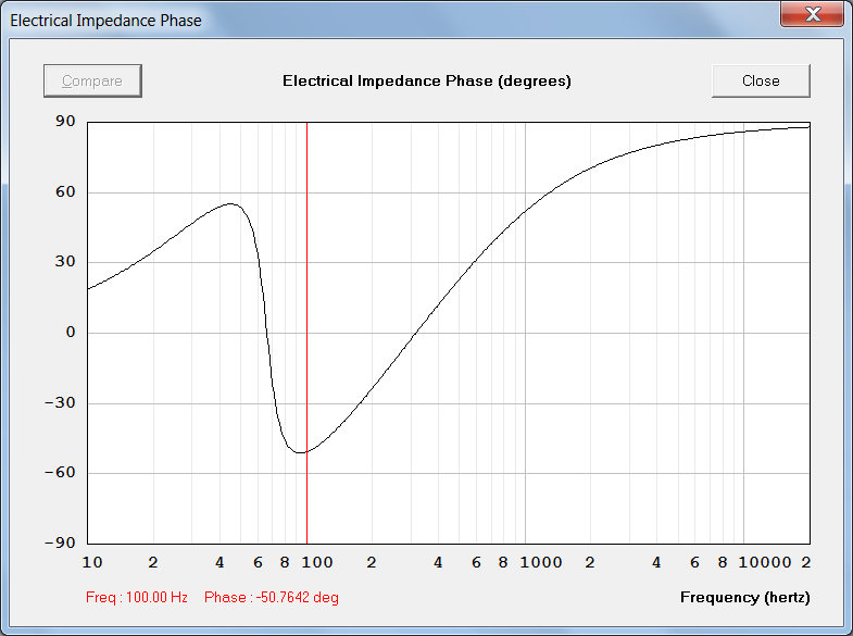

The impedance method requires the following inputs, at a given frequency:
1. Rms voltage applied to the driver voice coil.
2. Magnitude and phase of the normal electrical input impedance of the loudspeaker.
3. Magnitude and phase of the electrical impedance of the voice coil in the absence of motion, that is, when blocked.
Given:
f = Test frequency
Evc = Voltage applied to voice coil
Zen = Normal electrical impedance
Zed = Blocked electrical impedance
Zem = Motional electrical impedance
BEMF = Back EMF in rms volts
Then:
Zem = Zen - Zed
BEMF = Evc * Zem / Zen

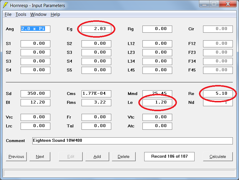

If the Re and Le values provided by the driver manufacturer are accurate, it is not necessary to measure the blocked electrical impedance.
Numerical example using Eighteen Sound 10W400 driver mounted in an infinite baffle:
Measurement frequency = 100 hertz
Measured Evc at 100 hz = 2.83 volts rms
Measured normal electrical impedance magnitude at 100 hz = 13.9159 ohms
Measured normal electrical impedance phase at 100 hz = -50.7642 degrees
Assuming the Re and Le driver specs are accurate:
Re = 5.10 ohms
Le = 1.20 millihenrys

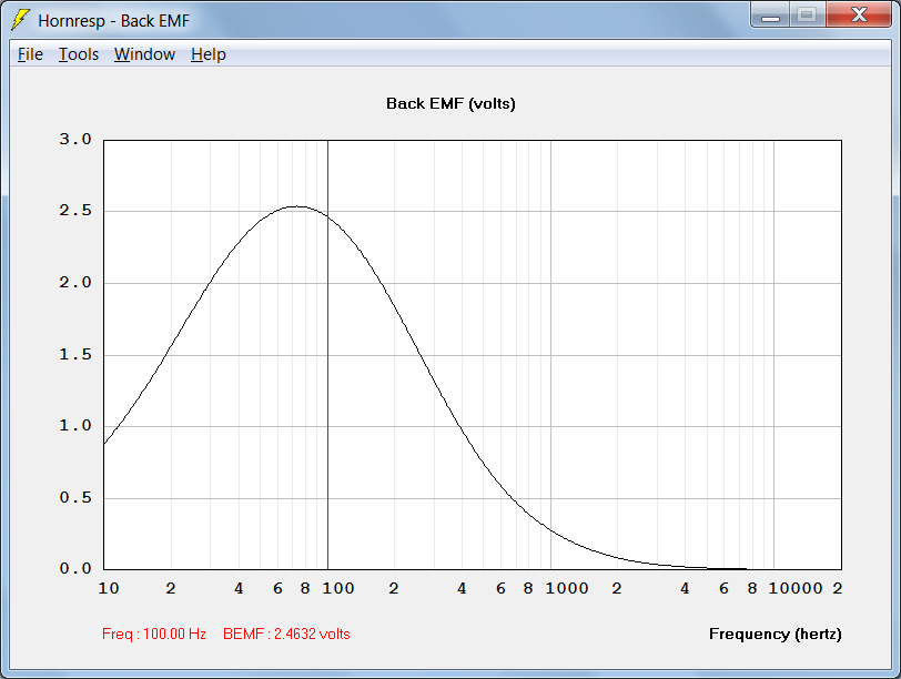

Number crunching with phase angle converted to radians:
Ren = 13.9159 * Cos(-50.7642 / 180 * Pi)
Xen = 13.9159 * Sin(-50.7642 / 180 * Pi)
Red = 5.10
Xed = 2 * Pi * 100 * 1.20 / 1000
Rem = Ren - Red
Xem = Xen - Xed
R1 = (Rem * Ren + Xem * Xen) / (Ren ^ 2 + Xen ^ 2)
X1 = (Xem * Ren - Rem * Xen) / (Ren ^ 2 + Xen ^ 2)
BEMF = 2.83 * Sqrt(R1 ^ 2 + X1 ^ 2)
BEMF = 2.4632 volts rms
You can now see why I chose the diaphragm displacement method originally, for my example :).
