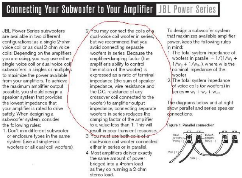

I am trying to measure the difference in wiring subs parallel/series vs. series/parallel. There are a few driver manufacturers who recommend against wiring the drivers in series and I would like to test what the difference is.
I understand I will have to test many frequencies in the sub bandwidth to compare the 2. I'm guessing to test current at different sine wave frequencies since the issue is with amp impedance?

If you have a dual voice coil woofer the usual recommendation is for parallel wiring mainly because you get a 6dB gain in output for the same voltage input. Which manufacturers are recommending against series wiring and in what application?
Since you are using DVC woofers, and apparently multiples, it makes me think Car audio or dB drag type application. You don't give enough info about your application, though, to give a good answer to your question. If you aren't pounding the crap out of the woofers, how you connect them will make little difference. If you are pushing the limits, it could make a difference.
Here is an attached snippet from JBL about it. Stereo Integrity and JL audio both make the same recommendation. I have heard this recommendation from many sources over the years.
Wouldn't it be 3dB difference unless you doubled the power to the drivers as well as going parallel?
