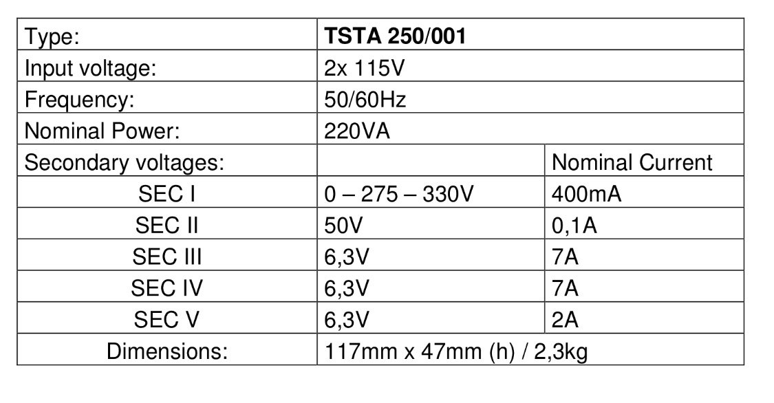

However in the case of the Toroidy transformer Model 250/001 it will cover all the possible power needs of this amp. Also, at $102 USD it looks like a good deal, even if shipping to USA was ~$50 or so.
However I’m not sure about the quality level. They seem to have a good reputation.
Here was my personal experience with acquiring this transformer from the USA: I bought the Toroidy Model 250/001 power transformer at TME online for under US$110, total, including shipping to my US address. The whole experience was excellent and very easy. I received the transformer, shipped via DHL Express, in just a few days (can’t remember exactly, but definitely less than a week). Currently TME ships packages under 5Kg for US$9.90 to the US using DHL.
TSTA 250/001 TOROIDY - Transformer: toroidal audio | 250VA; 115/115VAC; 275/330V; 50V; TSTA250/001 | TME - Electronic components
I have not used it yet, but based on general feedback on the quality of Toroidy transformers I believe it will live up to the specs, which are a good match for a EL34 BH in a one-transformer power supply solution.
(I noticed that at the moment TME has only 3 of these transformers in stock - grab ‘em while you can).
