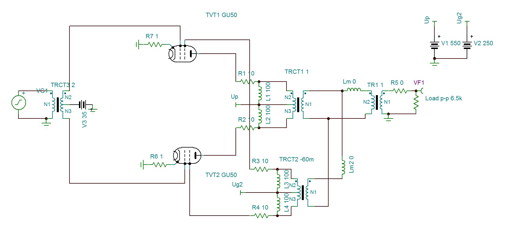

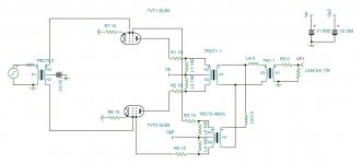

How long do you think the screens will survive that 😱By applying a positive feedback of 6% on g2 , it is possible to get 75w 2.5% Dtot. If 2 pairs of these low cost tubes (3 euro) is used, 100w 1% is at reach.
Mona
Mona
On simulator I get average screen current of 11.9 ma, for 75w output. This makes 11.9ma x250v =3W. With g3 14v , the screen current is lower.
Perhaps at 75W it's still acceptable.But when the anode goes realy low the screen current goes up dramatically especialy with the higher voltage caused by the pos fb.On simulator I get average screen current of 11.9 ma, for 75w output. This makes 11.9ma x250v =3W. With g3 14v , the screen current is lower.
Mona
I am not the one who is designing this amp. I just made a quick feasibility to see if 2 pairs of gu50 can provide 100w with low distortion.

By using a more precise model from Nakabashi Tube Models for TINA , I get 70W with 0.8% distortion Ig2=7.4ma average. The bias -35v for Ip46ma (too high) input +/-35vp. Of course it needs fine adjustments.
The model GU50 is not precise but the circuit is working.
Shokran kokoriantz, I see there's no g3 there, that from what I've seen is very important to optimize the curves. I will take a deeper look at it tomorrow.
