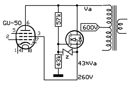

matejsirk has already done A BH with GU50 in pentode/cathode feedback in 2005.

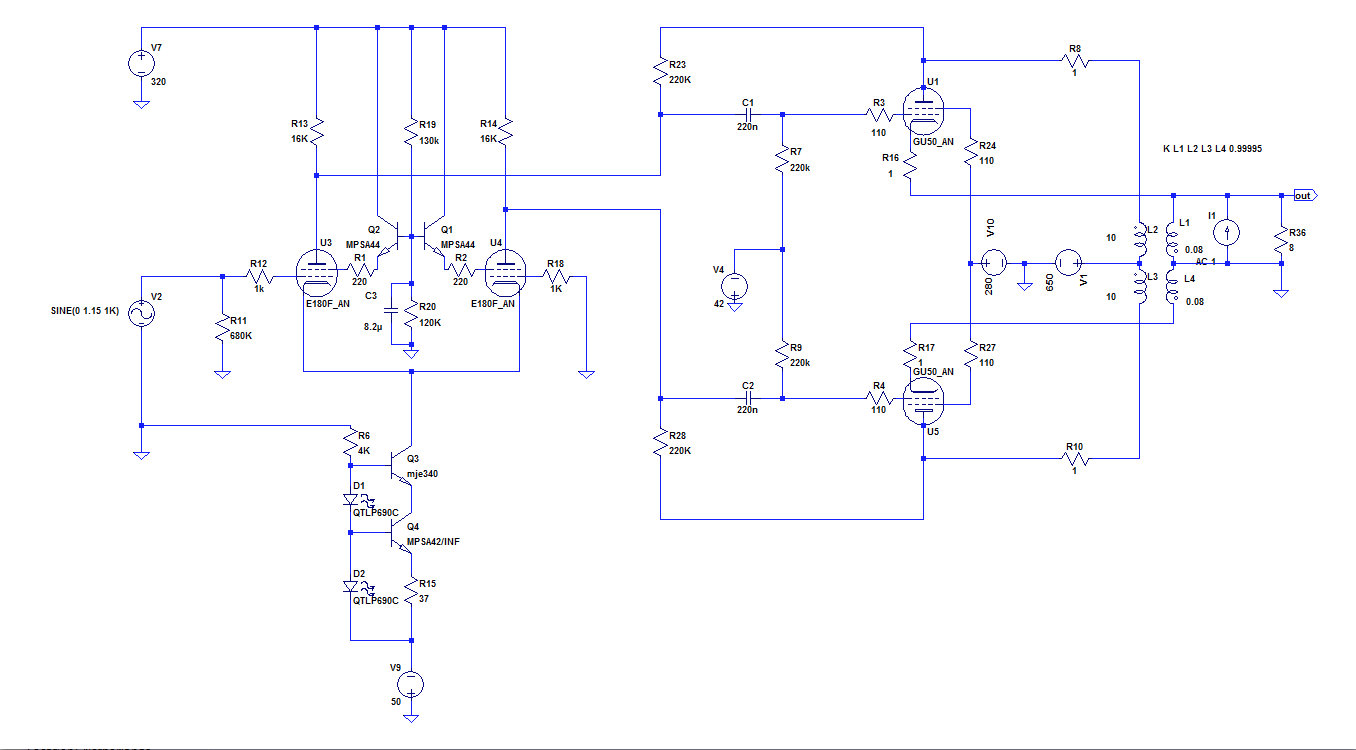

Thanks kokoriantz, this is the original post: GU-50 PP amp project - Any favs?
It was 2015 and he said that it may be one of his next projects, not done yet.
LTSpice simulations: Pmax 65W, THD less that 0.4%, Zout only 0.4 Ohm.
This is pentode PP with cathode feedback, 650V B+, 280V on g2, -42V on g1, shunt feedback on pentode drivers, strictly AB1 without mosfets to drive g1.

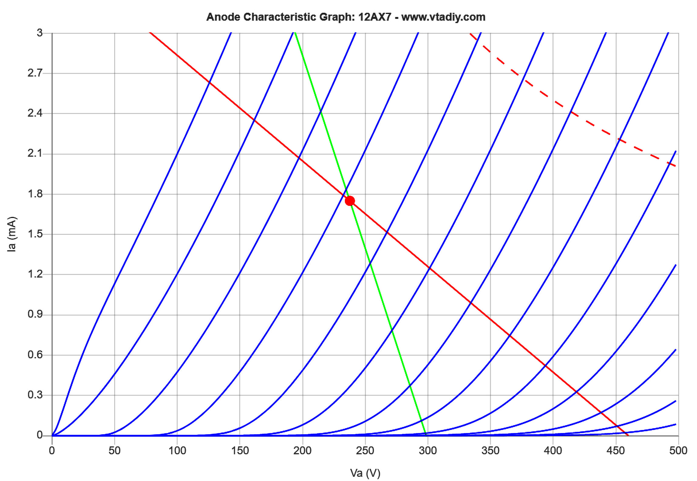

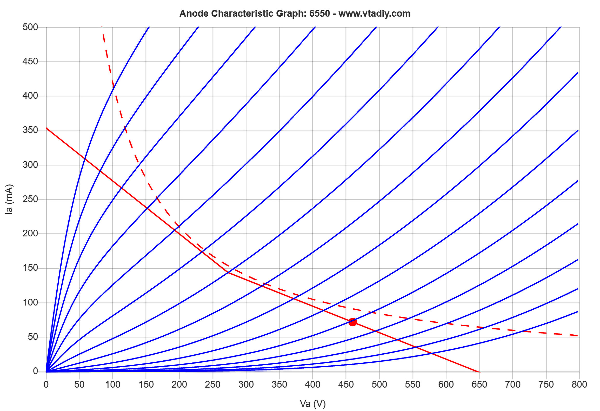

First one is 6550:
B+460V Ia72mA g1-50V g2460V Raa5k2 UL.
It has a gain of 400/50 = 8.
I've modified the 12AX7 plate and shunt feedback from 220 & 47 & 16 kOhm to 100 & 27 & 8.2 kOhm with an idle current from 0,6 to 1,75 mA.
Feedback is 1/7,6 and the load seen by the 12AX7 is 48 kOhm.
Working point is a bit on the edge of the driver capability, but it should have 14 Wrms in Class A before going AB1.
Load lines in attachment.

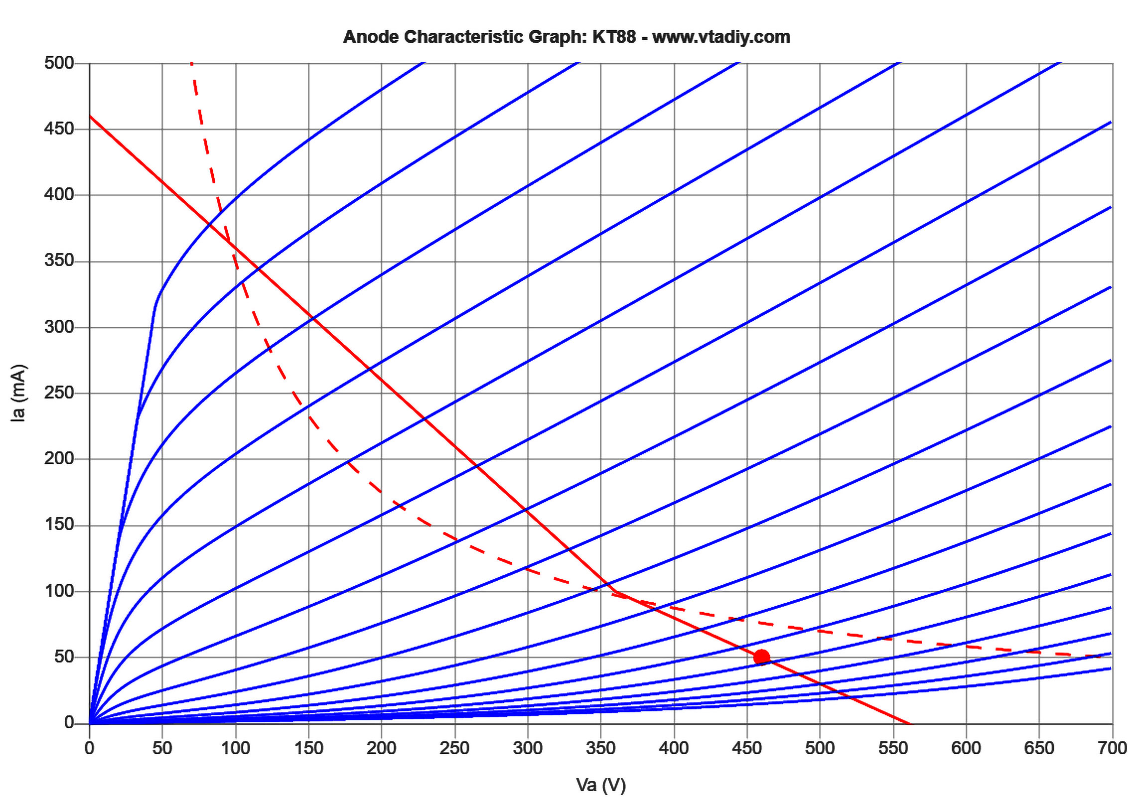

KT88, following the datasheet:
https://frank.pocnet.net/sheets/084/k/KT88_GEC.pdf
B+ 460V, Ia 55mA, Raa 4 kOhm, UL, g1 -58V, g2 460 V.
It has a gain of 6,56.
With the same 12AX7 plate and shunt feedback at 100 & 27 & 8.2 kOhm, an idle current of 1,8 mA and the grid at -1,5V.
Feedback is 1/7,6 and the load seen by the 12AX7 is 53 kOhm, that's better for the increase in needed swing that the KT88 needs in this configuration.

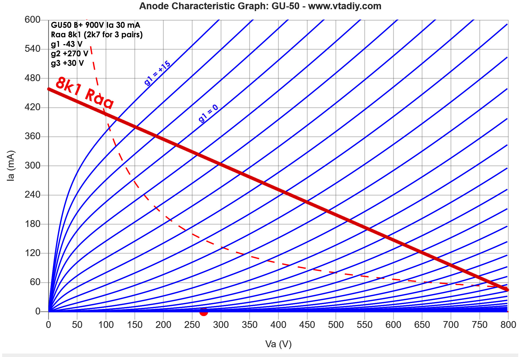

This could be a possible solution for the GU50, the driver should be the same as the one in the previous post, but there's need of dropping around 450 V on the DC side (independently from the current flowing through it) without affecting the signal AC.
Is there something smarter than referring the "ground" of the phase inverter to +450V?
Roberto

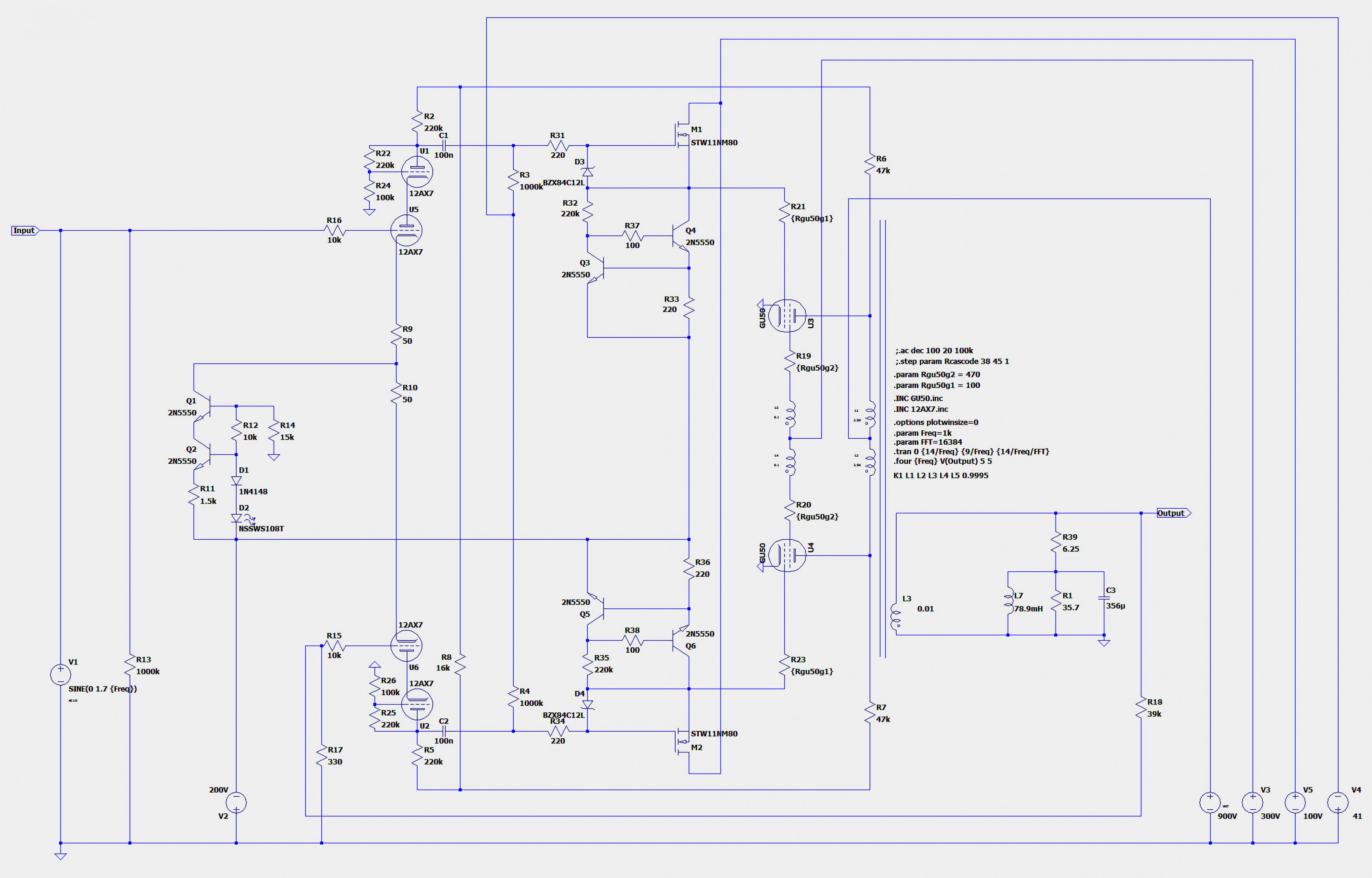

I've sketched this version with GU50s and Raa 8k with UL taps at 20%.
PI has ultralinear cascode 12ax7s, to keep the concept of applying local feedback.
With 1,7 Vp at its input:

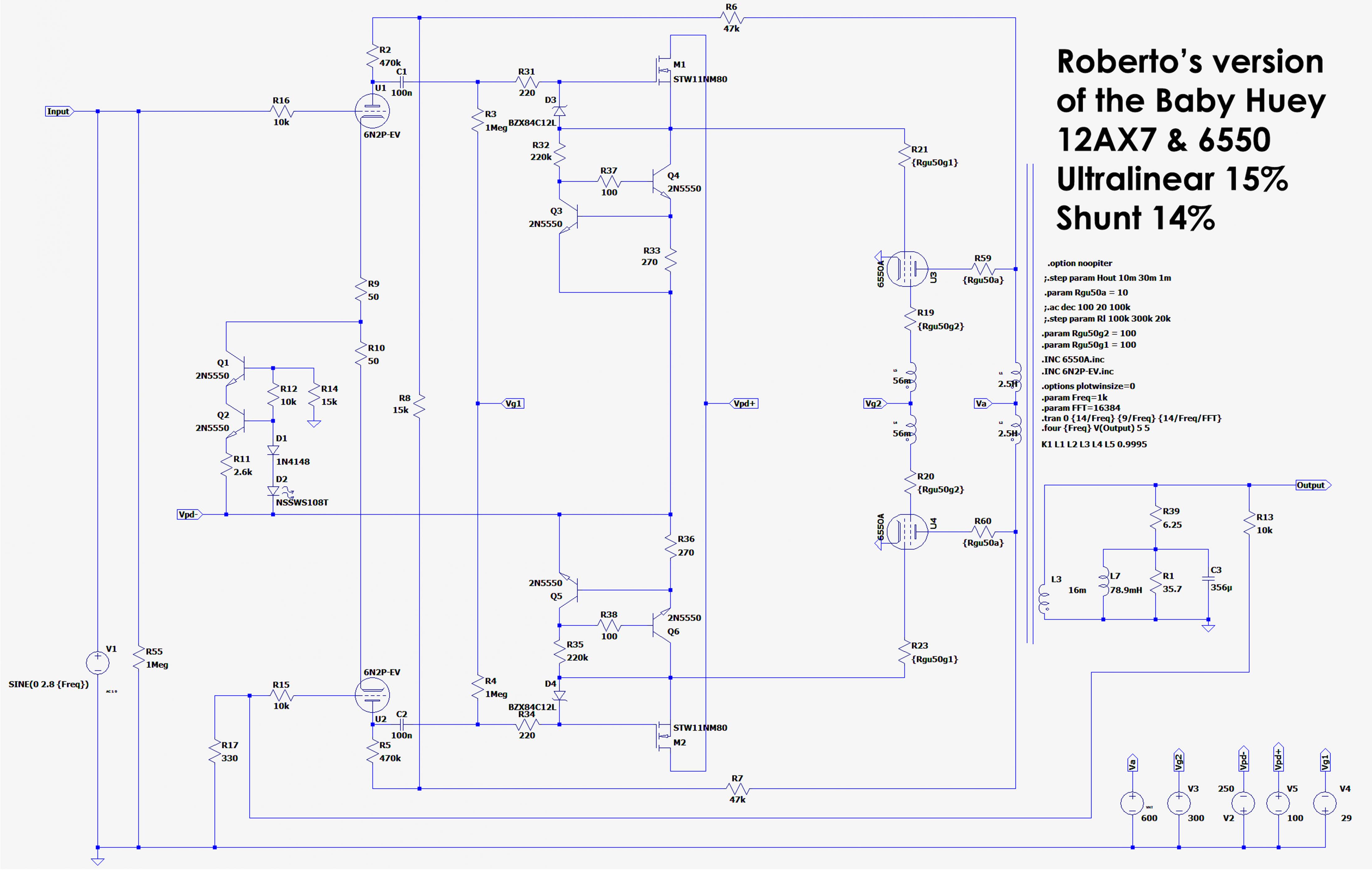

Following latest gingertube's posts, I add this other version of the Baby Huey with the 6550.
Code:
Harmonic	Frequency	 Fourier 	Normalized	 Phase  	Normalized
 Number 	  [Hz]   	Component	 Component	[degree]	Phase [deg]
    1   	1.000e+03	3.667e+01	1.000e+00	   -1.57°	    0.00°
    2   	2.000e+03	3.578e-03	9.756e-05	  172.11°	  173.67°
    3   	3.000e+03	2.680e-01	7.306e-03	  122.33°	  123.90°
    4   	4.000e+03	5.277e-03	1.439e-04	  127.32°	  128.89°
    5   	5.000e+03	3.720e-01	1.014e-02	  169.70°	  171.27°
    6   	6.000e+03	3.301e-03	9.000e-05	  171.10°	  172.67°
    7   	7.000e+03	1.757e-03	4.791e-05	    9.74°	   11.31°
    8   	8.000e+03	2.422e-03	6.603e-05	  157.93°	  159.50°
    9   	9.000e+03	7.793e-02	2.125e-03	   16.89°	   18.46°
Total Harmonic Distortion: 1.268177%(1.275905%)
