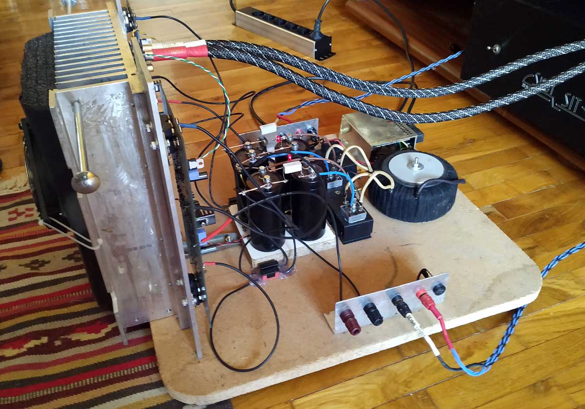

I'll address tech. questions little later, after doing some chores ........... having 17yrs young She around is endless source of fun...... I'm doing all the things my Father certainly didn't
now, only to quote my self :

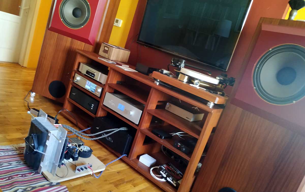

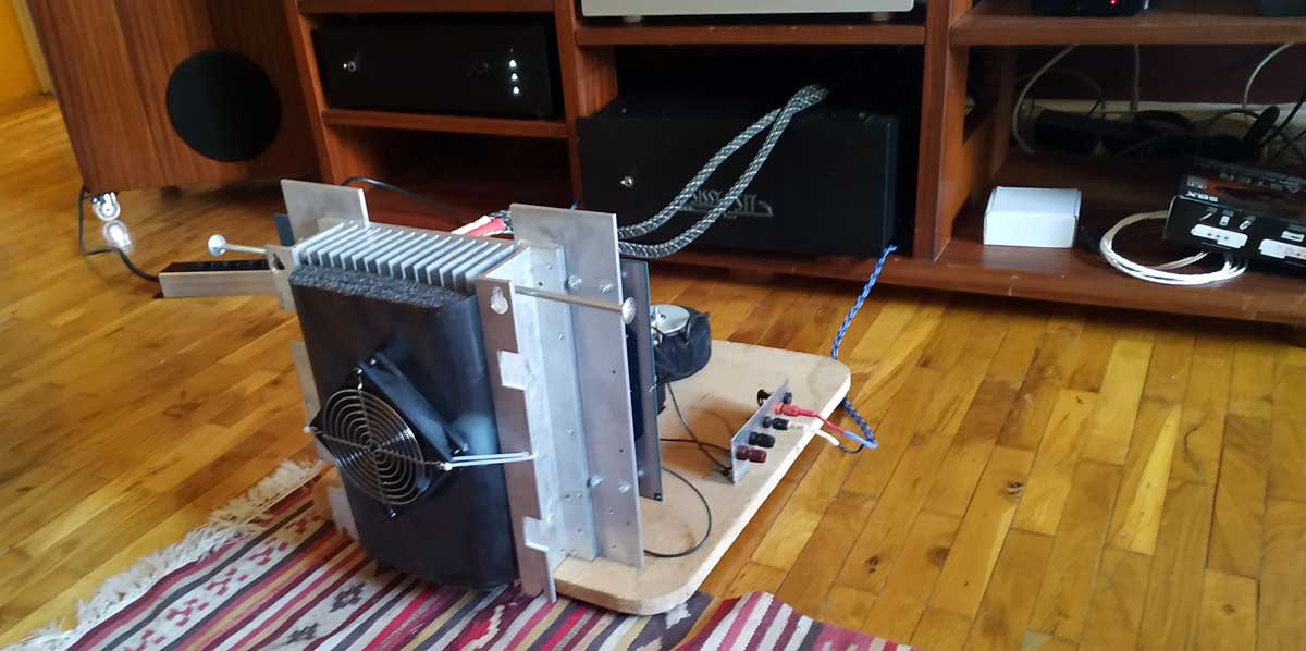

now just report about today's visit to my Official Second Set of Ears
it's bloody jolly good
did I said Spooky?
whatever of nasty demanding but divine music we did throw on it, it came with ease
nuff said, it did pass (almost as Pass made it
), now I can freely dissmantle N channel mosfets and mount THF51 instead
tomorrow or day after, you can expect report and results
another instance of All the Glory, or Major Flop
if you don't hear anything from me in 3 days, Flop it is

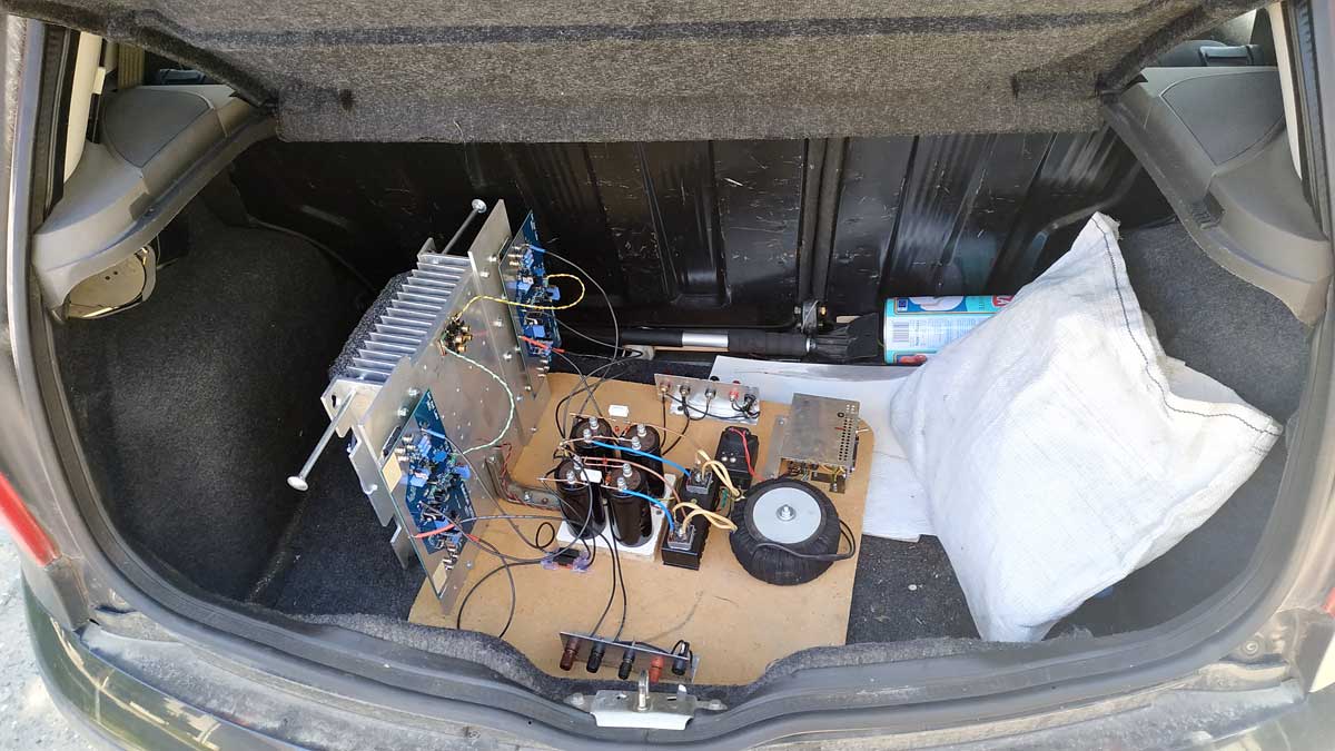

OK1-OK2-TH1 .......... 10A limiting circuit, Savior of Our Souls, blatantly stolen from Pa 😛
did I said Spooky?

Oh those beautiful Tannoys and coupled with a Major Success
What more could us greedy boys ask for
Have fun with your daughter - we can wait for the next success story 😉😉😉

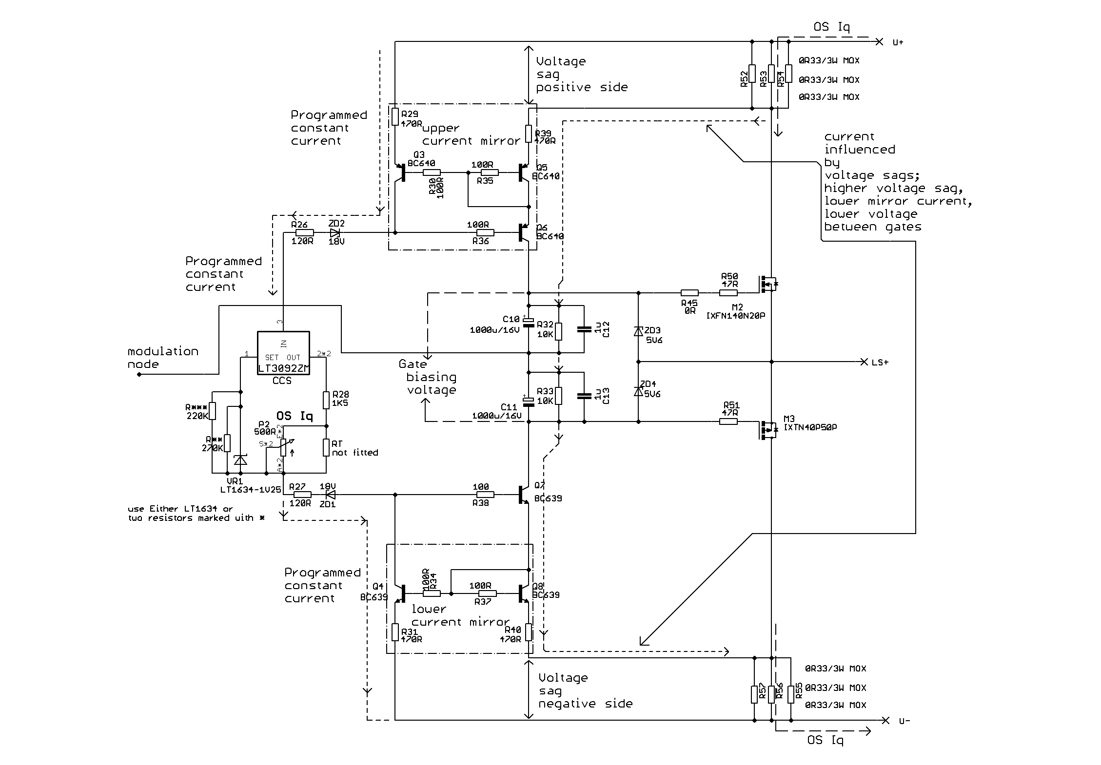

let me know if pic is worth less than 1000 ....... JFets
let me know if pic is worth less than 1000 ....... JFets![]()
good, now even I understood how it works!
Hi ZM,
So, from your picture, you are saying that the programmed constant current sources remove the drift in the bias voltage, with voltage sagging, and the bias drift from the outputs heating up is just handled by the thermal mass of the output heatsinks. So if you want it stable you had better use big heat sinks or the bias will go up as it heats up. Correct?
With SissySIT R.3/M25 R.2, no worries as it’s tracked by the optos?
Thanks 🙂
you got it wrong
stare at pic some more
there is servo function in that, fully working, no need for aux gimmicks as NTCs and whatnot ...... and heatsink must be adequate, but not as biasing helper
current mirror is having programmed current at one side, while other side of current mirror is increasing or decreasing own current, so that voltage sags stays constant
current of "working" side of CM is changed simply by effect of changing voltage between rail and base, while emiter resistor is not changing ........ so effect must be change of current though part
contrary to that, reference halves of CM are having everything constant - both current through them, same as constant voltage between bases and rails
