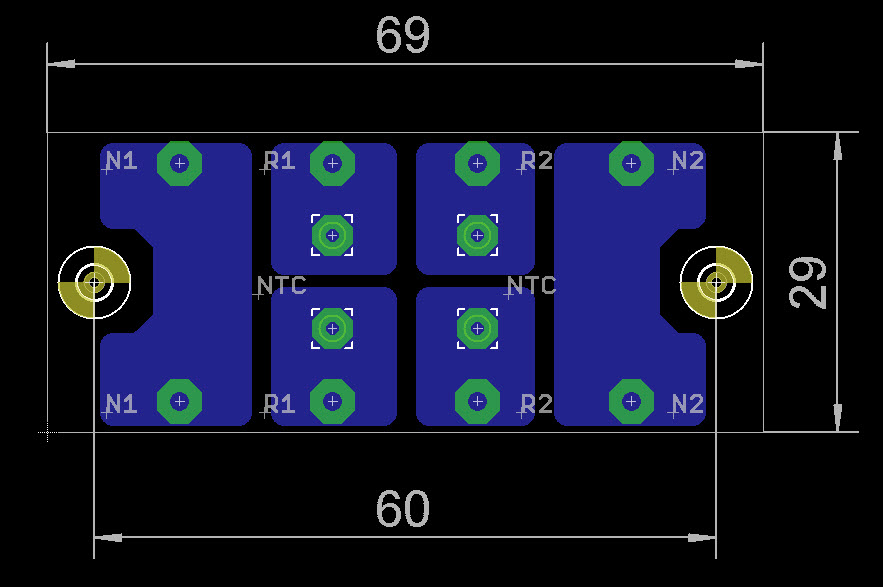

have to wait 'till next Thursday , to get newly made mains NTC pcbs

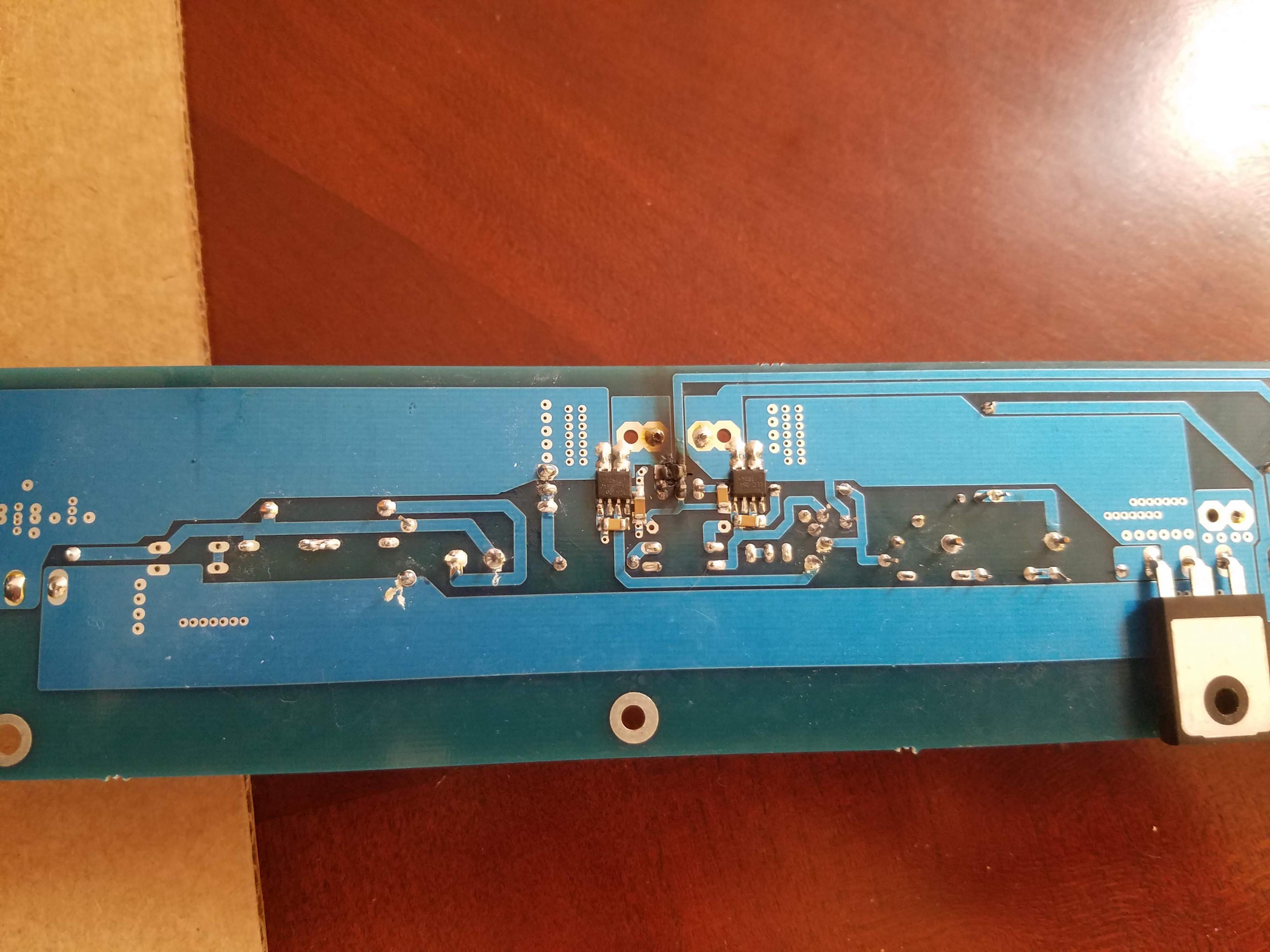

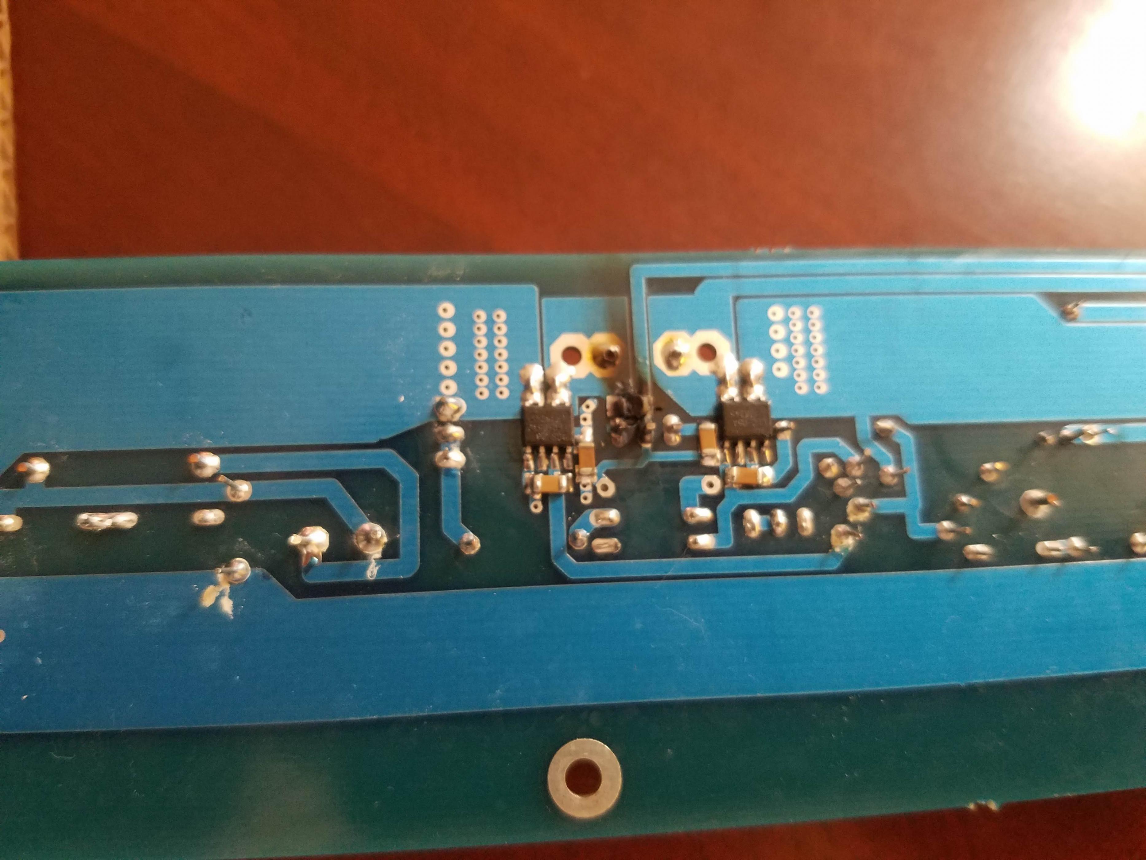

that's SMD 100nF-200nF , filter cap for 7805
if you're able , you can solder any small 100nF cap there , on SMD pads
it couldn't go Dodo because of overheat (nothing is heating it) , neither you have critical voltage
maybe you got blob or splash of solder there which did go Puf! , taking cap with it
worth trying to troubleshoot , minding is there steady 5V at 7805 output
if yes , hall chips are alive
So, replace blown/melted filter cap, reinstall board, reconnect SIT, and measure voltage difference between p2 (ground) and p3 (output) of 7805? That should be 5V.
I can leave input and outputs unconnected during the procedure, right?
Thanks ZM.

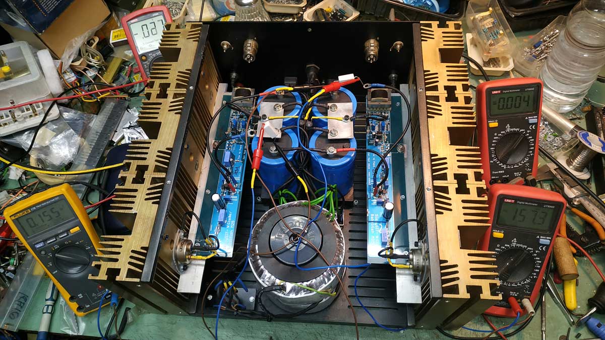

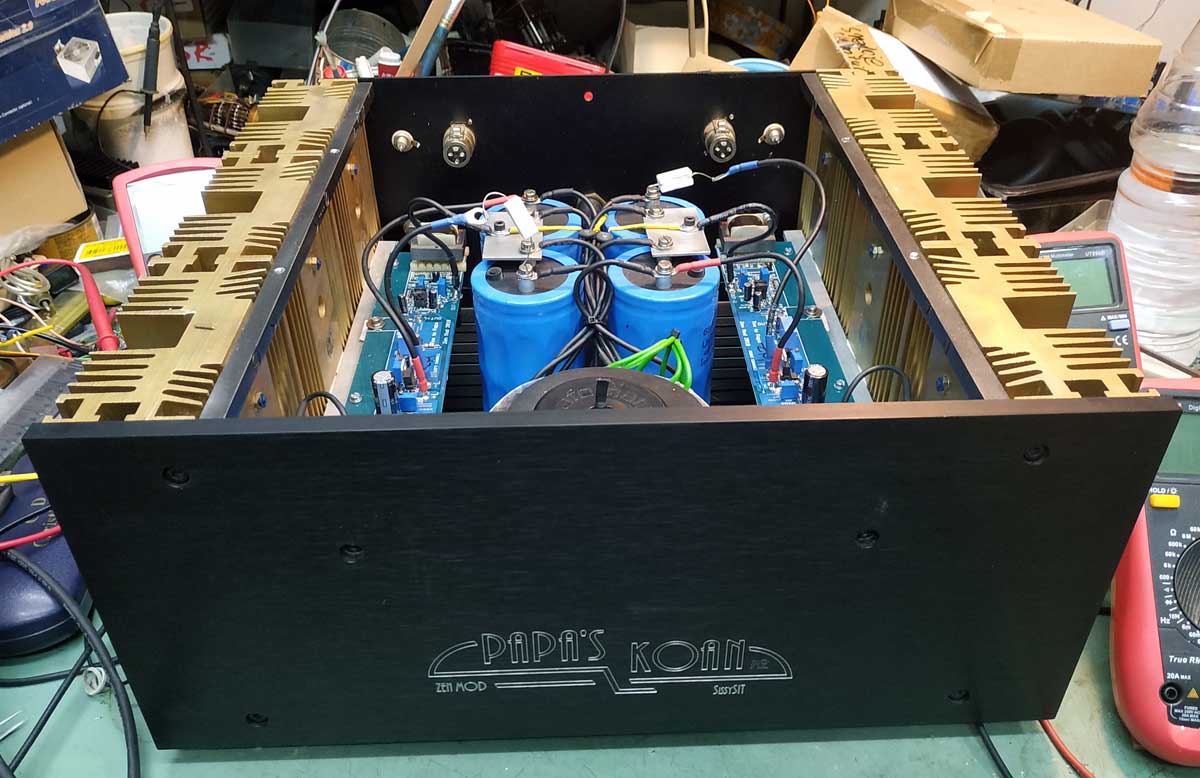

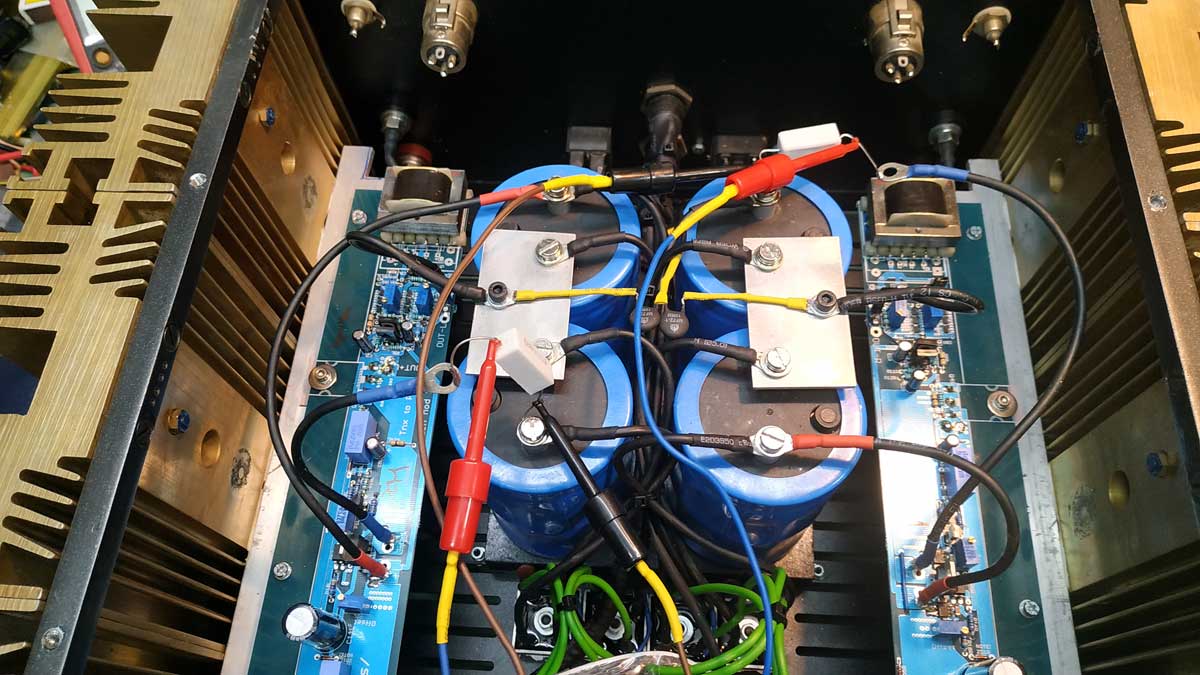

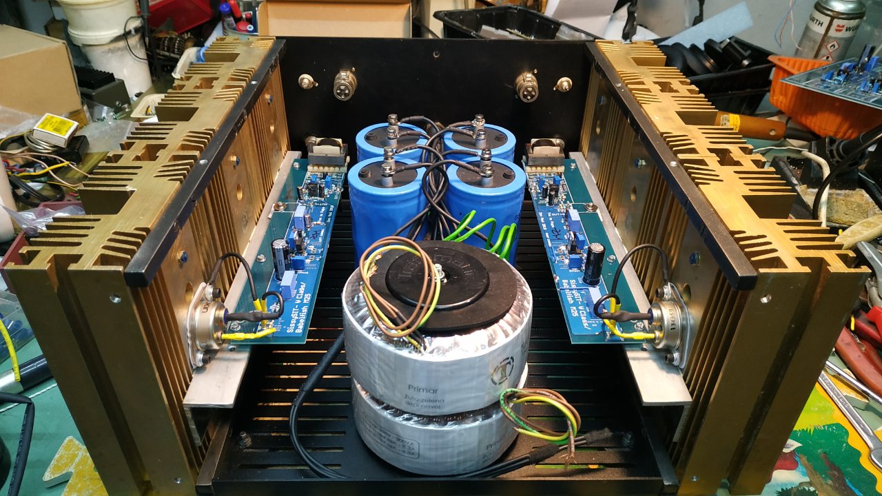

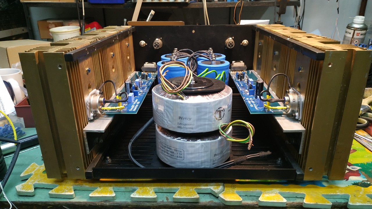

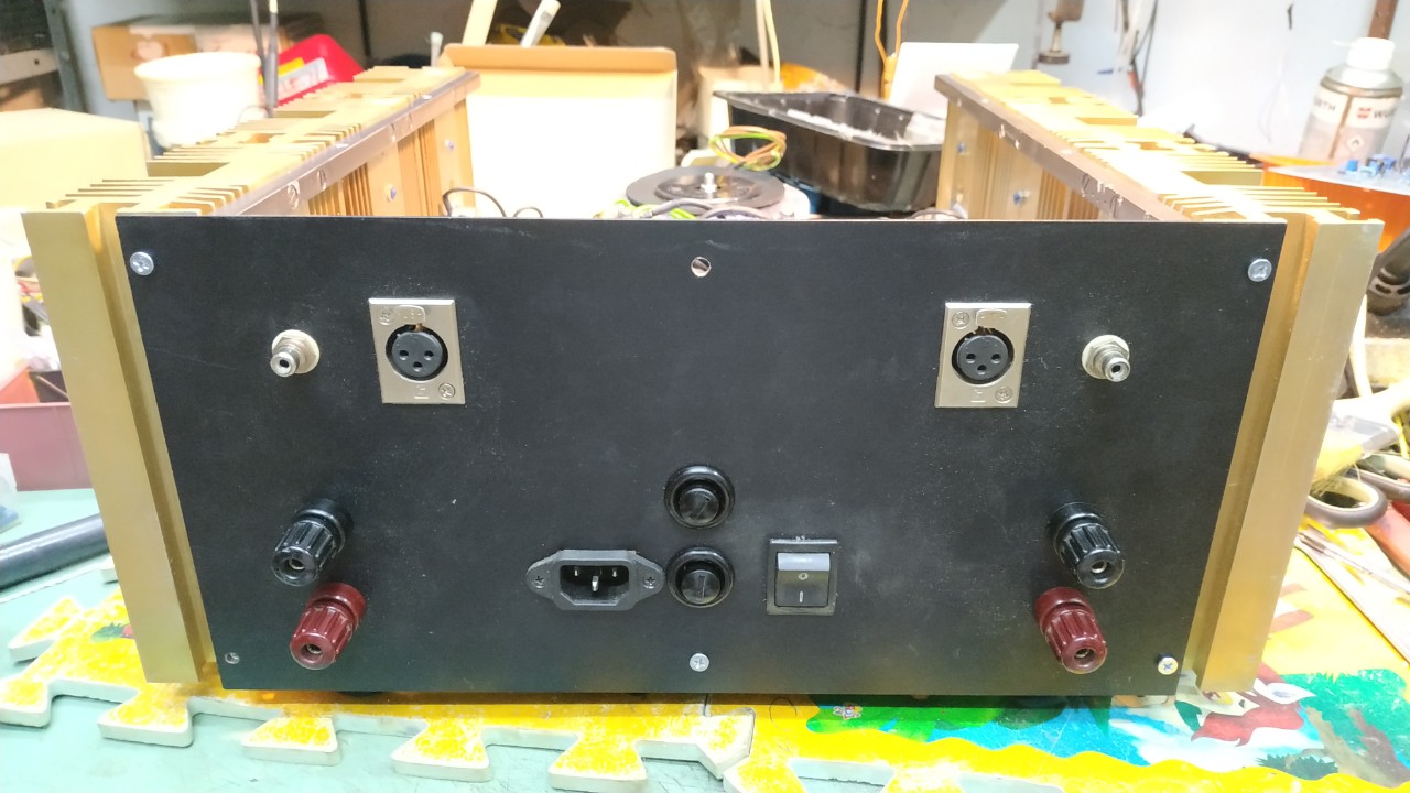

got NTC pcbs today 🙂
LEDs , tiny input wires , final cooking ........ then rocking!
