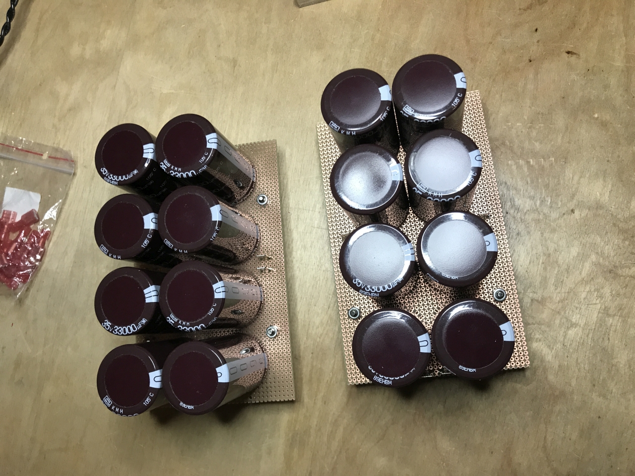

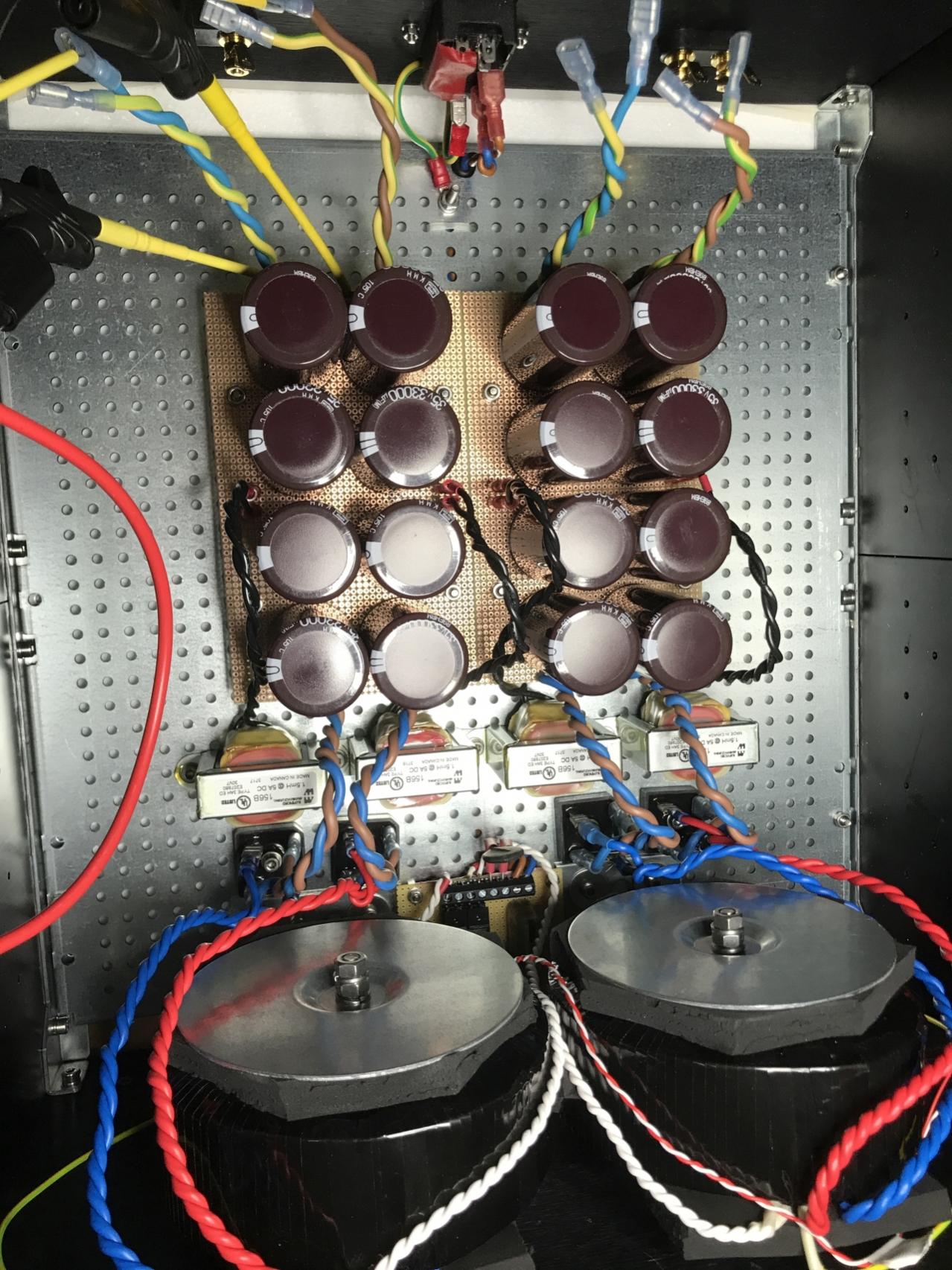

My PSUs are almost ready now as well ...
(Have some Motor Run Caps on order, to be placed at the back of the amp, and to have the Fastons from the PSUs connected to. From there to the amp boards then ...)

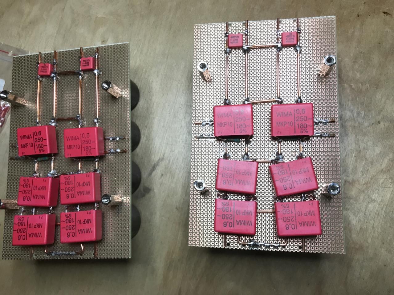

2.5 mm^2 wires soldered directly to the solidcore wire on the underside of the PSU boards. Bleeder resistors and some film caps also soldered from underneath.

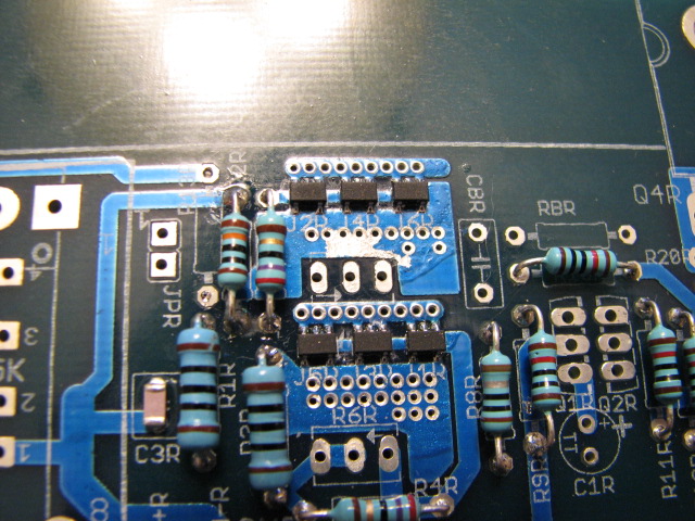

I have a place on one of my boards, I thought it was a deformed solder pad, but under magnification it looks like some of the blue mask has come off or is missing?
For some reason, I cant seem to upload pics...never been a problem before, I keep getting the "Aww snap" thing. Tried rebooting, incognito page, original settings etc. but no help..
I will when I can. Is the missing mask a problem?

zen mod has the final say but I wouldn't expect that to have any impact ..dB
At first I wondered, as continuity showed across the "bald" part....but so do the small pads on the unaffected board.
You are right, will wait for ZM's final say.

if you're going to put motorruns , all those wimas are unnecessary
Yeah ... that was just my usual modular thinking to have the PSUs as building blocks that could be re-used by themselves ...
