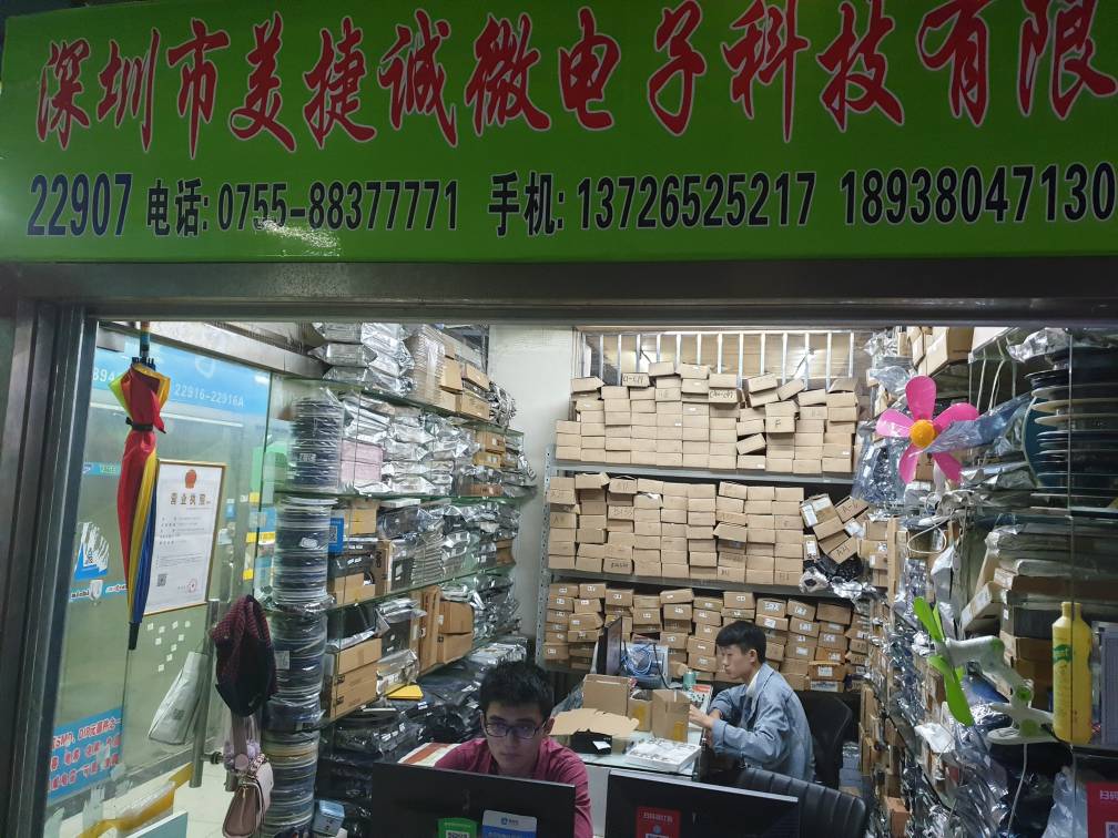

I visited Pras1150 at her shop, she was nice to show me around. Very friendly and we can buy with ease of mind. ;-) 20190221_135847.jpeg
