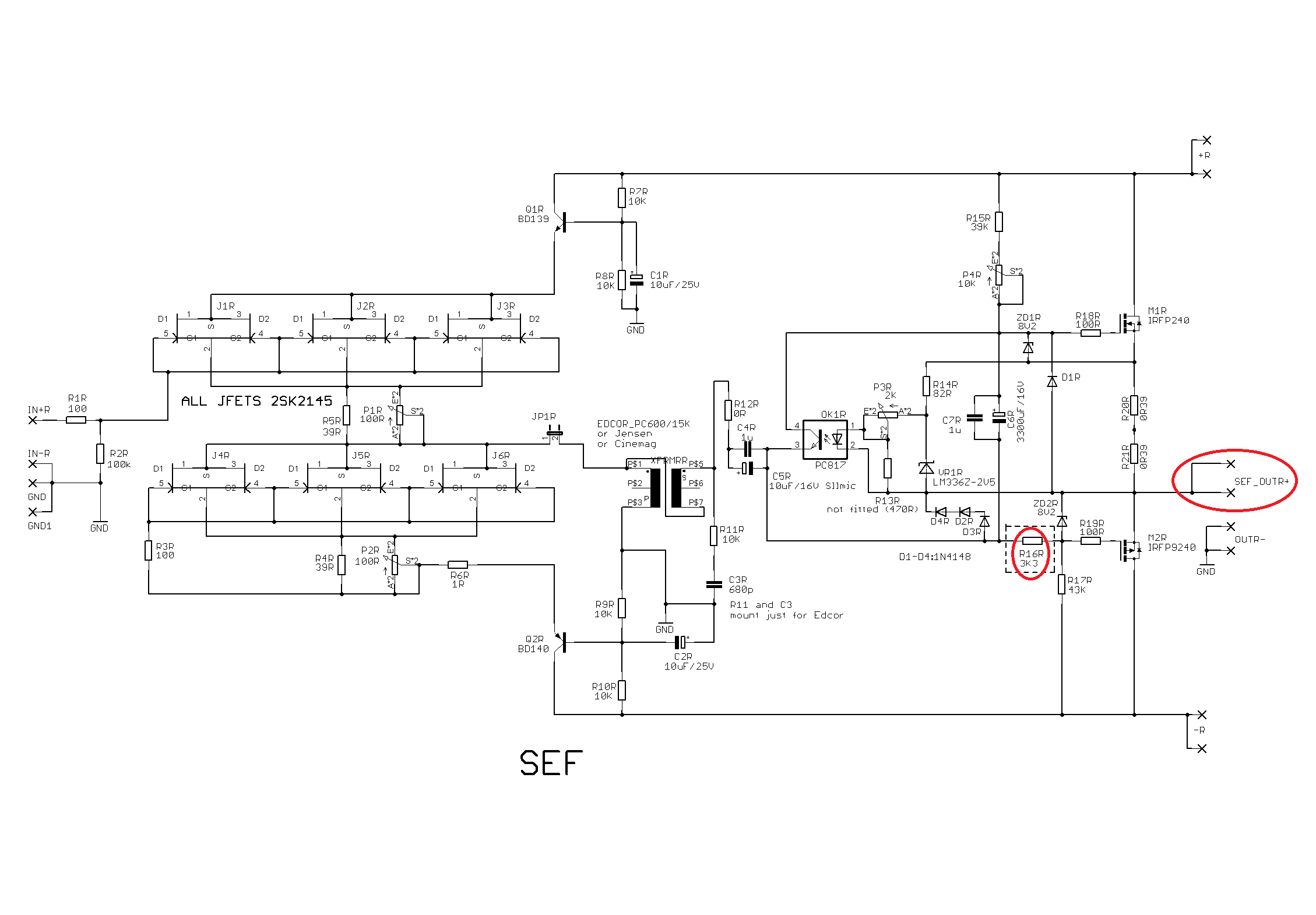

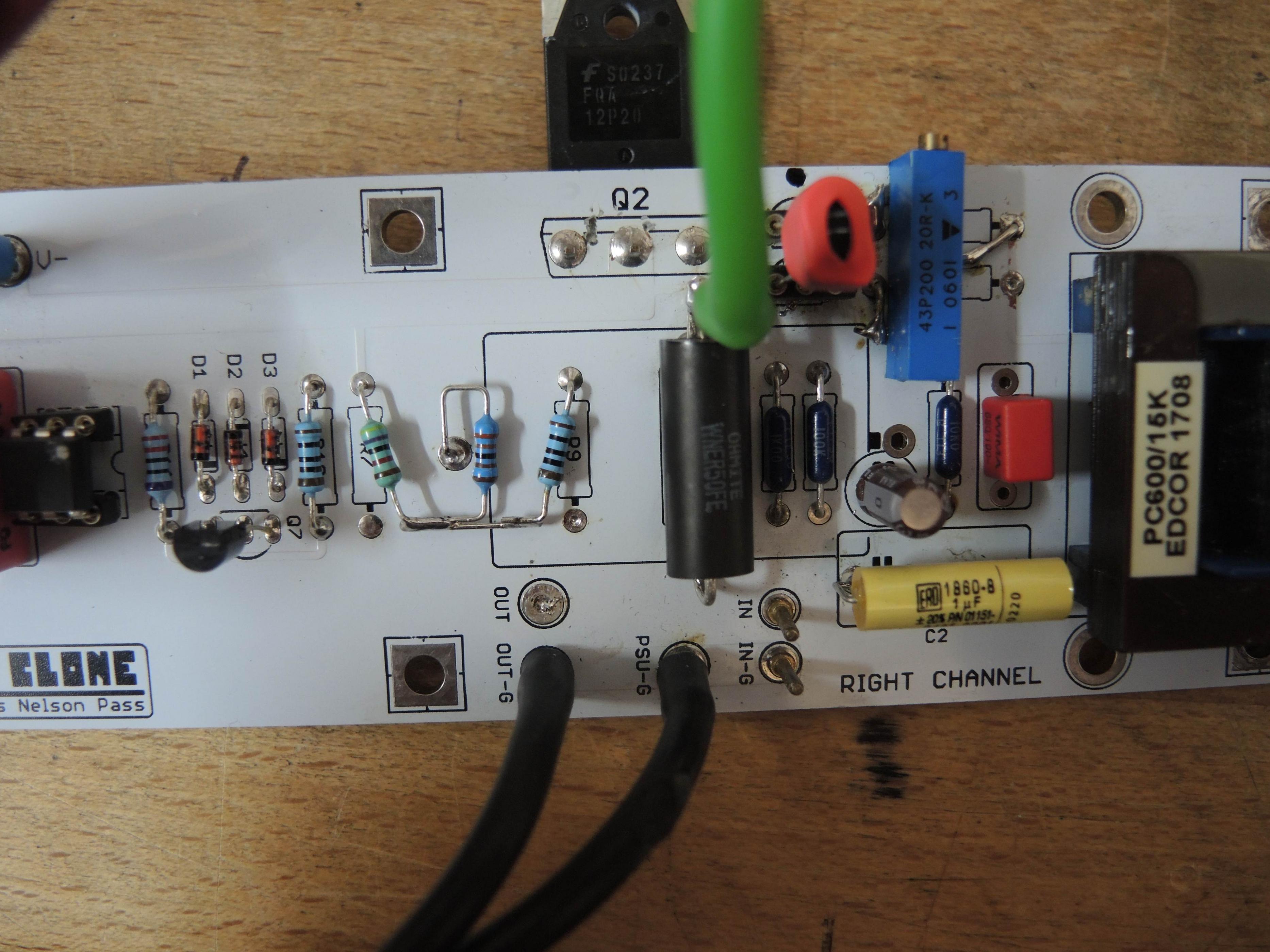

Should the new output be taken from the drain of Q2
and is the pinout looking down on Q2
G D S?
Thinking about doing the mod to my Toshiba M2

nope Bubba
for SEF, output taken directly from source of IRFP9240 (that one in negative rail)
pinout , numbers looking at you , legs down , from left, is always G-D-S

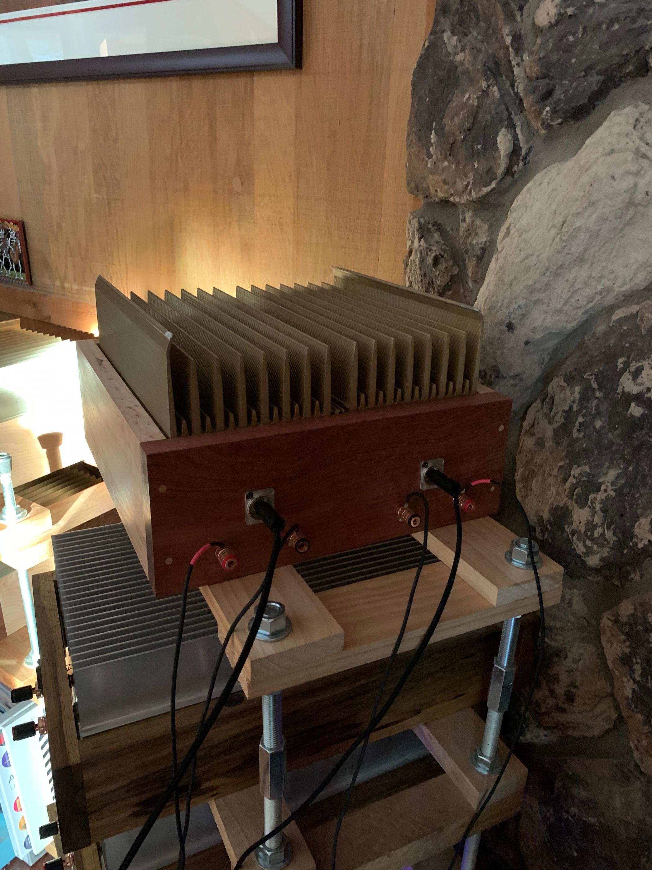

Schaded M2 up and running
Using Schade 3.5k ohms.
Bias 1.4A
R6s 40k on one channel, 42k on the other
Wide and deep soundstage - tight bass - instruments well placed - smooth -very easy to listen with this amp.
Highly recommended if you don't have access to THF51s or 182s

Bob, don't forget to try both speaker polarities. 🙂Schaded M2 up and running...
I like stone detail 🙂
I'm glad that you're glad
what's most important , besides fact that's one more iteration of already good amp , is confirmation that Schade can be implemented without too much penalty in linearity in upper part of spectrum
indra1
On my Tannoys changing polarities is interesting - there is a subtle difference - original polarity seems a bit warmer to me - sorry I am using a term that may be different for each individual - both are listenable - this may have to be integrated over more listening 😀
Still say that this would be a great amp for a person new to diy
After extended listening it is hard for me to select a preference - both connections are listenable - I went back to original set-up for now. Maybe it's my ear/brain combo. It's all about experimenting 😀
