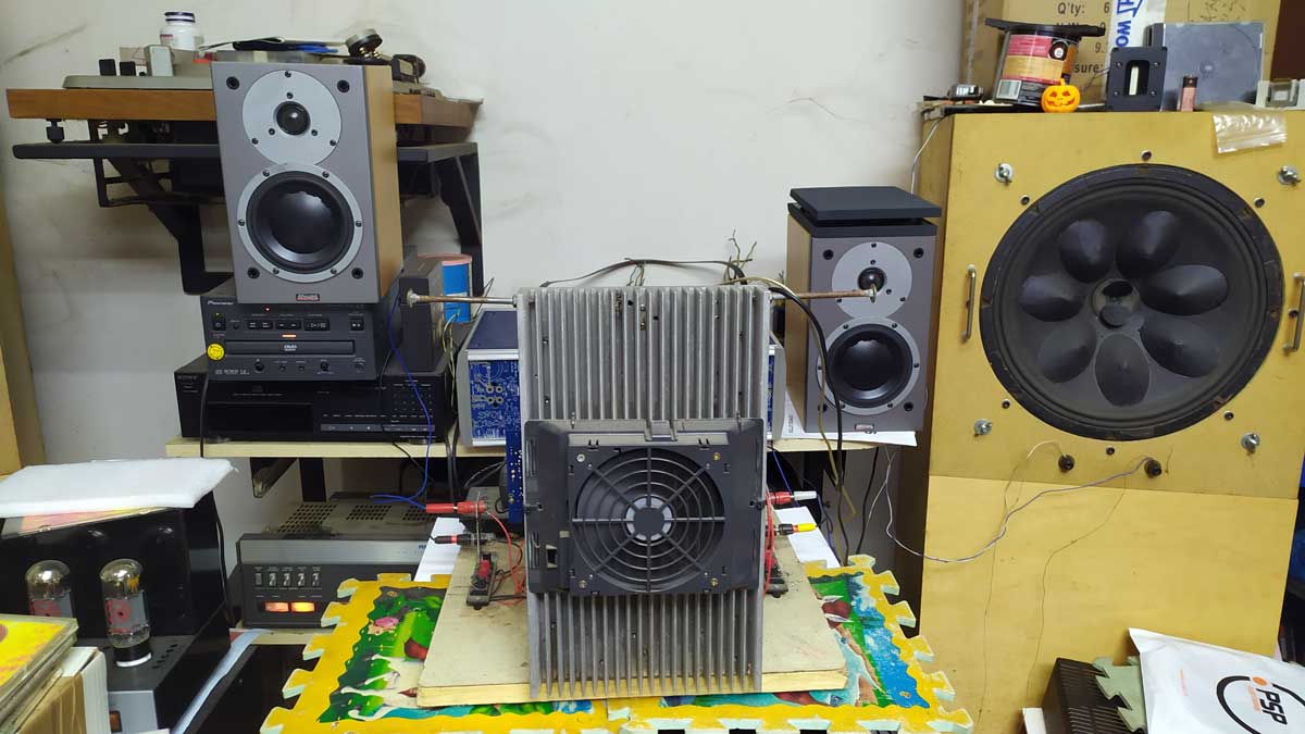

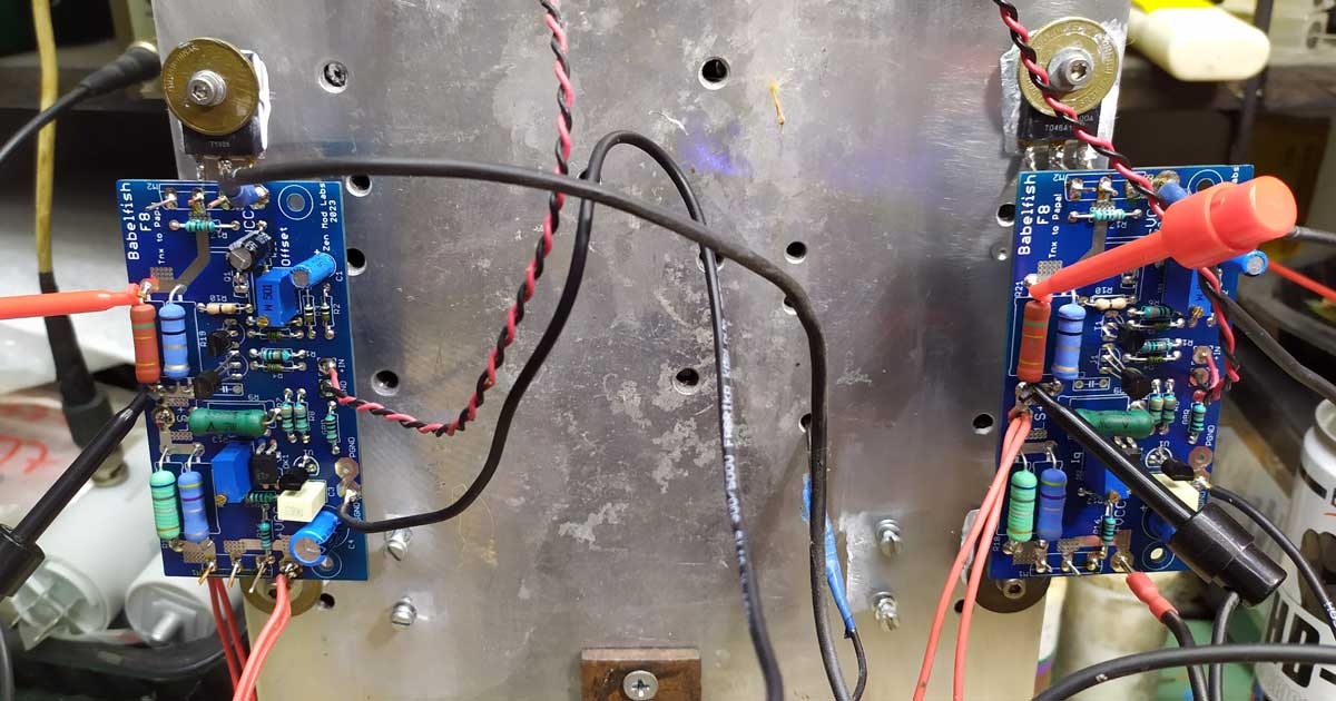

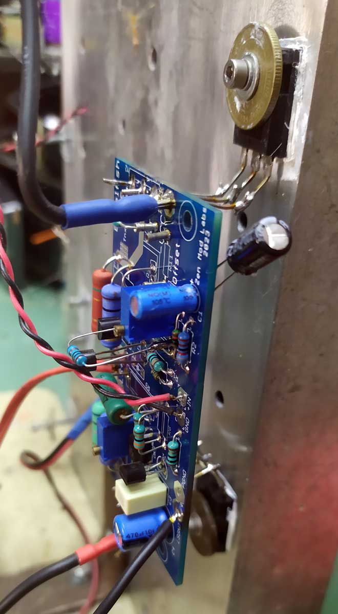

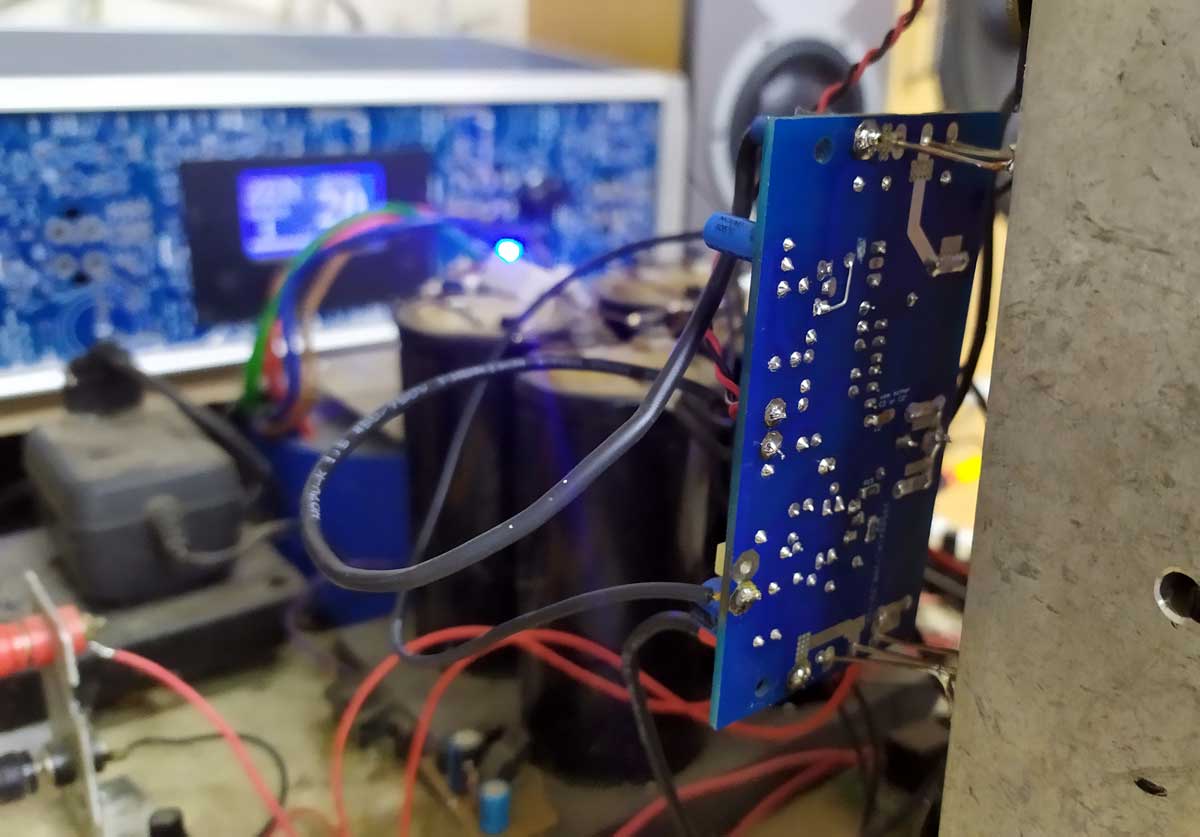

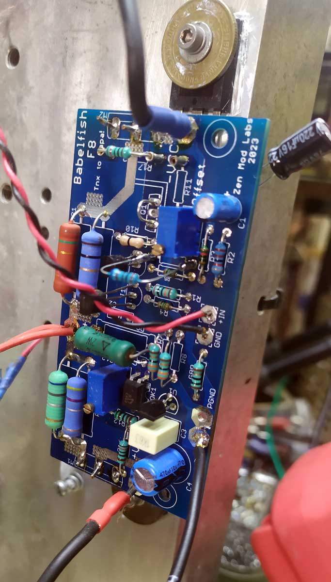

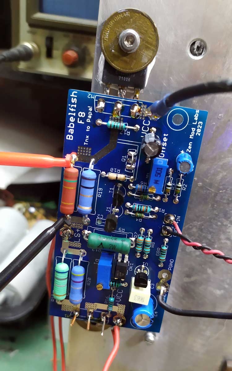

Now, pics showing proto phase, as proof that I didn't just dream of ........ though, never underestimate capabilities of dreaming
Not once I had problems solved while dreaming
Curse of Living a Dream

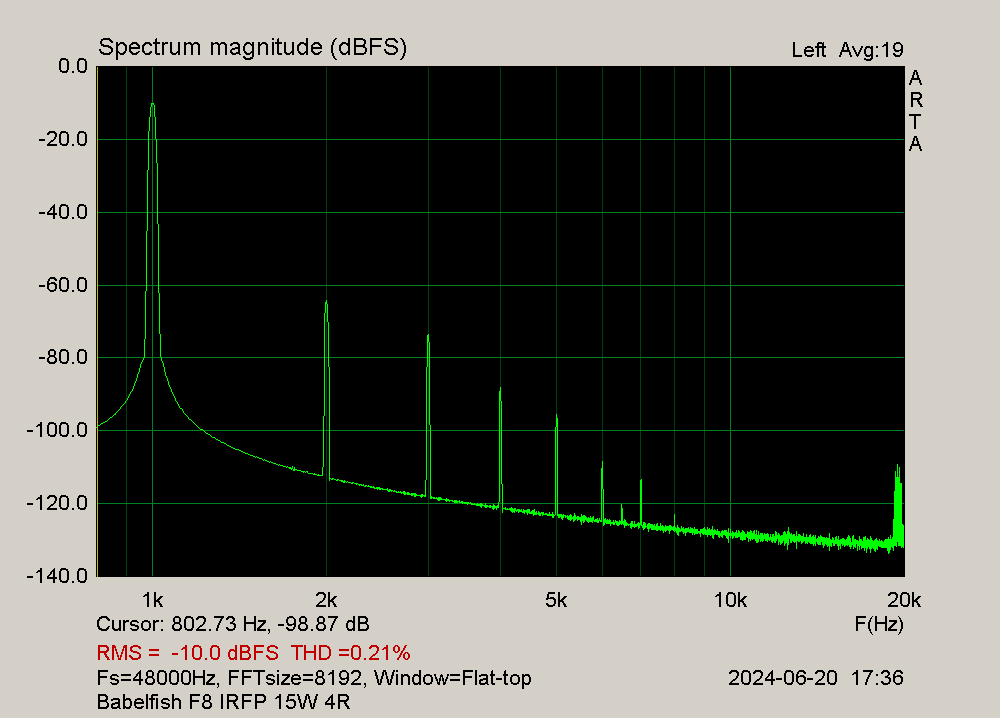

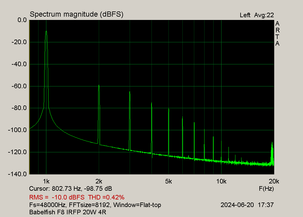

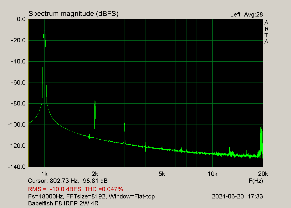

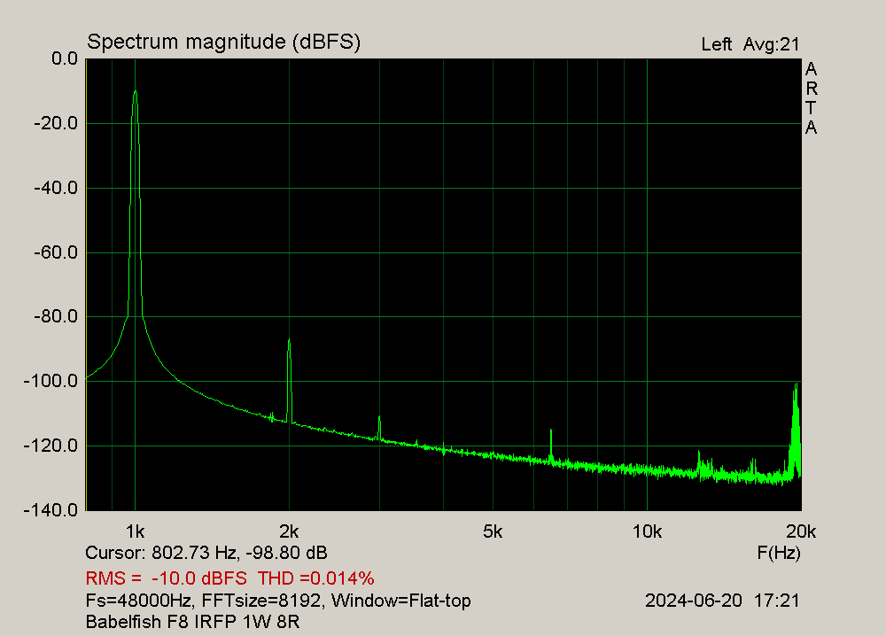

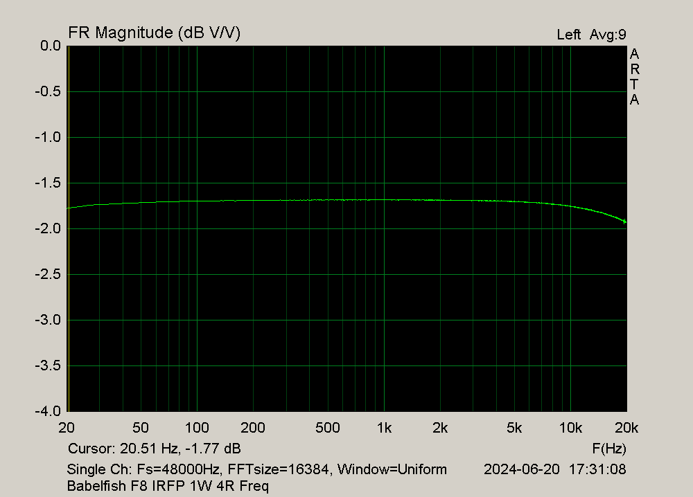

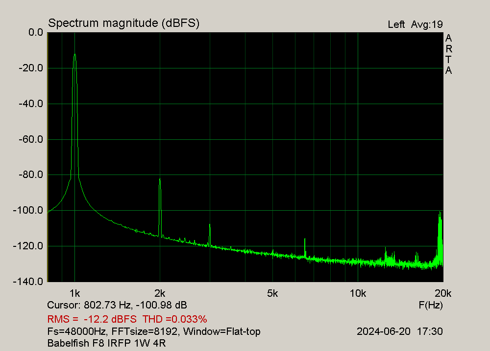

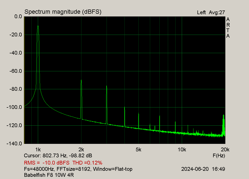

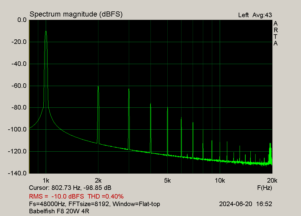

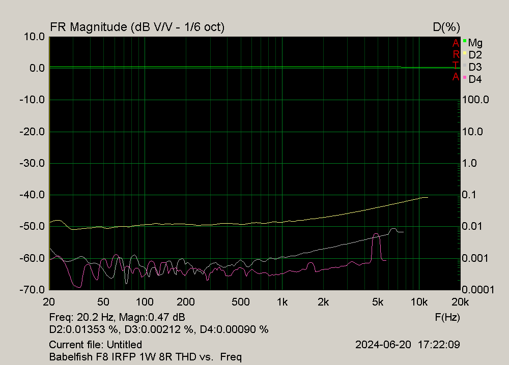

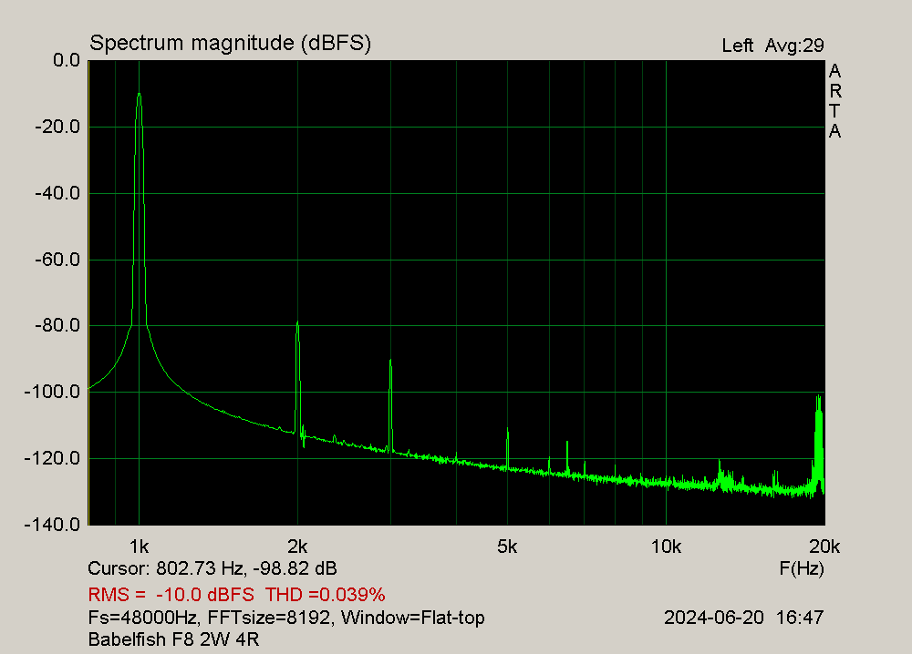

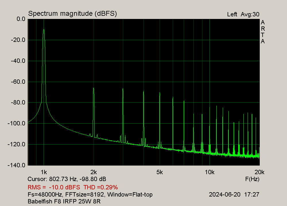

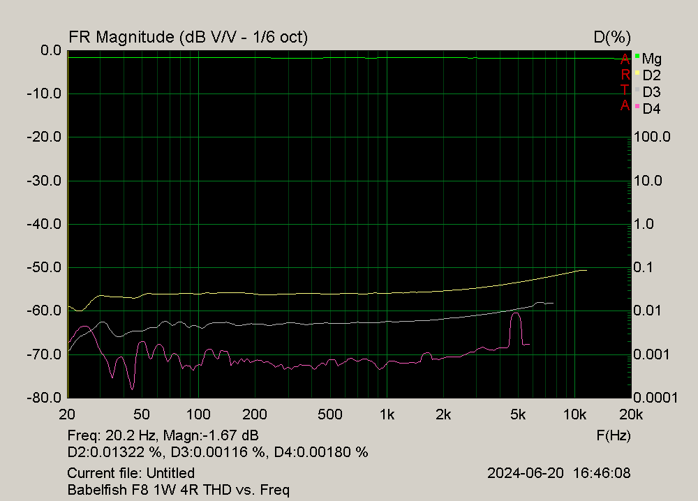

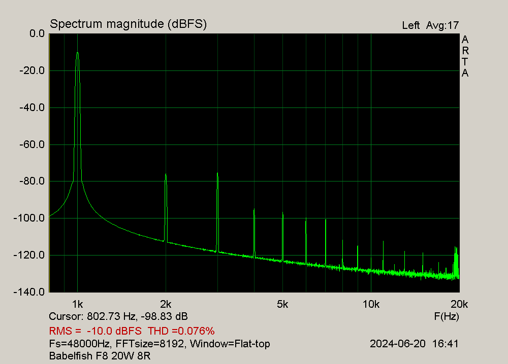

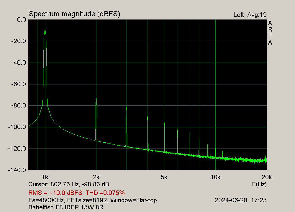

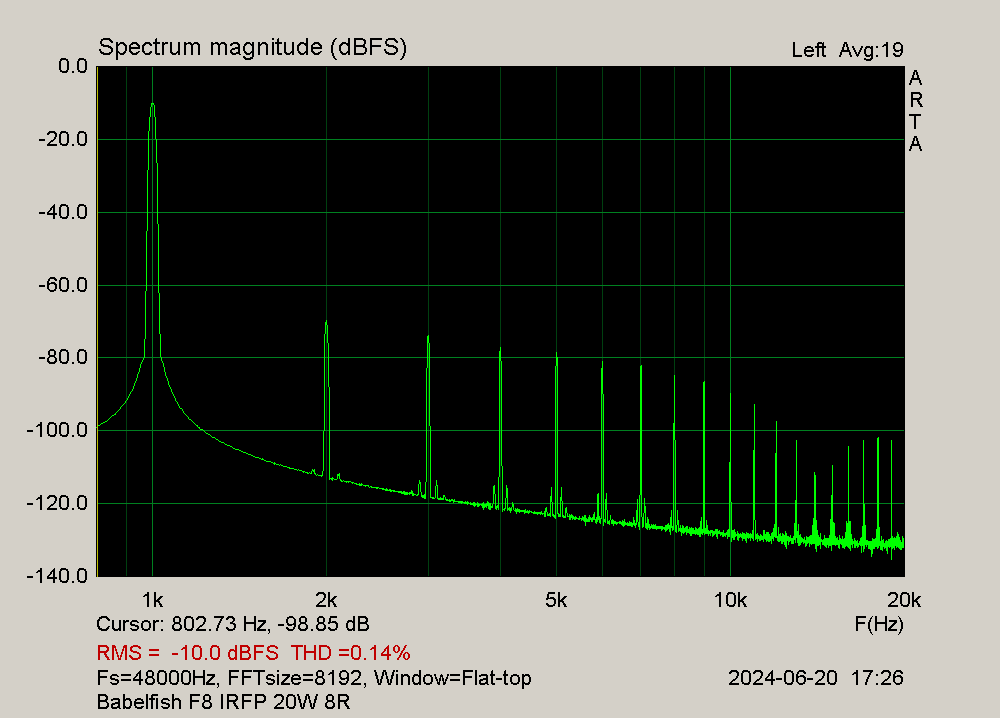

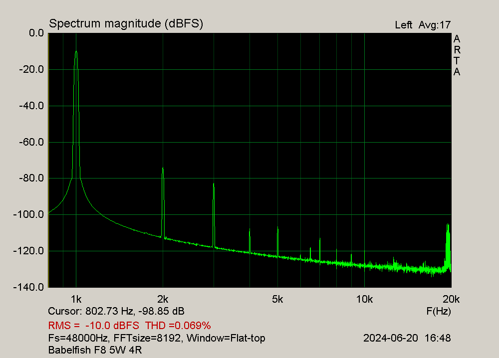

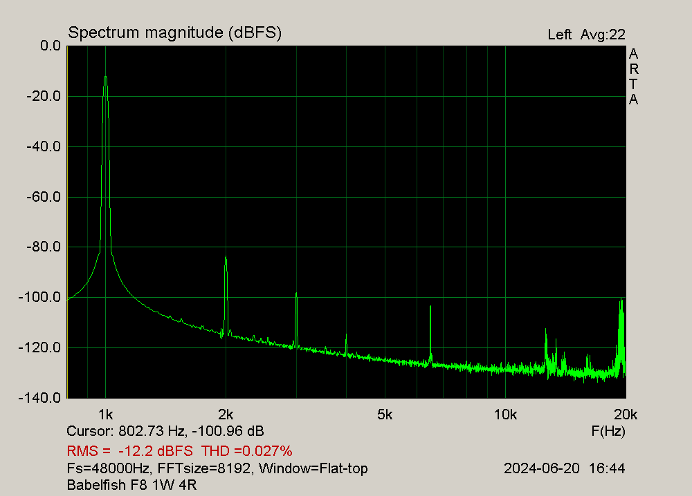

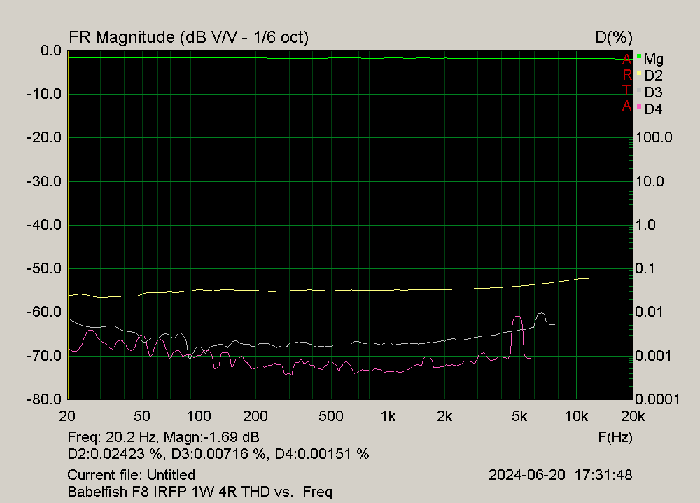

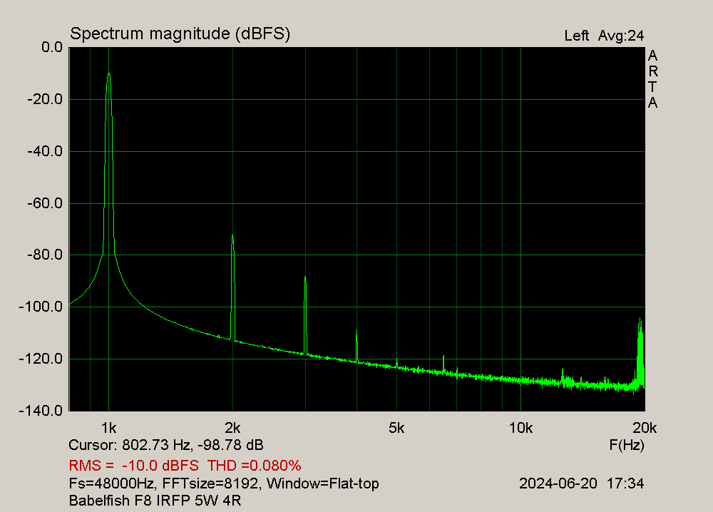

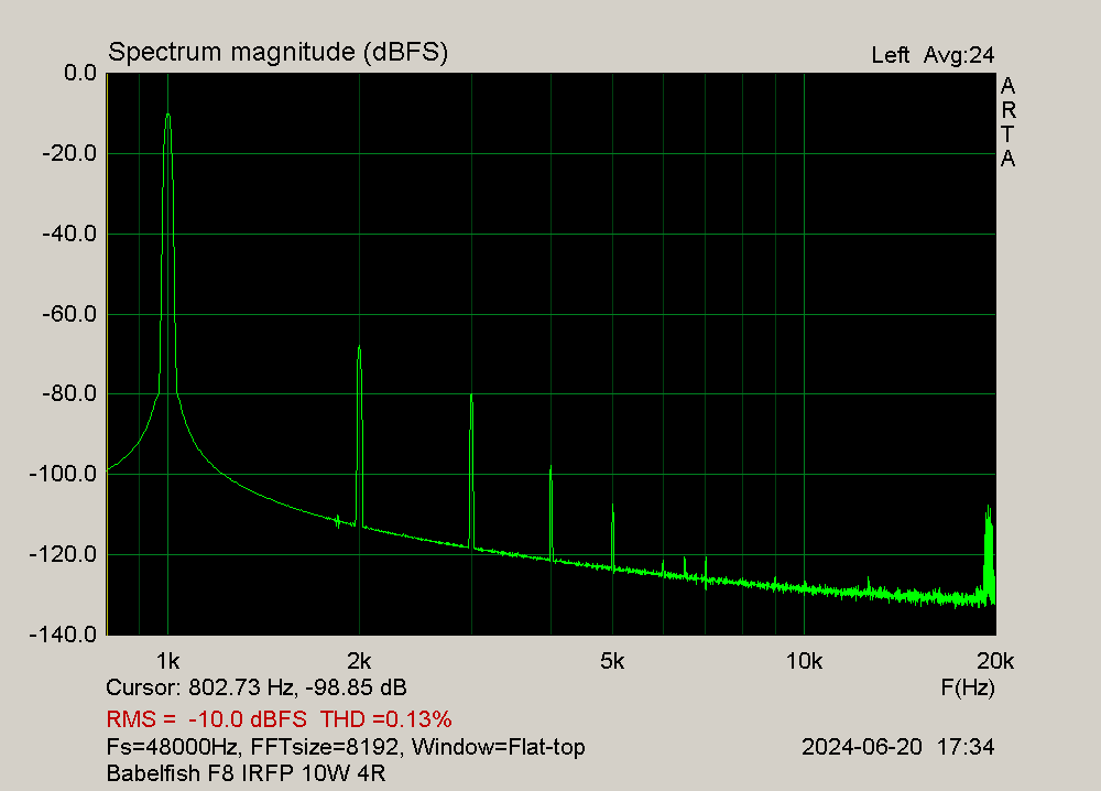

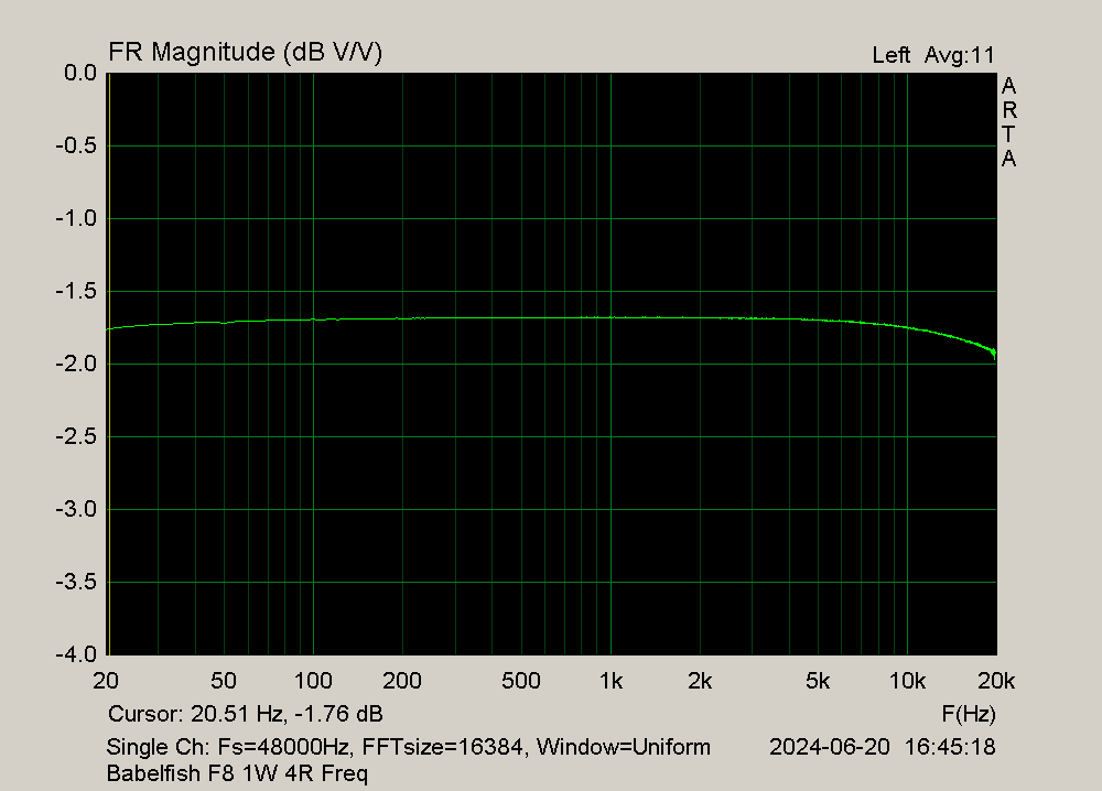

Desperate Poor Greedy Boy iteration, all IRFP150
Iq 1A8, regular FW (nominal) 24Vdc rails, 4R Load

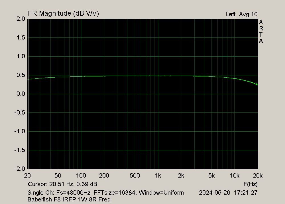

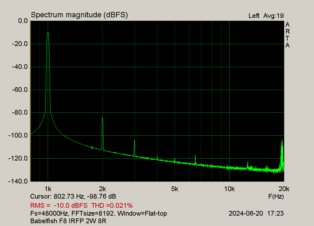

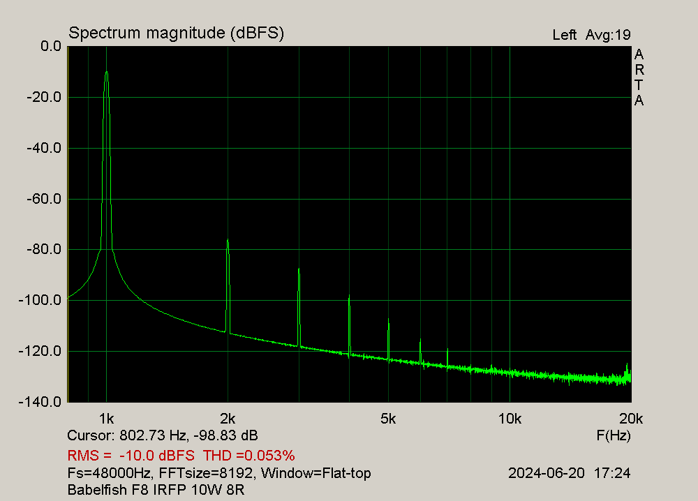

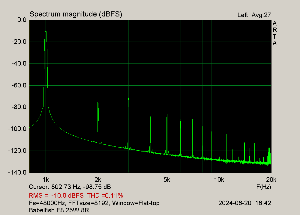

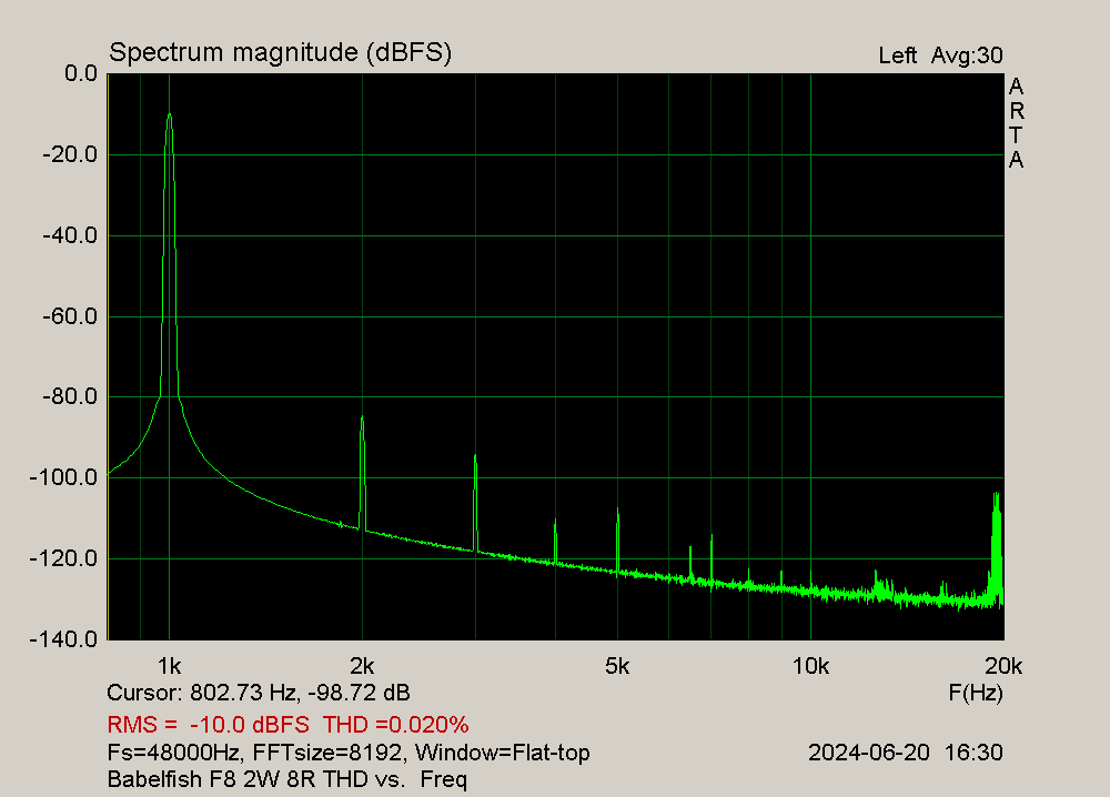

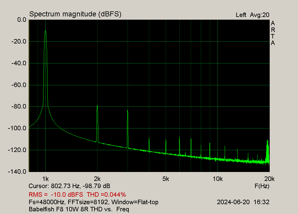

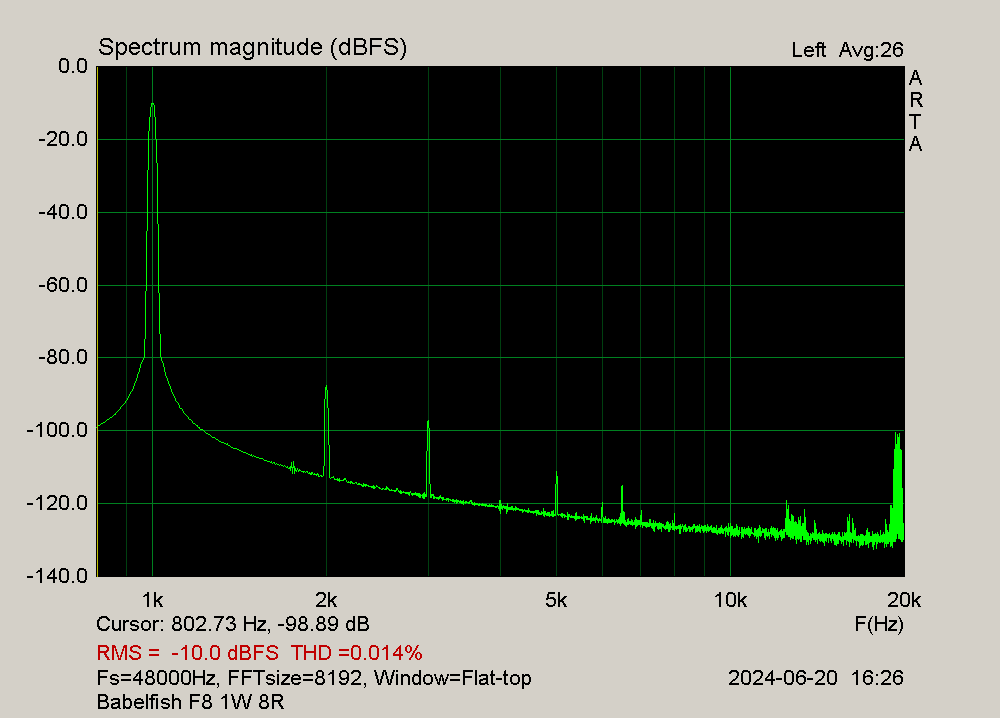

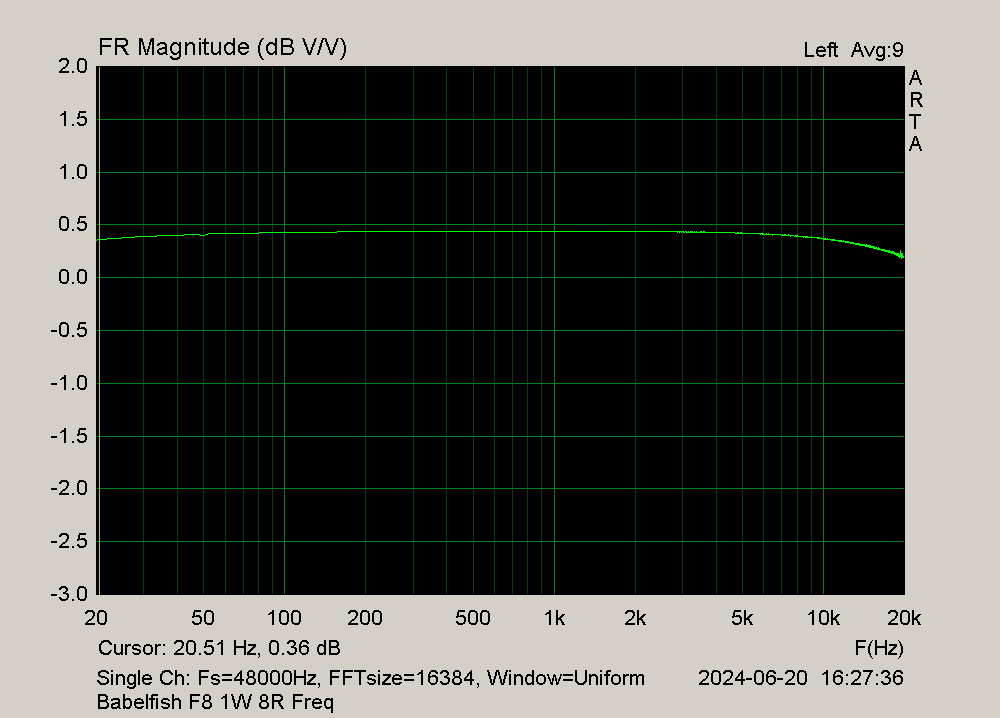

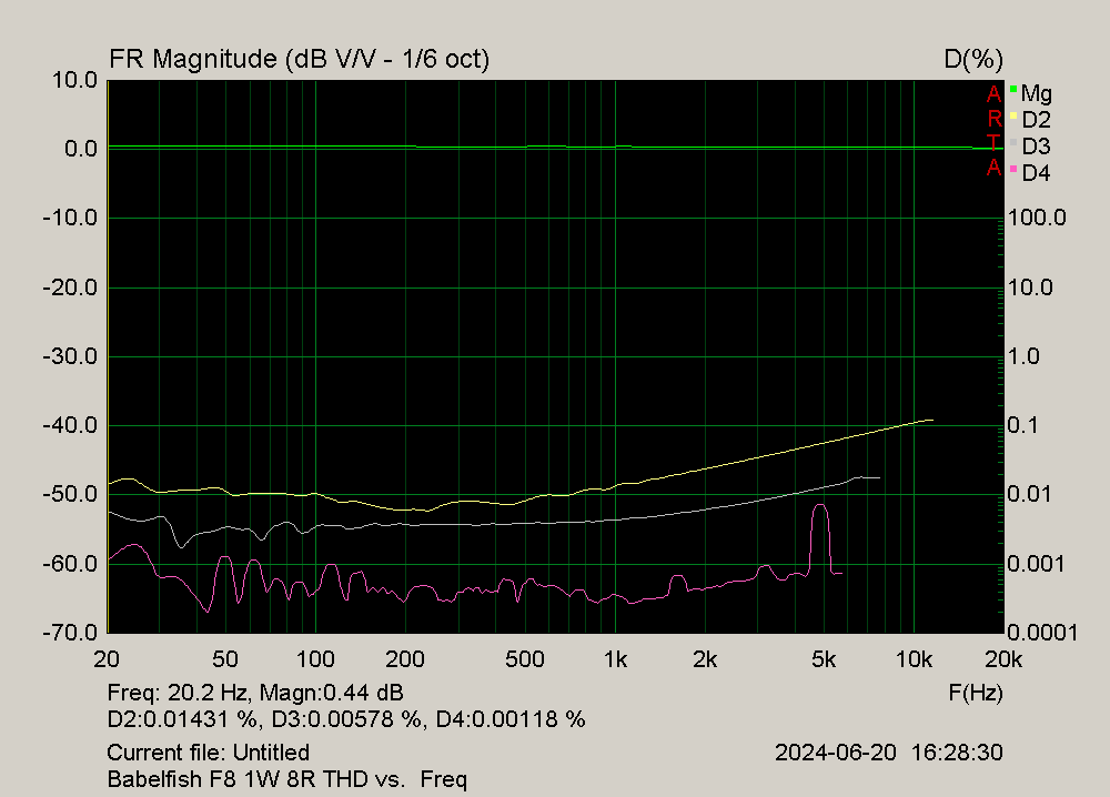

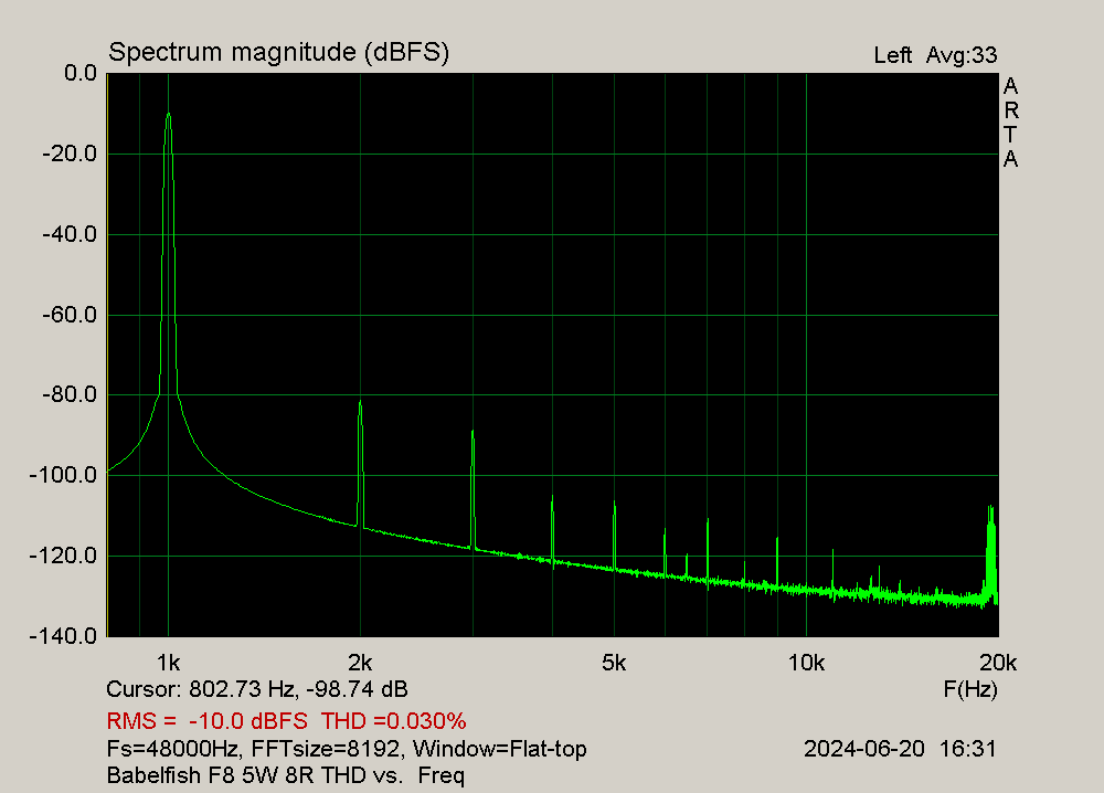

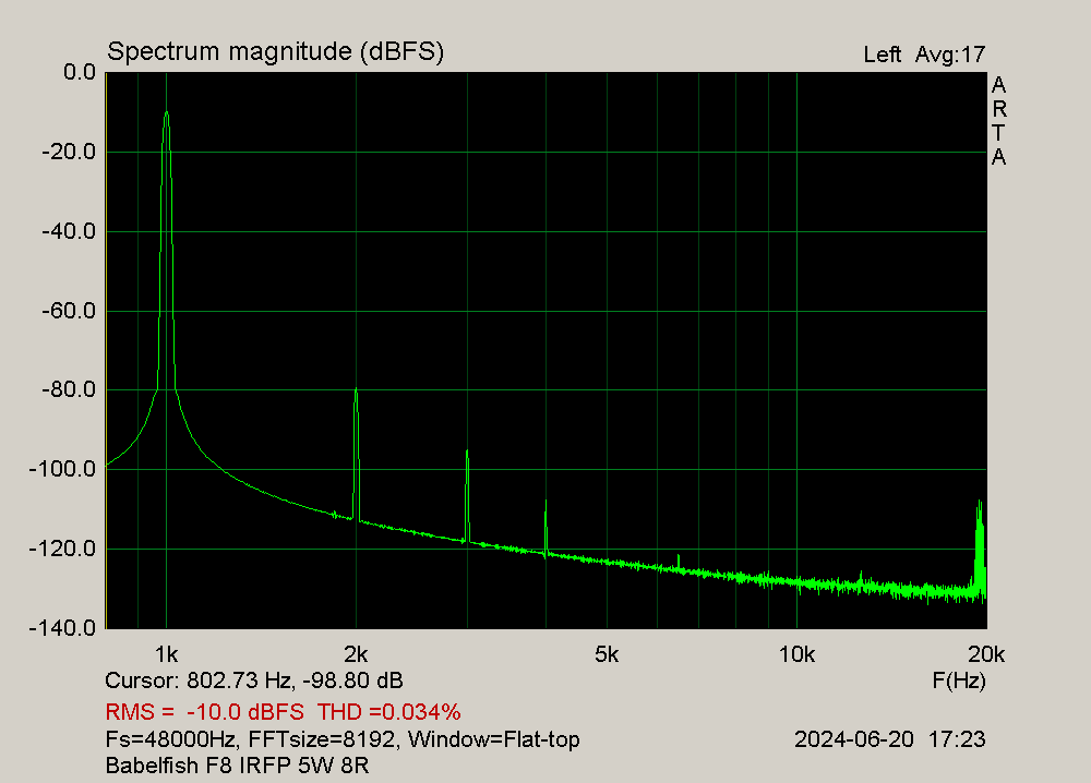

Iq 1A8, regular FW (nominal) 24Vdc rails, 8R Load
Not So Desperate but Rich Greedy Boy iteration, SJEP120R085 down, IRFP150 up

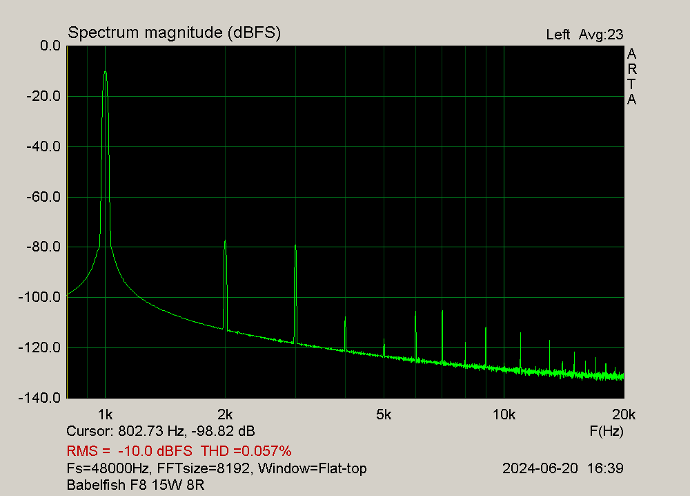

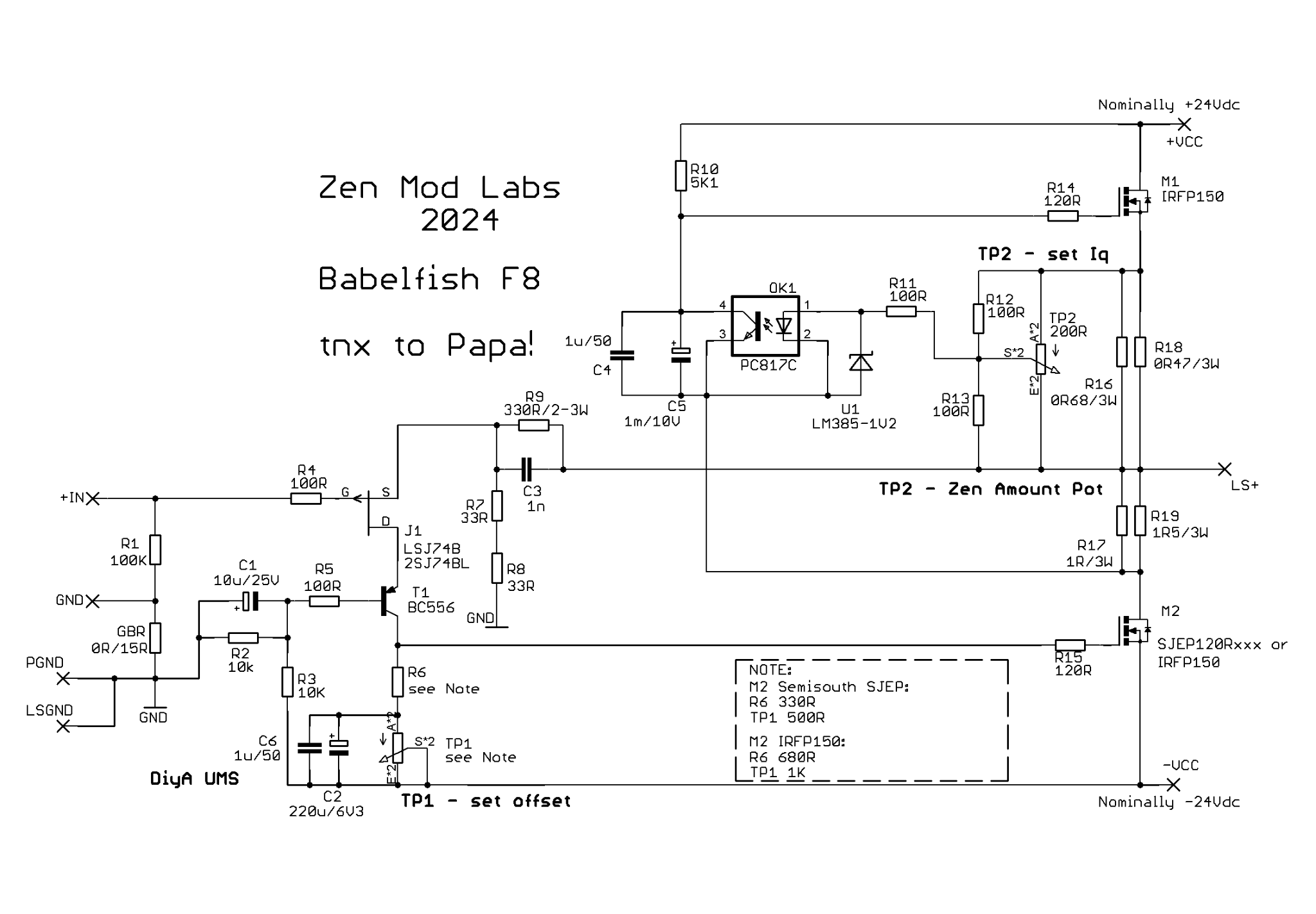

Lazy ZM, forgot to measure Rout/DF ..... but - who cares; see at FW site and slide down (no output cap)
gain is ~ 1V34pp to 8Vpp, meaning ~0V5rms for 1W@8R .......... call it 15.5db

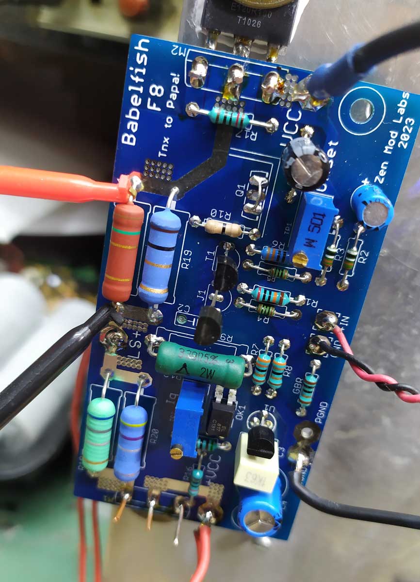

some notes I made:

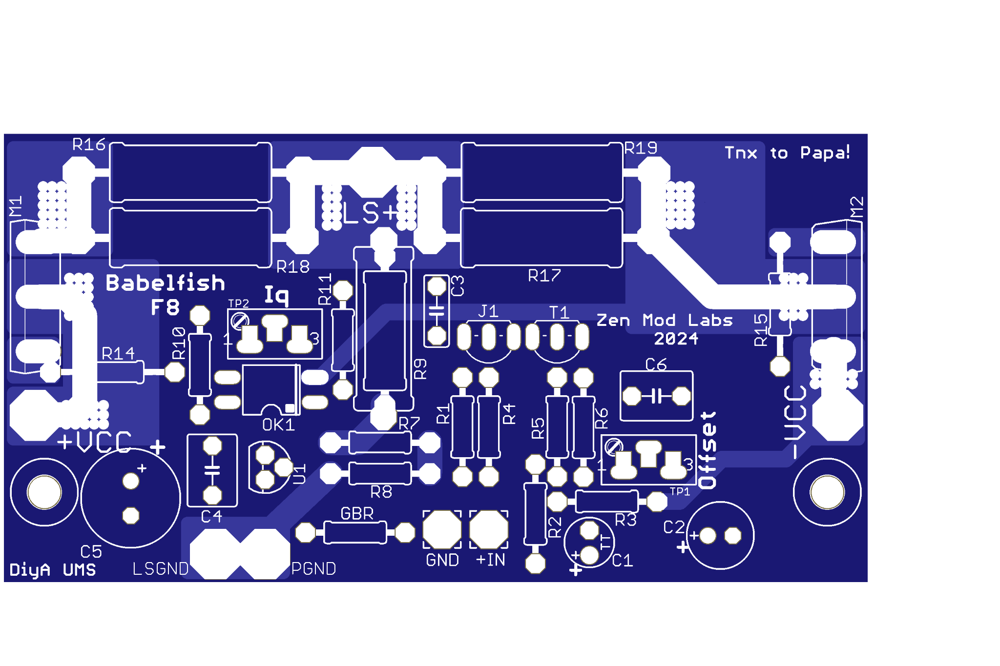

Jun 2024 schm; my setting Iq 1A8 all cases
XXXXXXXXXXXXXXXXXXXXXXXXXXXXXXXXXXXXXXXXXXXXXXXXXXXXXXXXXXXXXXXXXXXXXXXXXXXXXXXXXXXXXXXXXXXXXXXXXXXXXXXXXXXXXXXXXXXXXXXXXXXXXXXXXXXXXXXXXXXXXXXXXXXXXXXXXXXXXXXXXXXX
2SJ74BL Idss 6.5mA
IRFP
drain resistor 680R + 500R trimpot; 680R fixed increased with 330R fixed (fast, instead of changing trimpot for 1K)
Ugs 3V54
U(680+330)=2V65 so I= 2.62mA
Utrimpot=0V91 so 339R
Cold state:
On thump +0V2 non audible
initial offset 200mV
Off thump +1V5 non audible
Hot state:
On thump -0V1 non audible
offset 0
Semisouth
drain resistor 330R
Ugs 1V43
U(330)=0V83 so I= 2.52mA
Utrimpot=0V6 so 238R
Cold state:
On thump -0V2 non audible
initial offset 120mV
Off thump +0V9 non audible
Hot state:
On thump -1V2 slight thump/buzz
offset 0
Off thump +1V non audible
2SJ74BL Idss 8.1mA
IRFP
Ugs 3V5
U(680)=2V37 so I= 3.48mA
Utrimpot=1V13 so 324R
Cold state:
Off thump +2V1 non audible
Hot state:
On thump +2V non audible
offset 0
Off thump -0V17 non audible
Semisouth
drain resistor 330R
Ugs 1V43
U(330)=1V162 so I= 3.52mA
Utrimpot=0V269 so 76R
Cold state:
On thump +1V5 non audible
Hot state:
offset 0
Off thump +1V1 non audible

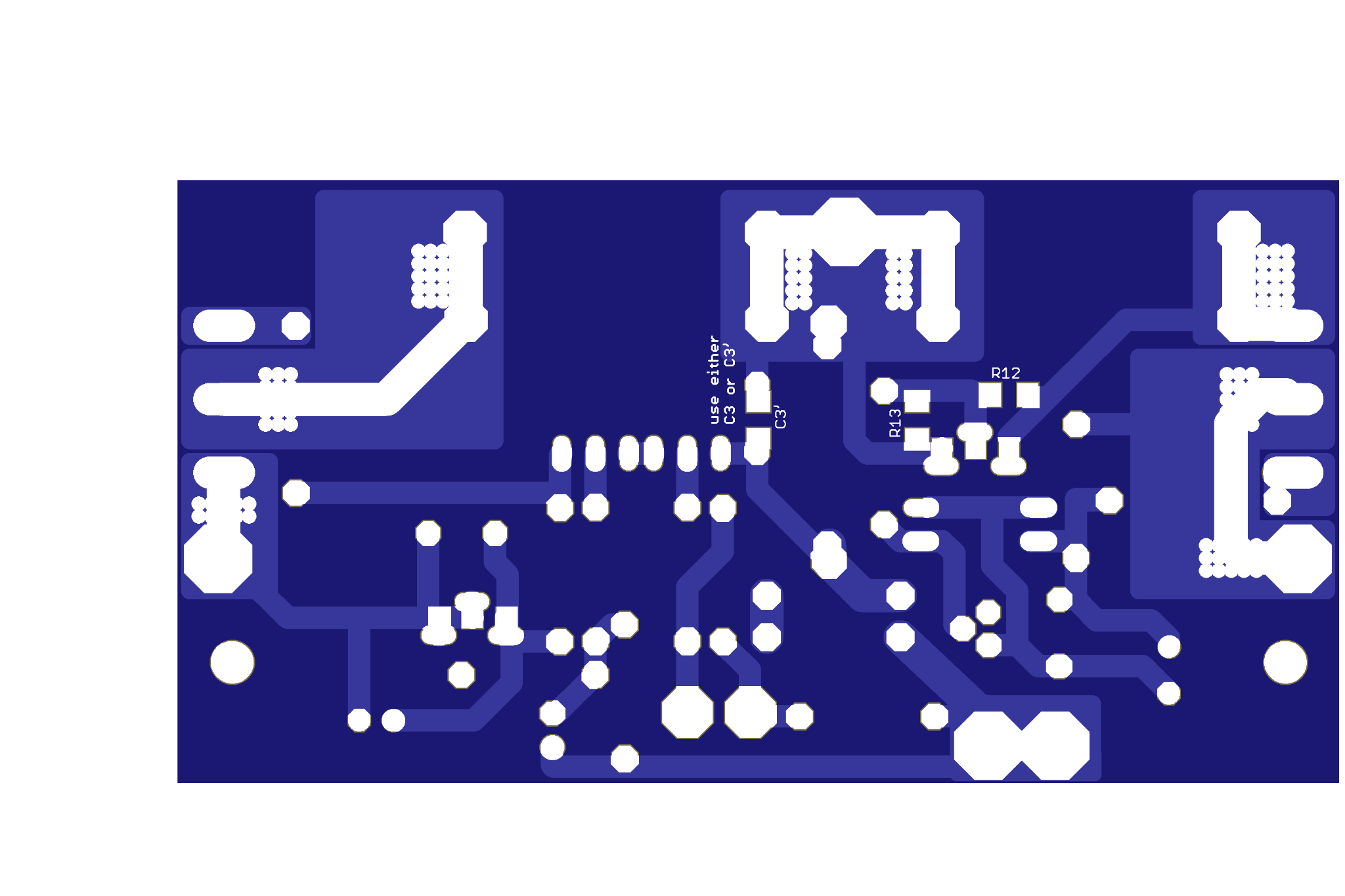

As seen from schm, care taken that OLG stays the same, whatever 2SJ74 Idss used........... and [fixed+trimpot] in JFet drain dimensioned to cover all JFet Idss/output part combinations
Now - I have stash of 2SJ74BL enough to cover 30-40 stereo kits
Schm is yours, go for it
Same as with B. A1 - I'll have full kits (pcbs with all parts, including IRFP outputs) as soon I'm able to organize my impossibletoorganize Mighty MySelf
It'll last as long my stash of BLs I have, will save small amount of 2SJ74V for my own Scrooge purposes
Development of this one was a case of Humbling Mighty ZM; my first intention was to include follower stage in between input JFet drain and output gate, to enable possibility od Schaded arrangement for output part on negative rail ........ but resulting in just too big sum of specific TempCo-s ........ amp really not knowing is it going, or simply going back
Not healthy situation for any speaker on market
You can see details on pics shown, few parts positions not existing on final pcbs
So, that's it - this one tricky to Babelfish, being so simple and not really much to add, without adding more drawbacks than pluses

these really being properly cooled of ........... and I have more of same temperature

In Davis, everything is Glowing in the Dark
Assembled pair of pcbs going to Ca next week
- Babelfish F8
