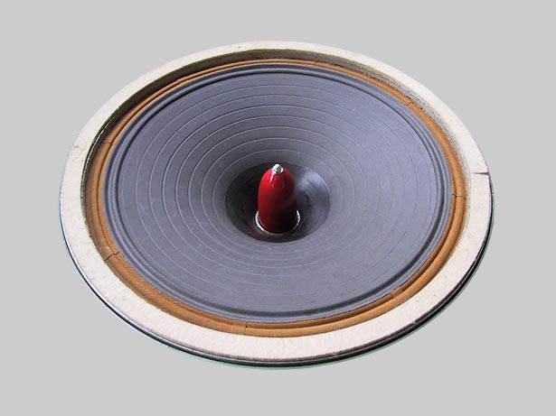

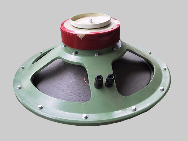

I'm going tomorrow to take pair of these :
:yinyang:

I forget to say in spks related posts- I give 7 pcs of GEC KT66 plus some smaller goodies for them;
I don't need KT66 ,but these spks are pricelles
anyway-mentioned RCA LC1A spks + cabs are for trade in this moment...price- DIRT CHEAP!
but-hey-they are in Serbia....Belgrade....
anyway,if somebody is interested in these antique beauties ,just PM Zoran ....here on DIY.....
