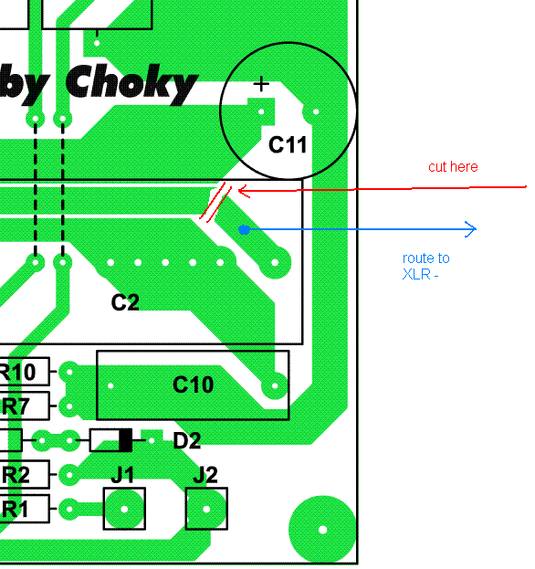

Michael.....there it is
you can omit 470K and switch ,posted in picture attached in post No.294.
in that case you don't need to switch places of 22K and 4U7,and you need shorting plug for XLR (between minus and Gnd) if you use unbal input

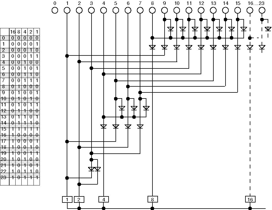

Poor mans volume control
Just an idea:
a rotary switch 16/24 positions + diode matrix, controlling 4/5 relays. On their n.o. contacts, resistors are switched in a designated parallel mode.
So only 1 switch-deck, max 20 relays even for balanced stereo
mode, 20 resistors. Should be enough money left to build a babbelfish.... if its works....🙂)))))
Cheers
Michael

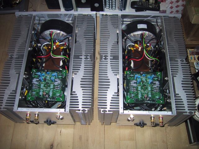

I sure am🙂 Thanks for the kind offer, indeed. No need to hurry or stress your friend Oly. It seems that I have finally got control over my A-X's adjustment. With a little work and some luck they will be hooked up tomorrow🙂 One monoblock working right now.
Here is a pic of the 100 watt monoblocks to spice up this thread a little😀
Steen😎
