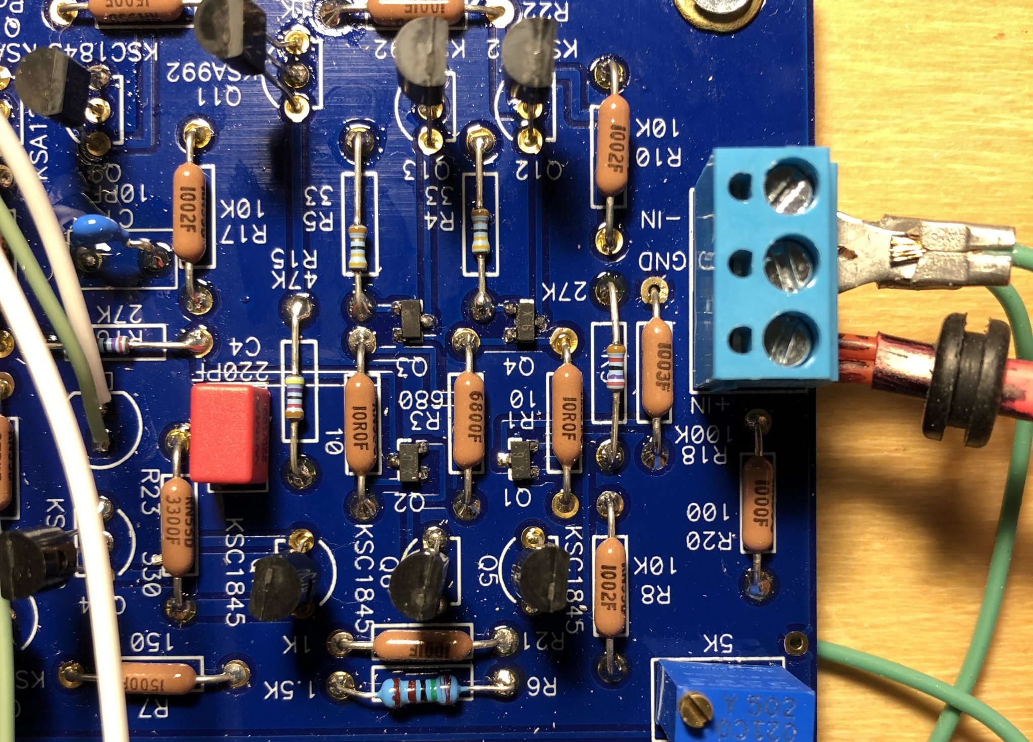

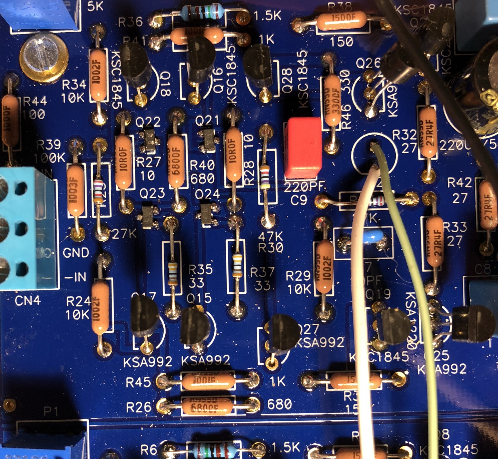

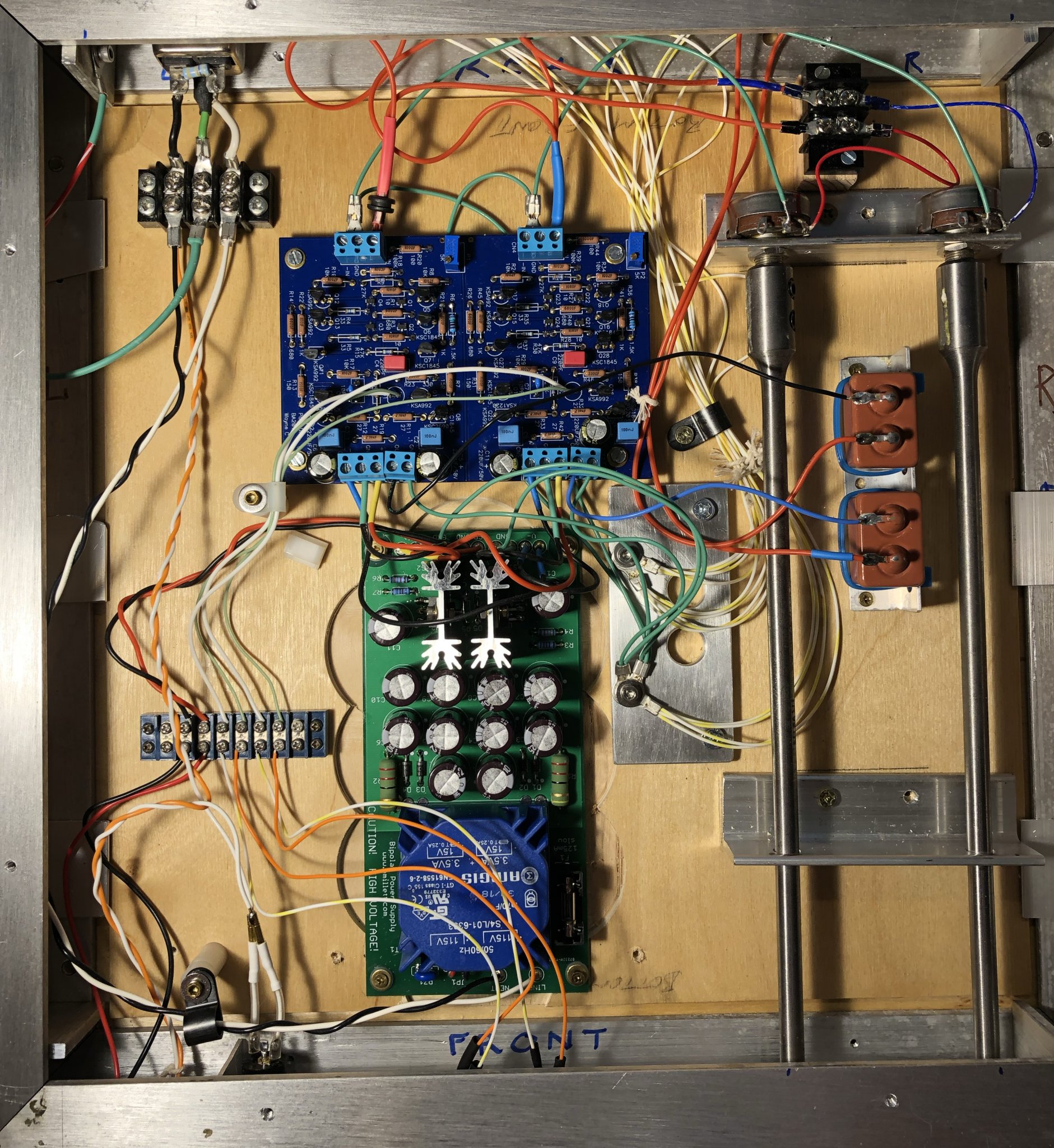

The DAC is NOT adjustable :-(. I did use output caps seen in picture below. I do not see or feel any "goo" on my tiny JDET soldering (see Pics).
Best of all is the formula I need to determine gain! Who Hoo! Now what I seem to need is a clear indication of how to attach a pot for volume control. I am thinking I have done something seriously noob!

Oh Zen, you have sent a college level course to a high school freshman. All I want is a WLS schematic like the one I posted except that it marks the attachment points for a POT to control volume. I get that your calculations say 25k pot for R18 at 100k. That's cool. I can change R18 to 330K and use a 100K pot, that's cool too. I just don't know where to connect wires dude, it's got to be made really simple ;-)
andynor... you are suggesting that I add resistance with a pot BEFORE the circuit... would using a pot/variable resistor in place of R20 fulfill that requirement?
No, I just missed the whole pic and misunderstood your wiring completely. Please disregard, I tried to delete but too late.
you are getting good help, but two observations:
1: the boards LED’s are extended quite long. These are a part of the boards biasing circuit. I am not sure mounting them off board is wise, as DCR will increase as well as inductance maybe being added. Also: sure you have the correct Lite-On LED’s? Guessing you do.
2: Is the DC offset unstable? Is the offset affected when you turn the volume pot? If so: I recommend checking all JFETs are working as they should. Checking resistance between the JFET legs and the next point on the PCB/next resistor leg etc, will tell a great deal about whether the seemingly good solder job works as good as it looks 🙂
