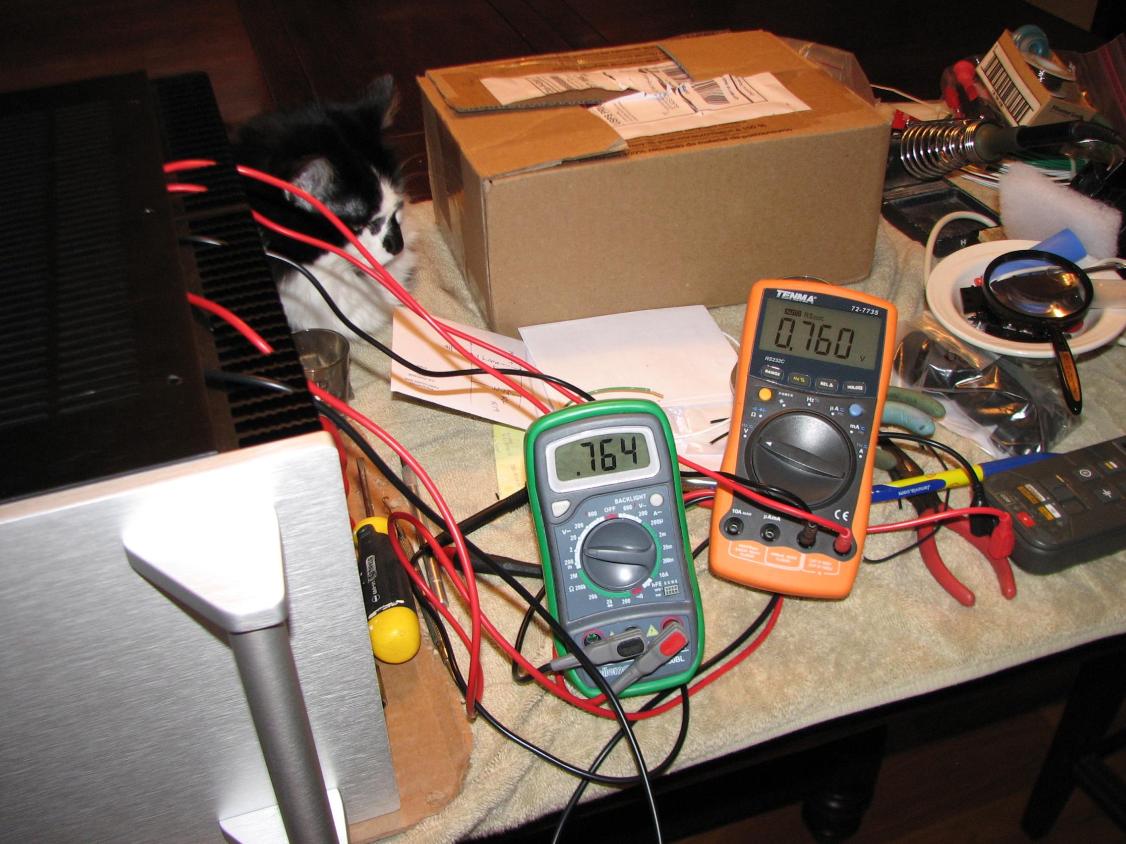

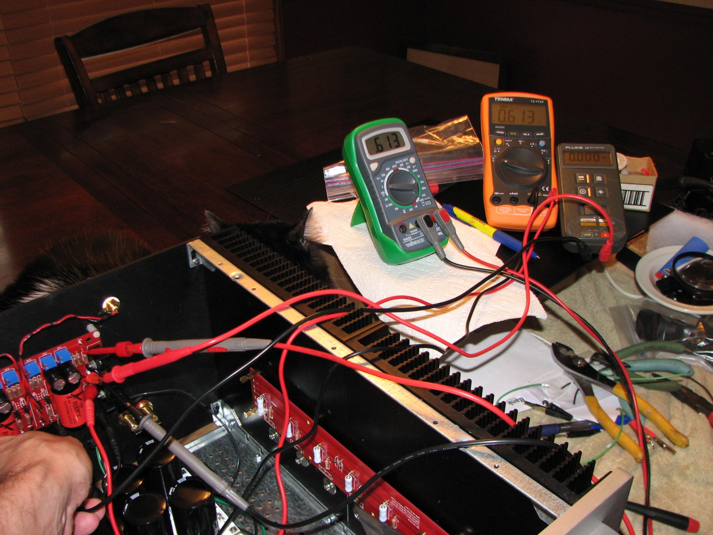

Front end board biased up to .780 Vdc now or so, slowly crept up from .750 once I put the lid on and let it cook a bit. The last BA-3 board I biased up stopped around low .780s. Once this happens I will power down, wire the out put boards to it and go at it again biasing them up and setting offset. Let the whole mess cook an hour, reset everything and assuming all is well, put it in the system for a trial run!
