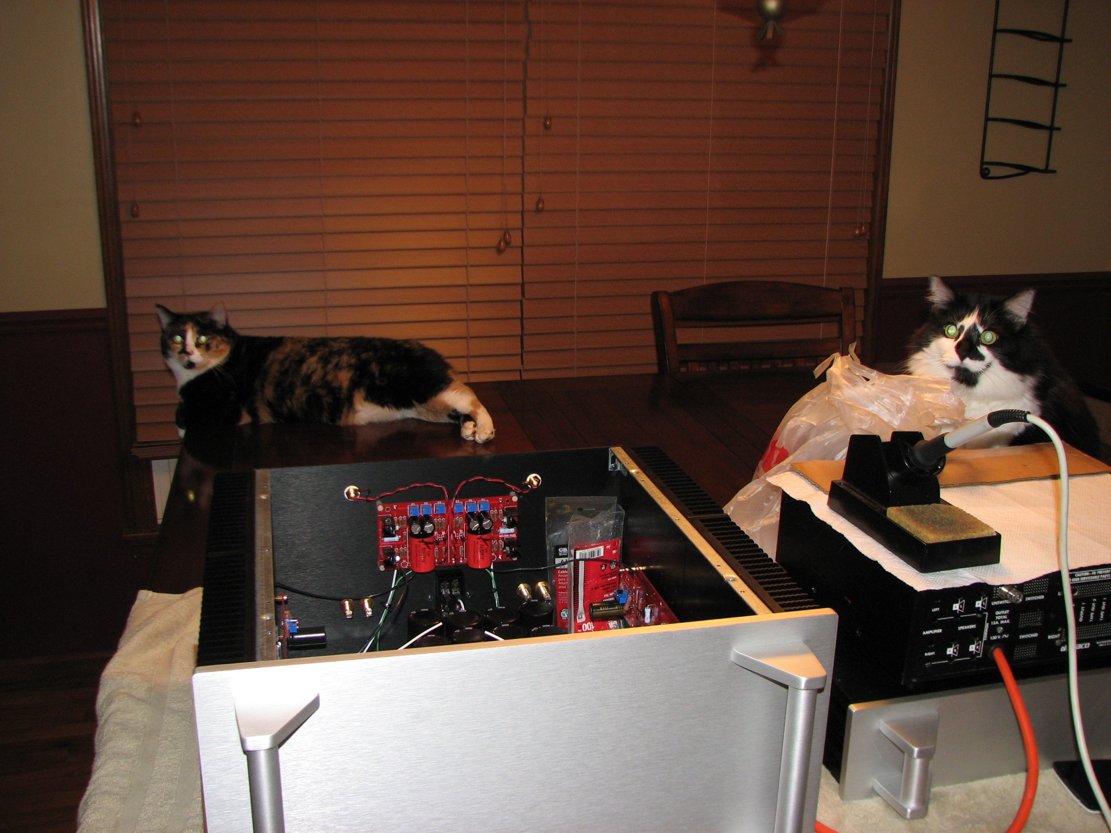

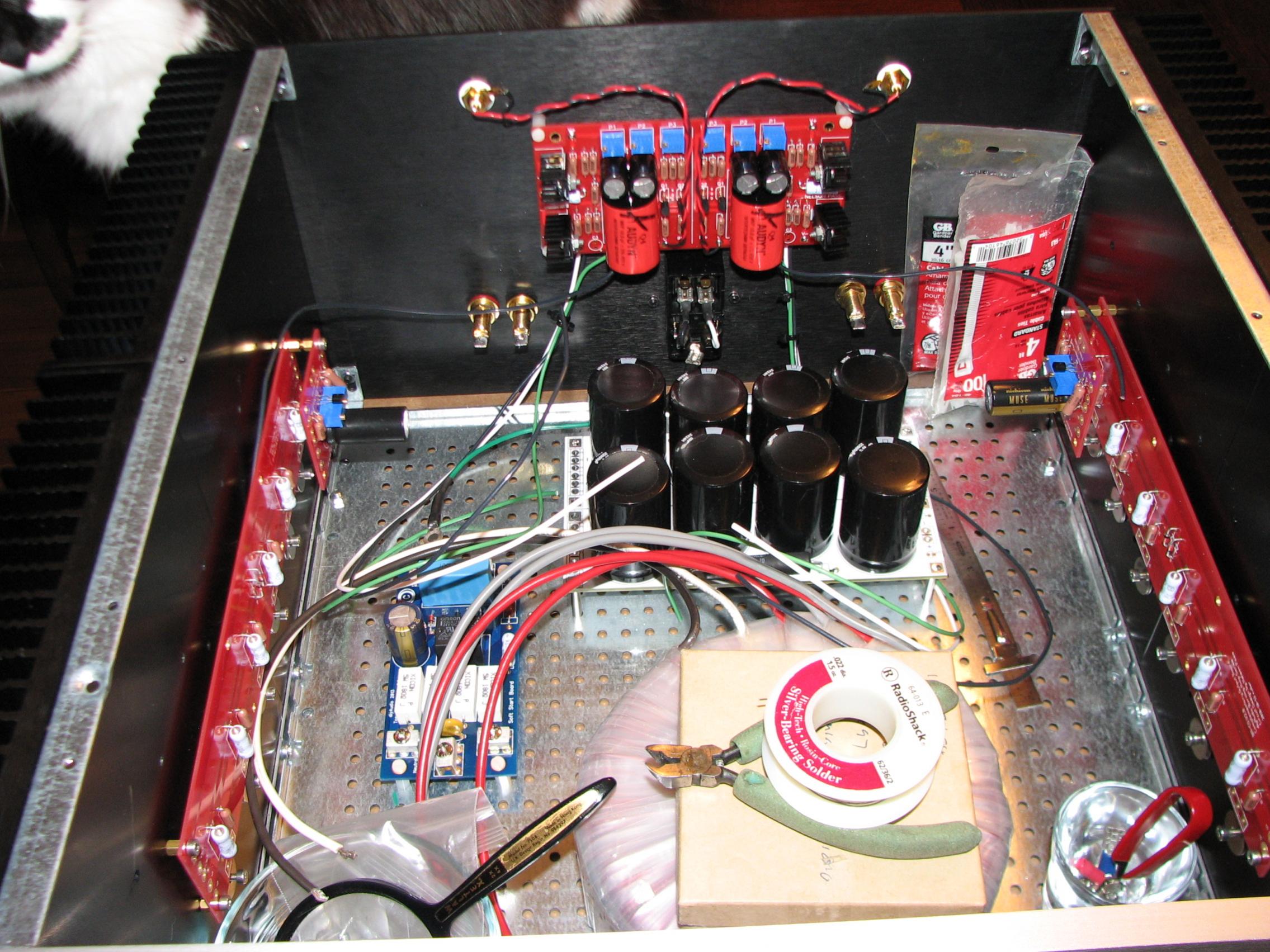

Last night I finished assembling my just arrived BA-3 board, drilling the Deluxe U5 rear panel to mount the BA-3 board as 6L6 did in this build thread. Also got stand offs to mount power supply to floor, as well as newly arrive soft start board (now assembled) mounted to floor w/ stand offs. Wiring of power supply to out put boards...bias boards also mounted as in 6L6 build, signal wiring and then fireup soon....too many projects at once!

Really wanted to fireup at least the front end today, but doesnt look that way. I'm going to have to get some sinks for the rectifiers. I really dont want to attach them to the floor like I did with my F-5. Standing up, like 6L6 has his also takes up less floor space.
