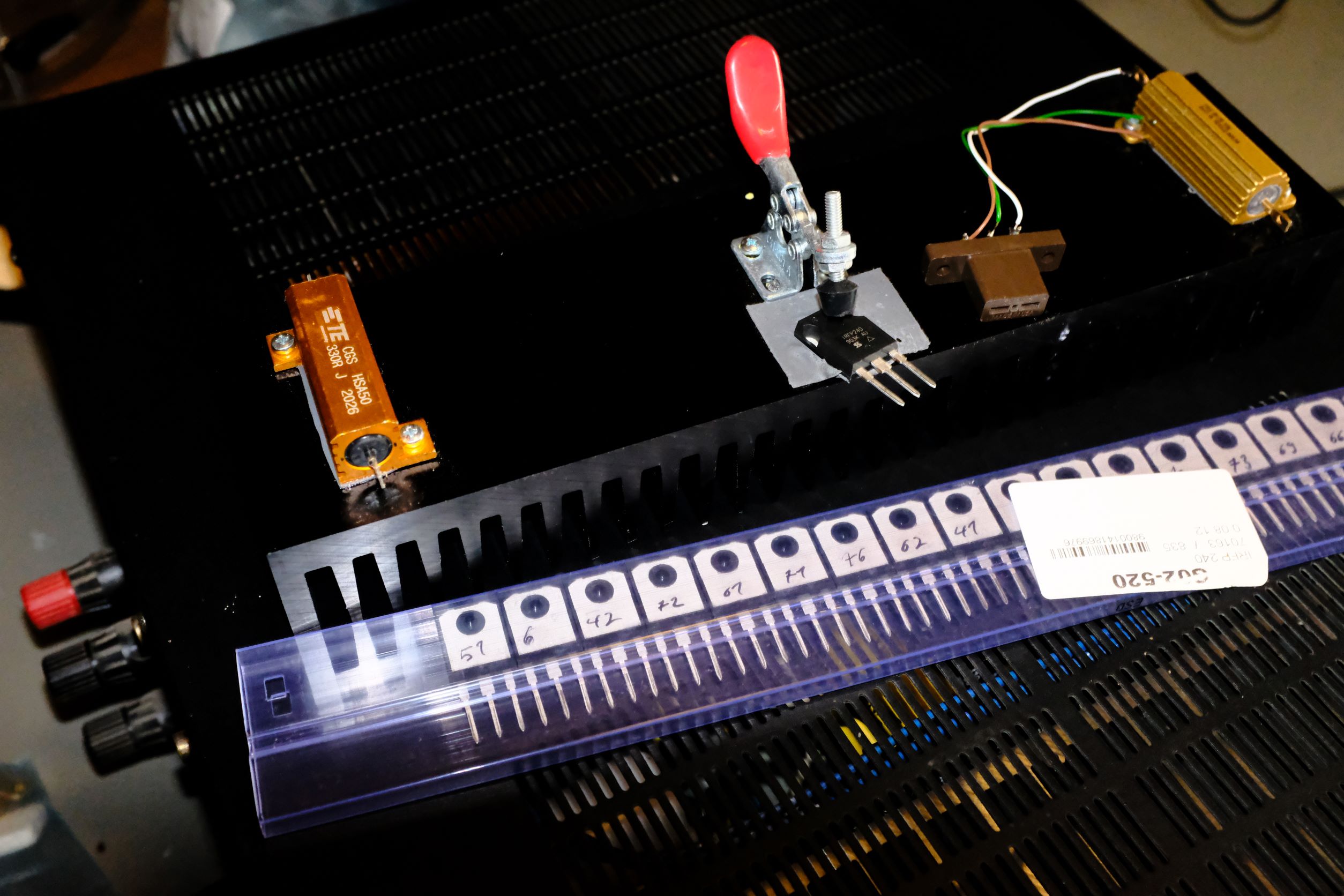

You might also consider matching them yourself. The parts are cheap like dirt and its a skill worth having. Less worry you might actually fry your output transistors. I needed 24 N and P devices each, so I went that route and have plenty left-overs for the same money.
Socket:
Blocked
I needed some support for the socket, so no stress was on the part for most precise results.
I used these resistors:
https://www.mouser.de/ProductDetail...qLThgwXRvQhqX5gaJ/BWT9RNlzgVqL3NMZrHd4K/5kg==
Have fun
