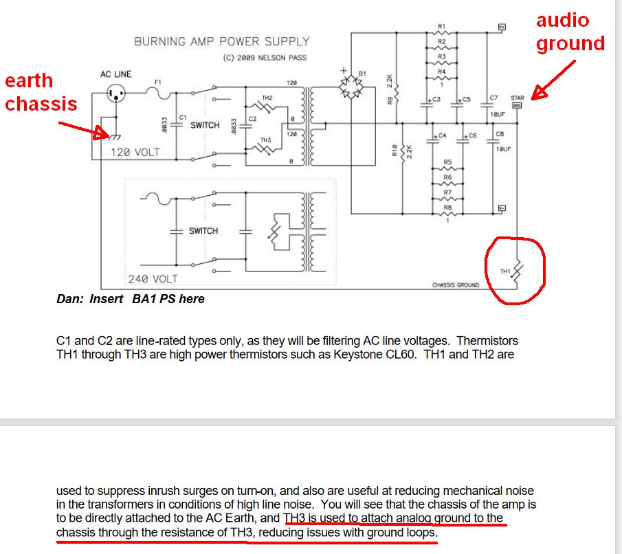

Hello Andy,
I make my connections the same way like you did - one exception:
I go from mid PSU (0 V = audio ground) over the groundloopbreaker
(35A bridgerectifier+CL60) to IEC-inlet ground/case.
So, my audioground is slightly floating.
I have added a sketch....:confused:
Don't ask me if this is the right way???
Greets
Dirk

Good morning, Dirk!
I will check that one out. I am currently reading and rereading Bonsais article on the subject:
http://hifisonix.com/wordpress/wp-content/uploads/2019/02/Ground-Loops.pdf
As I see it, my NTC to chassis does that job for me right now. Mostly, I am just curious on the physics behond the extra rectifier. Maybe try it? =)
However, since my hum does not go away when i connect the amp to an ungrounded outlet, I believe the error is elsewhere, like you expressed might be the case. I am currently thinking it is either a cross channel loop, capacative coupling between secondaries and primaries of the tranny, or a common impedance loop. I will in time try to falsify those hypothesis. But will still explore improving my gnd scheme.

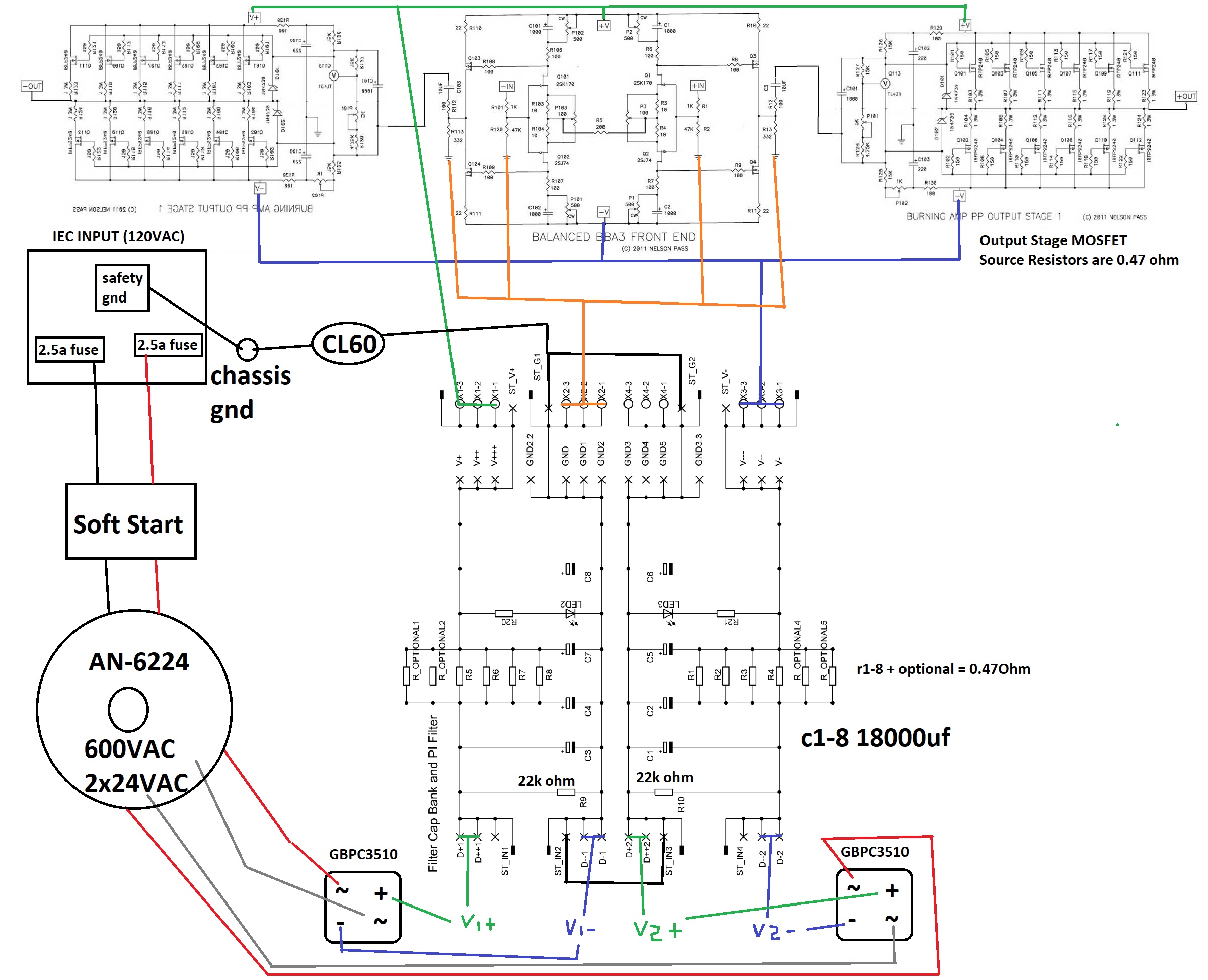

first thing - what kind of speaker protection circuit you are using - it must be made for balanced amp (sense side ground-free)
second - with so much wires flying everywhere, my mind would go motorboating, let alone amp itself
third - post exact schematic you're using, just so we are all on the same page
I was using the diyaudio store speaker protection circuit with the 24v relays. I have now removed it from the chain until I can do more reading about how to re-work it for balanced operation.
Should the DC power wires not be twisted?
Schematic uploaded!
Sorry for the delay I got busy with the holiday!

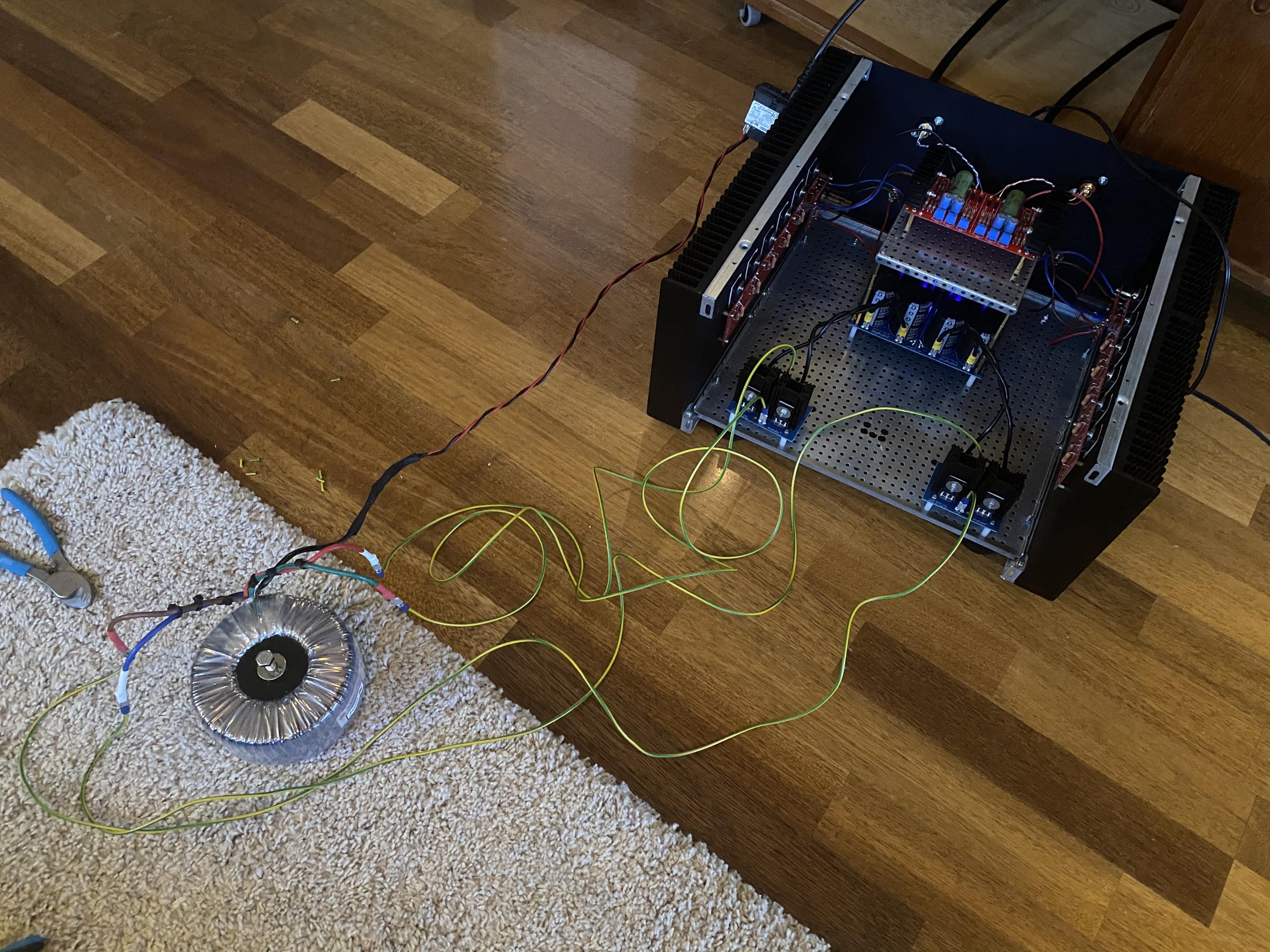

Greetings, Bonsai!
I finally had some time to perform the tests. I believe I have a preliminary conclusion, which in any case will require some guidance.
Results/comments in same order as you described:
NB: all tests done with transformer out of chassis. There was no change in hum or noise levels with or without shorted inputs taking the transformer out, and twisting huge gauge interconnects between rectifier and PSU.
1: Done
2: Only unreadably high resistances measured between 0v and chassis, and signal return and chassis with NTC decoupled. Same goes for speaker returns. Conclusion: No ground loop there.
3: shorted inputs, and still the same hum. Only difference with shorted inputs, is less hf background noise. Conclusion (preliminary): I probably have a common impedance issue.
4: I performed this test even though test 3 was positive. Test 4, inputs connected together with one RCA cable, actually increased hum. Also, there was a little bit increased hf noise.
5: this chassis back plate have pre-drilled holes for Neutriks, and the inputs are therefore on opposite sides. So I probably have some cross channel looping, but doubt that is the main problem, since it persists completely regardless of transformer being in or out of chassis.
6: Taking the transformer out and moving it several feet away, provided no change what so ever.
7: Ground lifter against AC loops will not solve my main issue anyways, so I’ll wait.
Conclusions (preliminary):
1: I have a probable common impedance loop. It is possibly exacerbated by a mild cross channel loop.
What in my amp can be causing this? I have some hypotheses, but not sure how good they are:
1: Long interconnects from rectifiers, and using quick connects instead of on board soldering, increases impedance and exacerbates the problem.
2: I have three (3!!) junctions between neg and pos cap bank 0volts at the star point (visible in pic on post 585). In yours and others articles, it is specifically said there should be only one such junction connection.
3: my NTC is connected at this point, but my other ground connections are an inch or two away, on the neg 0v side of the PCB. Plus one of the speaker returns on the other.
4: The lengths of the GND return wires from the gain stage, are of minutely different lengths.
5: Input wires are not shielded.
What do you think is / are my problem(s)? Is it my star or T arrangement messing it up? Is it a combo? Is the tranny still a possible culprit (cap coupling pri/sec), or is that now completely ruled out?
So I plan to do the following, but need to know if the plan is good:
1: Move rectifiers close to the PSU pcbs, and solder connections.
2: Solder trannys to rectifiers
3: Remove all but one junction between cap bank 0v’s. But is one small 16-20 AWG wire thick enough for that connection?
4: Redo general grounding scheme at the star. But it is quite the same as 6L6s in post 1, except for him having 3 junction connections at the rectifier input side of the PCB, and only one at the star side.
5: cut gain stage returns to equal lengths. Also, decrease wire gauge to gain stage from 16awg to half. It does not require much power, and cables are now so thick they are a hassle to twist and work with (solder and so on).
6: Redo/perfect the rest of the wiring, twisting it all properly. Wiring right now is preliminary as I ame testing things to get rid of this hum. But even when wires were twisted and mor properly done, the hum was there nonetheless. But might help other more hf issues though.
7: Move gain stage/FE to back plate, to as far as possible do this the same way 6L6 did. Not expecting change in hum
8: flip heatsinks. Not expecting change in jum
I want to repeat one important thing: The only test that had provided change in hum levels, is moving FE returns to different grounding points.
This was a lot of text, and I am sorry for that. I have attached a photo of the testing sequence.
Andreas

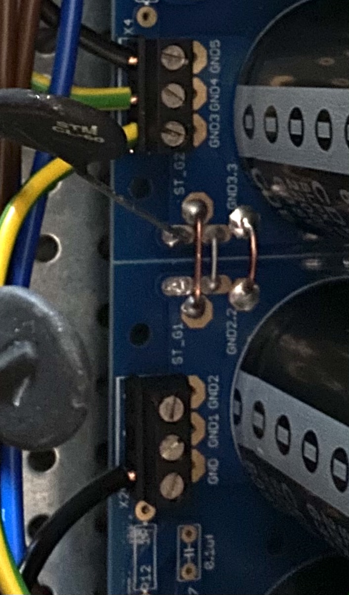

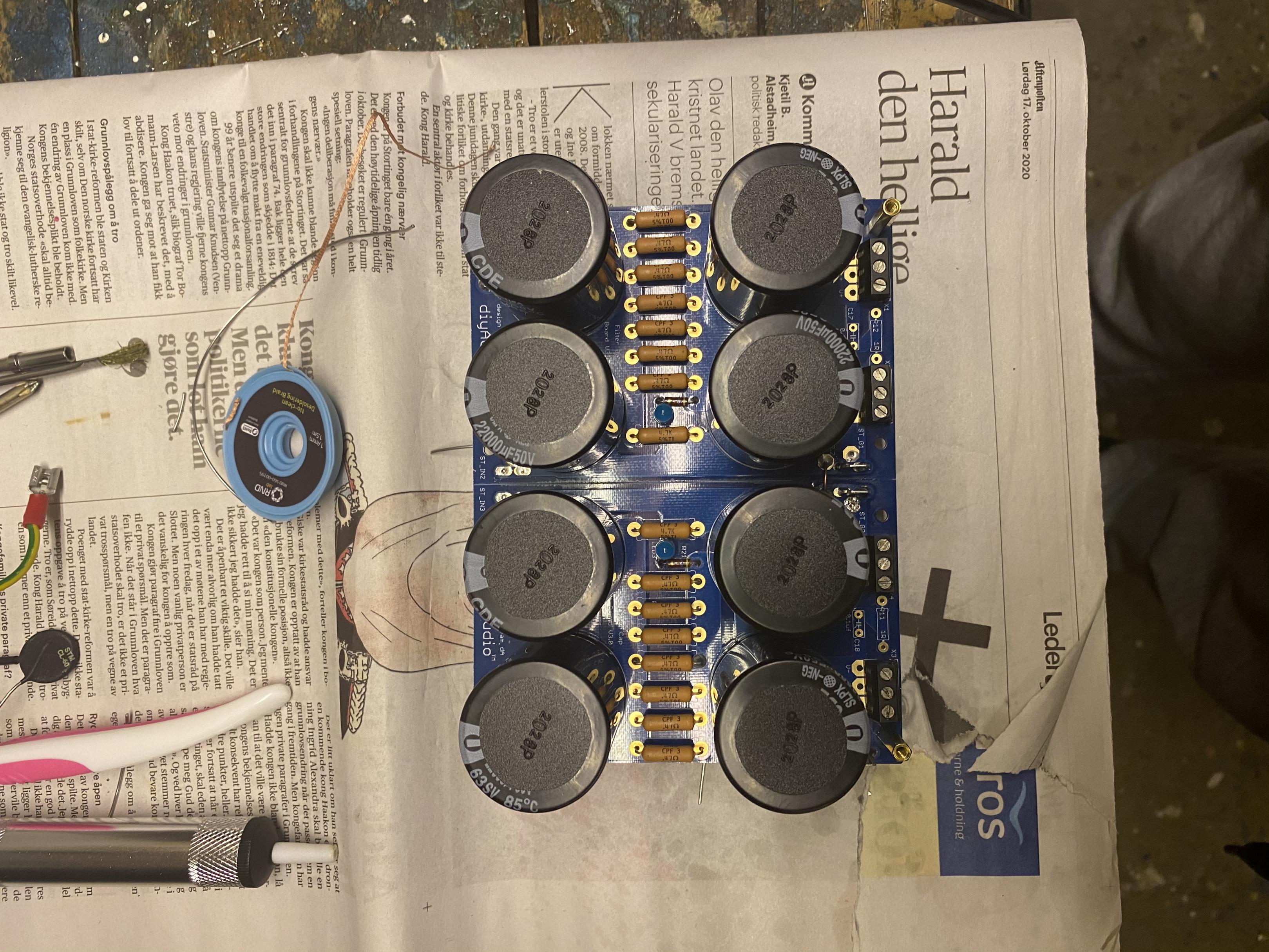

Bonsai:
Here are two pictures.
1: Here are the 0 volt connections as they used to be, the quietest I could manage. The black cables are speaker returns. The green/yellow are the front end grounds/returns. In the middle, you see three jumpers/links, creating the junction between neg and pos 0v sides of the PSU. They are not pre-linked.
2: This is the PSU as of now. I have removed two of the links, to ensure only one junction. I have added quick connect terminals for ease of testing and flexibility. This now looks like the one in the PSU build guide.
Notice that there are two possible places to link / make junctions between pos/neg 0 volts: one by the output (the one I use right now), and one at the opposite end, the end where secondaries connect. I removed those three links as a test, but there was no change in hum or noise in removing them.
Like I said, I am redoing some of the PSU, and wonder if I should reconnect the links at the opposite, or leave them out. 6L6 uses them, so that is my answer, really. But readig your article, one junction point is max, so I am as usual a bit at a loss.
On the board, you see two points for star gnd, one on each side. I have soldered euroblocks there. What I am wondering, is if using the newly soldered quick connectors will enable me to make a T ground or not. And if so, can I stack all the cables into one connect, or not. This board makes it a bit difficult to follow your golden recipe for which wire to connect the closest to the junction and so on, or so I gather at least.
Andreas
