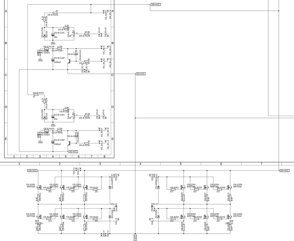

Hello,
6 months later i reached finally the output stage biasing step... and I failed:
I need some help setting up the output stage of the single ended burning amplifier.
I power up the gain stage with 30VDC and output stage with 25VDC
(the gain stage is Ba 3 and output stage is Ba 1 specified the schematic a bit lower)
The gain stage is properly biased at 600mv or so and fairly adjusted offset (5-10mA or so).
I used a C3 = 100uF as coupling cap to the output stage so that DC cant contribute.
My issue is that i can not adjust the ofset close to 0 to make the amplifier usable without output capacitor (nothing changes when turning the trimpot P101)
I thought the Mosfets are fried...they're not: (uding the supply set @12V 400mA i connected gate+drain +12V and Source -12V remaining a drop of about 4V)
The offset is rather big... 5-10V measured from output to ground
... i wanted to know if it works even so.... i hooked up a 1000uF output capacitor and it plays music ok.
The ztx450 B->C voltage is about 8,8V
The channel eats up 3-4A from the output stage power supply.
I used this schematic we discussed a while back here post #29

0V57 across source resistors means around 1A2 Iq
positive offset means that lower mosfets aren't opened enough , so you need to increase Ugs (biasing) for that group
confirm that you have ~10V across all zener diodes and , if that's the case - change trimpots for lower half biasing to 5K ...... with 1K you can't reach 4V5 to 5V of needed Ugs
rebias everything carefully and that's it

Checked... The phisically installed trimpots are 5k ... i've checked .... thats a nice spotted typo on the second channel. I have to mention i populated mosfets only on the Q20x side just to be on the safe side and be able to power up safely one chanel at the time.
I will re measure exactly, and add those values on the schematic and come back.
My biggest concern is the intermittent crackling and sudden drop of power consumption... (i tested diodes, bjt and mosfets ....they all work fine out of the circuit )
voltage across zeners?
I was clumsy , writing previous post ..... lower mosfets are biased through/with transistor sensing voltage across source resistor ; which means they're set automatically , while you need to close upper mosfets , if you have positive offset on output

Hello ; excuse the delay,
I added the measurements i took to the schematic : BA3+BA3SE.png - Google Drive
open dedicated thread , post proper pictures and relevant schematics
confirm with measurements that you have established proper rail voltages
I'm frankly totally confused with measurement points and values , you gave in that link

I solved the issue ; sorry for the confusion Zen!open dedicated thread , post proper pictures and relevant schematics
The issue was an improper idc connector to the bias board that simply did not open the supply mosfets.
I am now at the lasthump ; setting offset ..... i reach the end of P101 ; the offset does not reach 0 it stays at best@ 400 ma so i guess il have to increase R127
