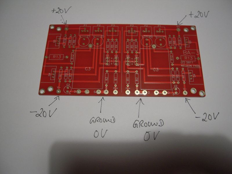

The pic shows how the voltages should look like.
Is this the pcb you have used?
Greets
Dirk

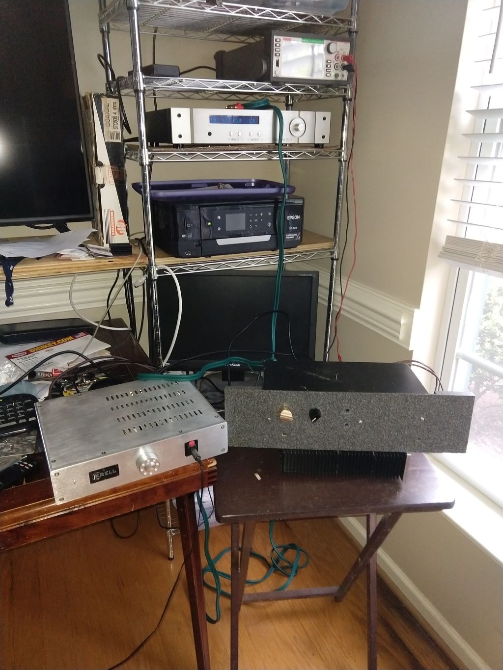

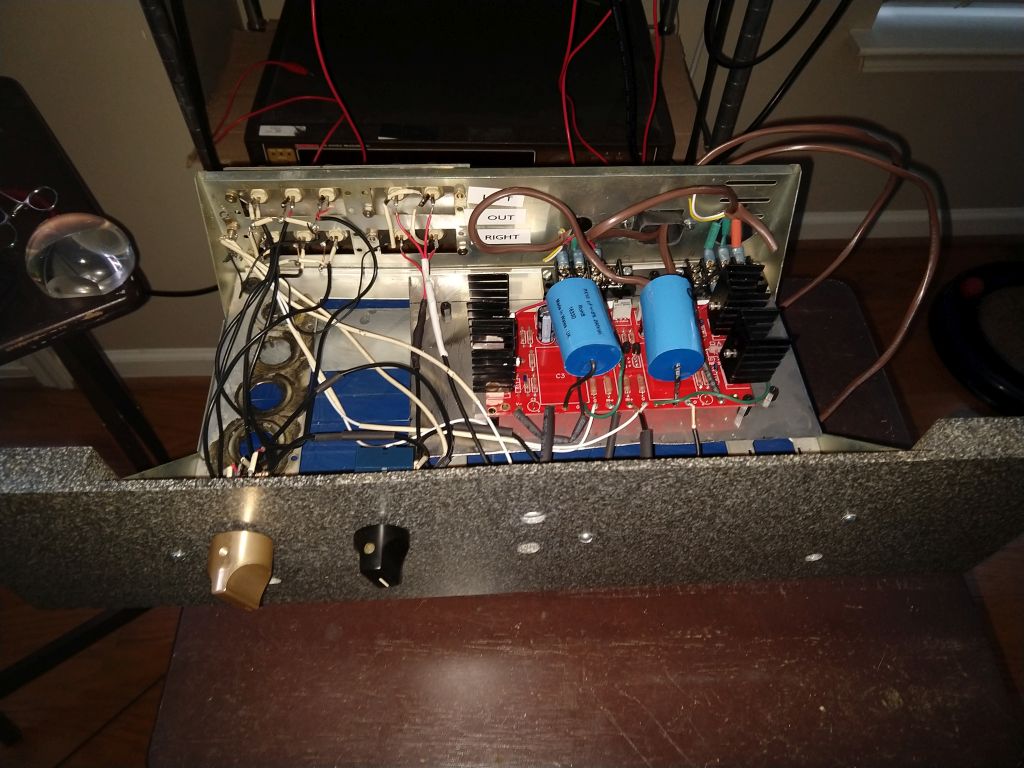

Here is a BA3 preamp that I built for an 82-year audiophile who can no longer solder.
The JFETs were acquired from Punkydawgs and the MOSFETs were acquired from a forum member.
The gain is just about exactly 10. undistorted pk-pk output output is about 30v.
The second picture is the BA3 being listened to. The signal chain is
Television -> PL XA2.5 -> BA3 pre -> Zen V4 headphone amp -> headphones
Amazingly quiet having two unnecessary preamps in the chain. Sounds great.
I will be delivering the BA3 pre on Monday of next week.
We will listen to the BA3 through his Seas 3-way system that he built. He custom voices the crossover himself. He was a LEAP/LMS expert back in the day.
