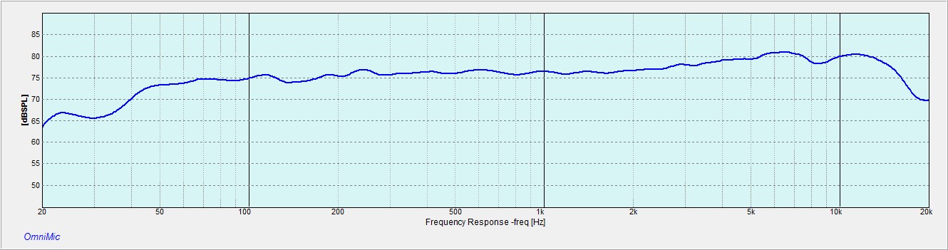

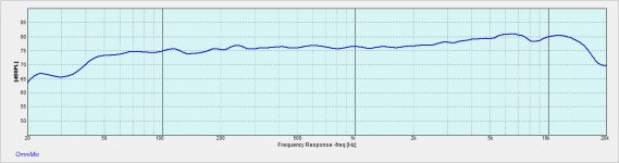

Just by getting rid of the crappy inductors I have managed to get a significant improvement in efficiency.
I will work on the crossover now

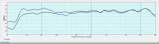

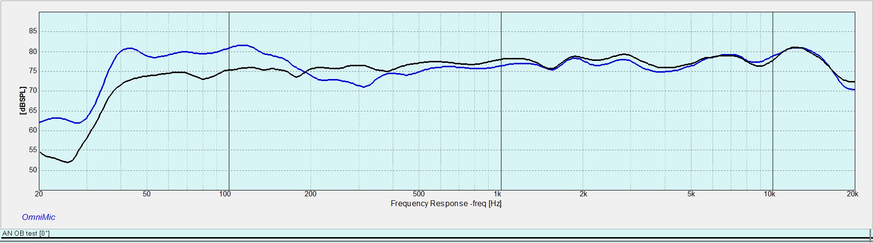

Black is the old passive crossover and Blue is the initial response with inductors removed
Dave at Planet 10 says he likes only 3dB of baffle step vs 6 often used. Cant remeber if it is built in with B5?
Guess what?
I hate BSC by attenuation. It sucks all the air and clarity out of the music.
I am finding it sounds much better by correcting with gain using a DEQ or .5 way or just play with the baffle dimensions etc
Don't ask me why it sounds better. I have no idea. It just sounds significantly better
That would be a misquote. 6 dB is very often too much because speakers usually interact with the room (room gain etc). I rarely use an BS EQ.
