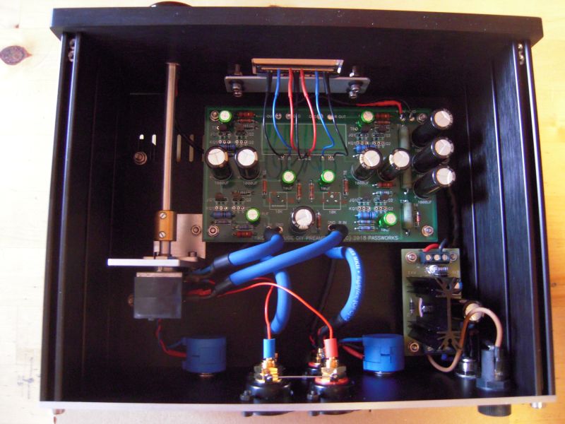

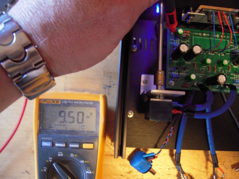

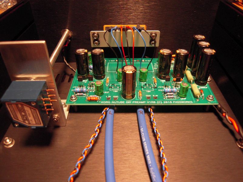

Hello Meper,
nice to hear from you again!

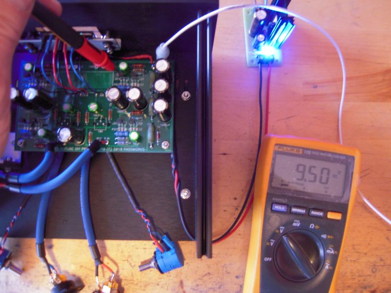

The adjustment pots are connected. I did not use the pots on the pcb. I wired it
to the backplate pots to adjust also if the case is closed. The wires are underside of the pcb.
I used BOURNS 10kohm precision trimpots (10 turns). Makes exact adjustments easy. But I forgot to make a connection from T7/T8 to the outside of the case.
So, to measure I have to open the case again. Or I have to count the amount of
turns (sure not that exact).
In my combination at the moment with the BA-3 poweramp - the B1 Nutube drives the BA-3 with ease.
But I use a easy to drive loudspeaker (4 Ohm, 91dB/W/m, 2-way d'appolito) and
my BA-3 is running close to the edge (+/-34.9V rail voltage, BA-3 gain stage and BA-3 complementary output board). In the gain stage I use original TOSHIBA JFETs from punkydawgs. They run hot!).
Greets
Dirk

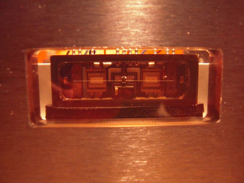

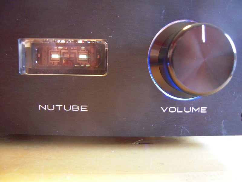

answer to jwjarch #1967

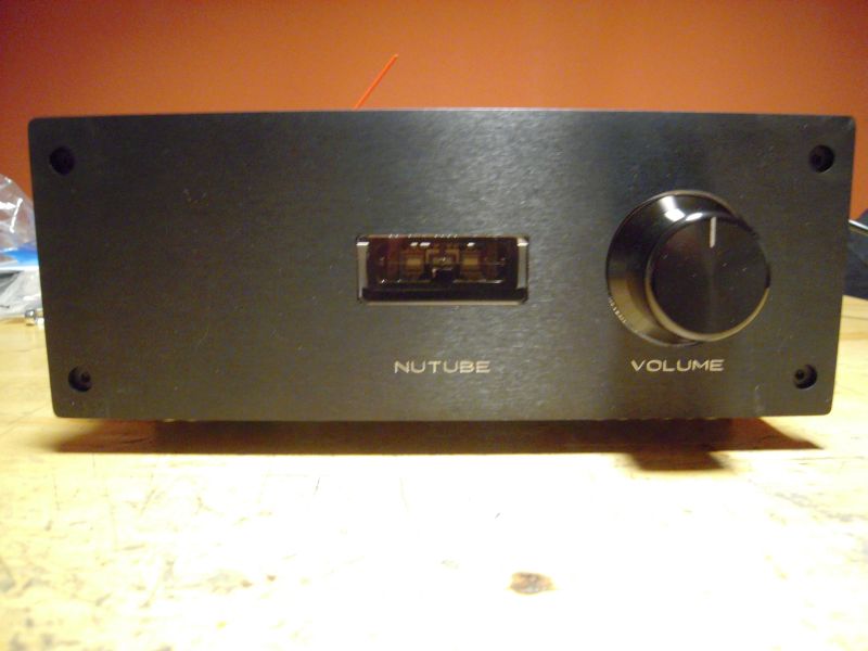

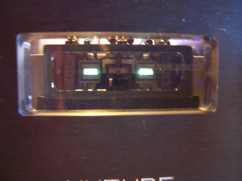

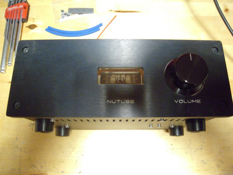

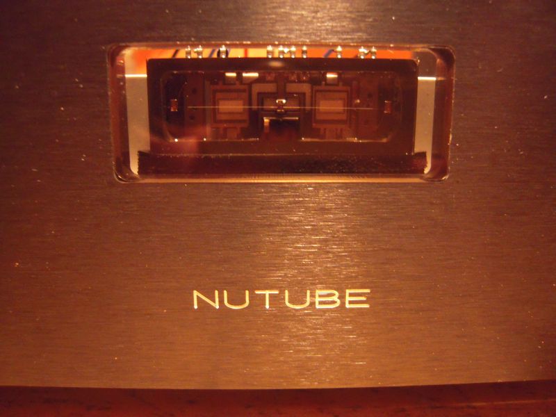

Some pics from the 'glowing' or 'burning' front. :flame:
(I have posted a few pics from the front before in this thread - but no problem)
Greets
Dirk

to MEPER #1944
Hello MEPER,
speakers are connected inverted.
Setting T7/T8 at around 9.5V is the recomendation from Nelson Pass article as a starting point:
After a few minutes and no smoke, we adjust the T7 and T8 voltages as follows:Voltage at 12 VDC is approximately the 2nd harmonic null point where we get about .3 %distortion in 3rd harmonics. As we go lower we start getting positive phase 2nd harmonic, and itwill hit 1.5% at 1 volt AC output with about 9.5 VDC on the T7 or T8 test points. Voltages higher will give negative phase second harmonic.This is a reasonable calibration - 0.1V either way changes the distortion by about 0.1%Clockwise on the pot from the null spot makes for less Plate voltage, and positive phase second harmonic, counterclockwise makes for more negative phase second harmonic.If you have a distortion analyzer which gives you the percentage but not the phase, then just start out with the Plate voltage high (CCW pot) and turn it clockwise to the point where it is minimum, and then go further for + phase, or back up for - phase.The reference setting for this project, are 9.5V on T7 and T8, which gives a positive phase at about 1.5% at 1 volt output. You are free to set it elsewhere.
Greets
Dirk

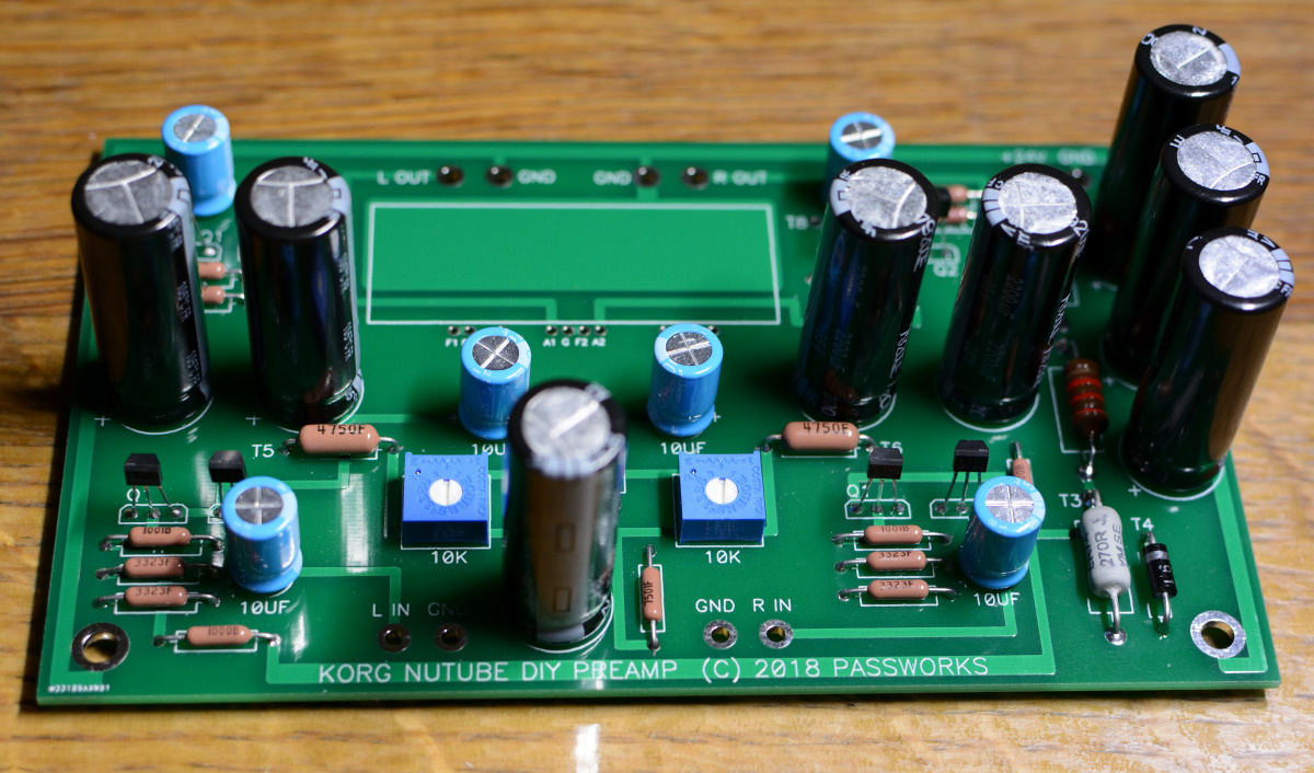

This is so far my Korg build came this afternoon. Still missing an important component.
Instead of the 2x10R in the RCRC filter I have installed 2.2 mH ferrite chokes that can handle 150 mA or so and has DC resistance of 8 - 8.5 ohm. Will see how that goes. I will use Meanwell 24V supply so good to have some HF rejection. It is just an "experiment".
For the 10uF caps I used what I had and used what measured best using a LCR bridge. They are Nichicon but not from the "audio" category. The FG's (Fine Gold) measured not that good. The green bipolar Nichicon measured decent but not as good as the ones I used (especially not at high frequencies).
