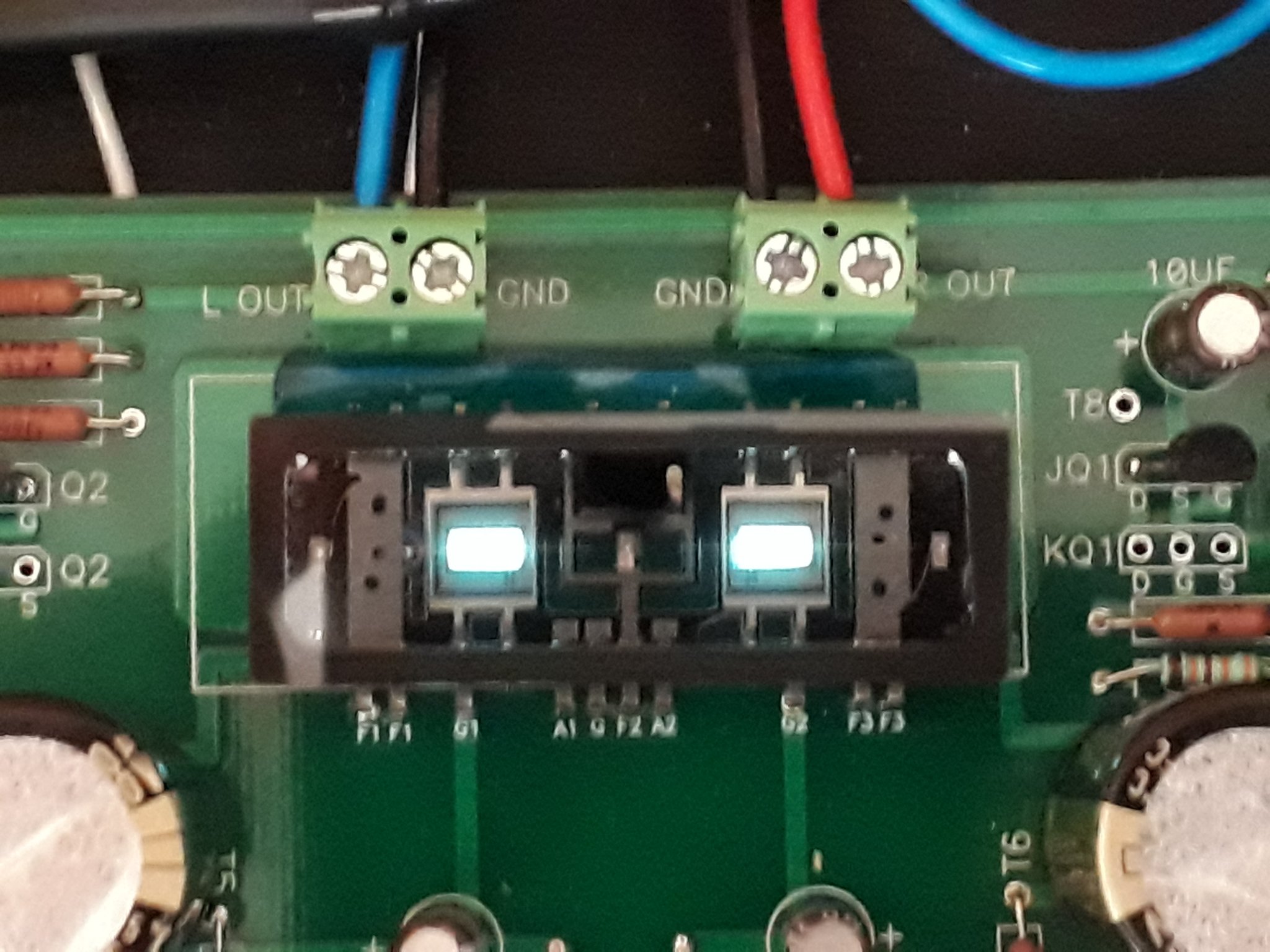

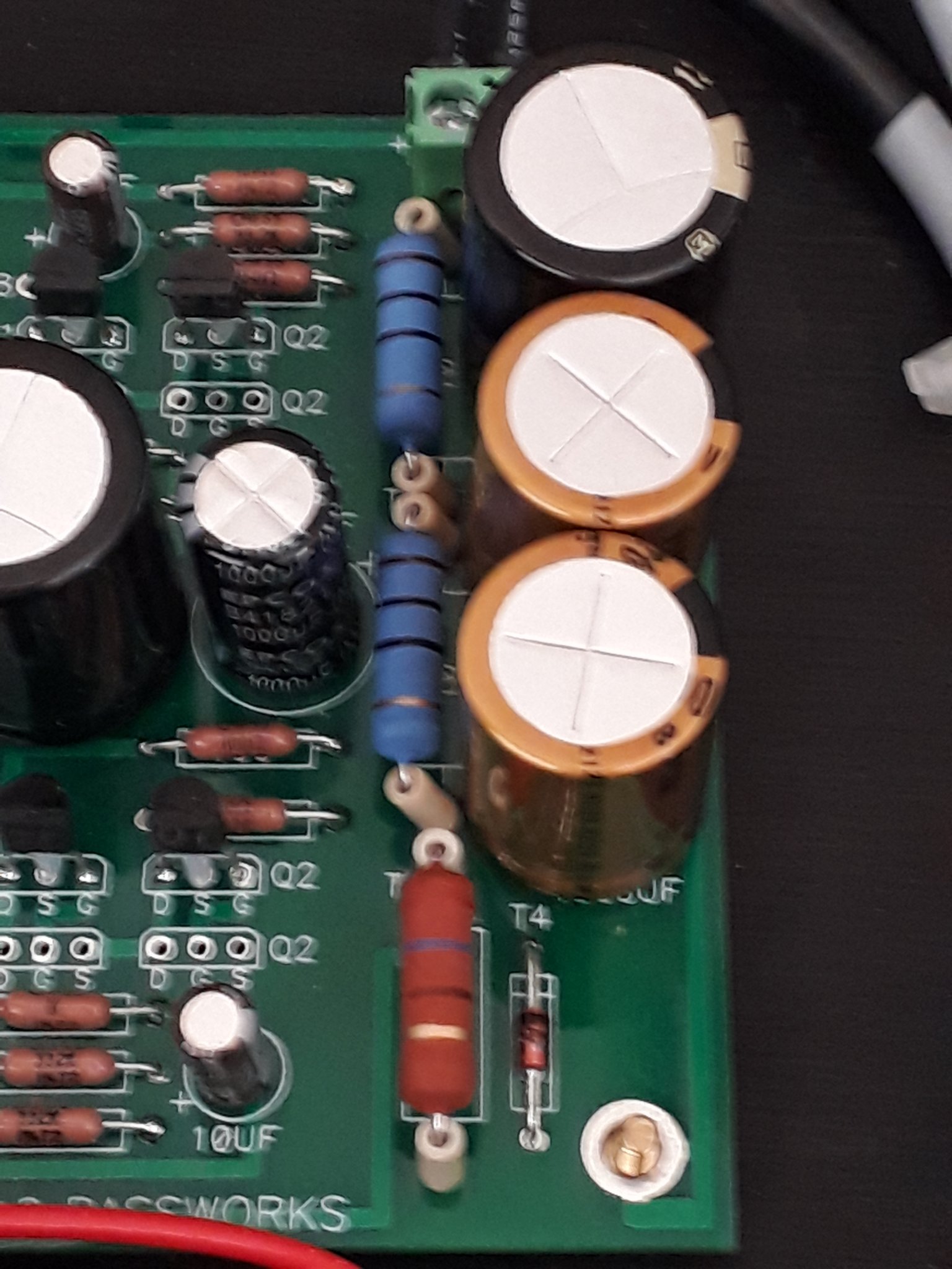

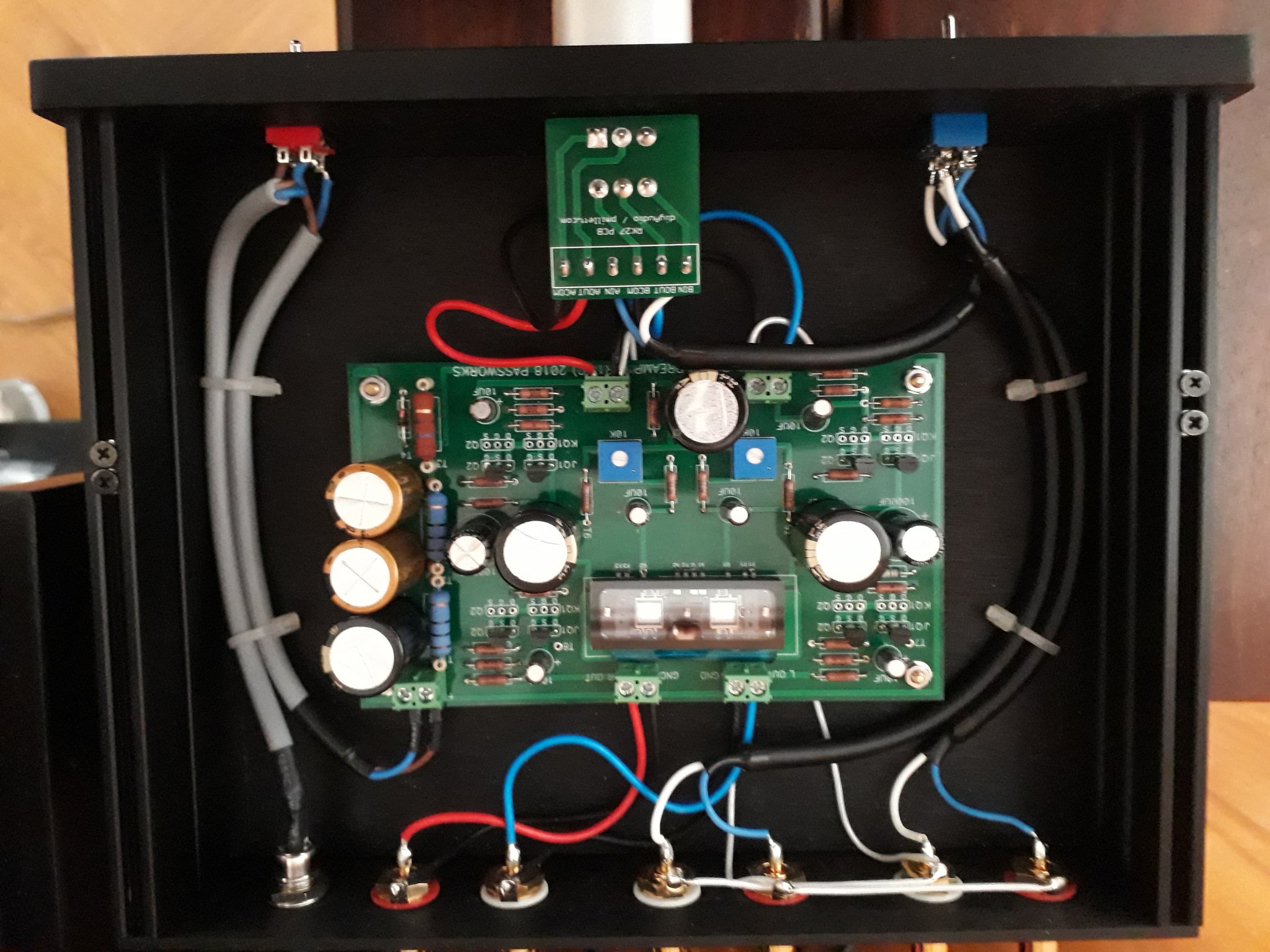

I put some images of my little beast; hope they will go through.

It is seldom a bad thing to have a PSU away from your unit. Having said that, once properly earthed and with a lid, it might not have been an issue anymore. Anyway, you found a solution, so enjoy this little unit!

You are welcome. Soon after i did post my mail it starded again as the B1 was now seated on the amp. So has you said i closed the box and till now
music is playing with no more assle. Just the j-fets that needed intimacy. Good Earthing should be a rule to everyone for safety my dad always said to me

The hiss is there and at the same level, even if the volume knob is at zero. I also noticed a much louder buzz when I touch the B1K and that sound gets louder as I turn the volume up. It goes back to the hiss when I take my hand off.Most likely you have too much gain with b1k in your system.
I opened it upp and made sure there was no resistans between any of the ground points. But I noticed that the case wasn't connected to ground. Shouldn't it be? I thought it would, because the stand-off nuts was grounded, but it seems there is no connection to the case despite the screws. (I have the full kit from diyAudio Store.)
Do you think I should try to get the case grounded?
Anodisation or paint on the case panels needs to be ground off in places to make good electrical connection between the various case parts. Otherwise, the anodisation or paint make good insulators.

I've now made sure the case is grounded and the buzz when touching it has gone completely. But the constant hiss is still there. The level of noise is the same regardless where the volume knob is set. So it doesn't seem to be in the signal, but rather the device itself that has this noise. I can live with it because it's not very loud, and the sound of the B1K is truly beautiful. But I'm trying to figure out if I screwed something up when building it, so I still wonder if anyone else has noticed the same? Without the B1K my system is dead quiet.
Can the hiss be generated by the SMPS somehow? I'll throw in Mr Johnsons DC-filter and see what happens.

As i said, it could be the overly high gain inducing noise. You should try it in a system where there is already an amplification required trough the preamp. B1k nutube has quite substantial gain.
B1K here... dead quiet as original, still dead quiet once slightly modded, lucky me 🙂
Noise has never been an issue TBH.
Grounding can be the main issue, then of course checking all your soldering points are Ok / reflow if in doubt.
Last but not least of course some SMPS can be noisy. I don't know if Mark's excellent filter can change that in your case (nor if that's your issue), but given it is an improvement it is hence anyhow good to have whatever the SMPS you keep.
Can't you just use another PS, be it SMPS or not, even a low quality adjustable one, to check if the noise is still there or changes?
Good luck, at the end I see no reason why a working B1K shouldn't be dead quiet and that is even when connecting HP directly to it...
