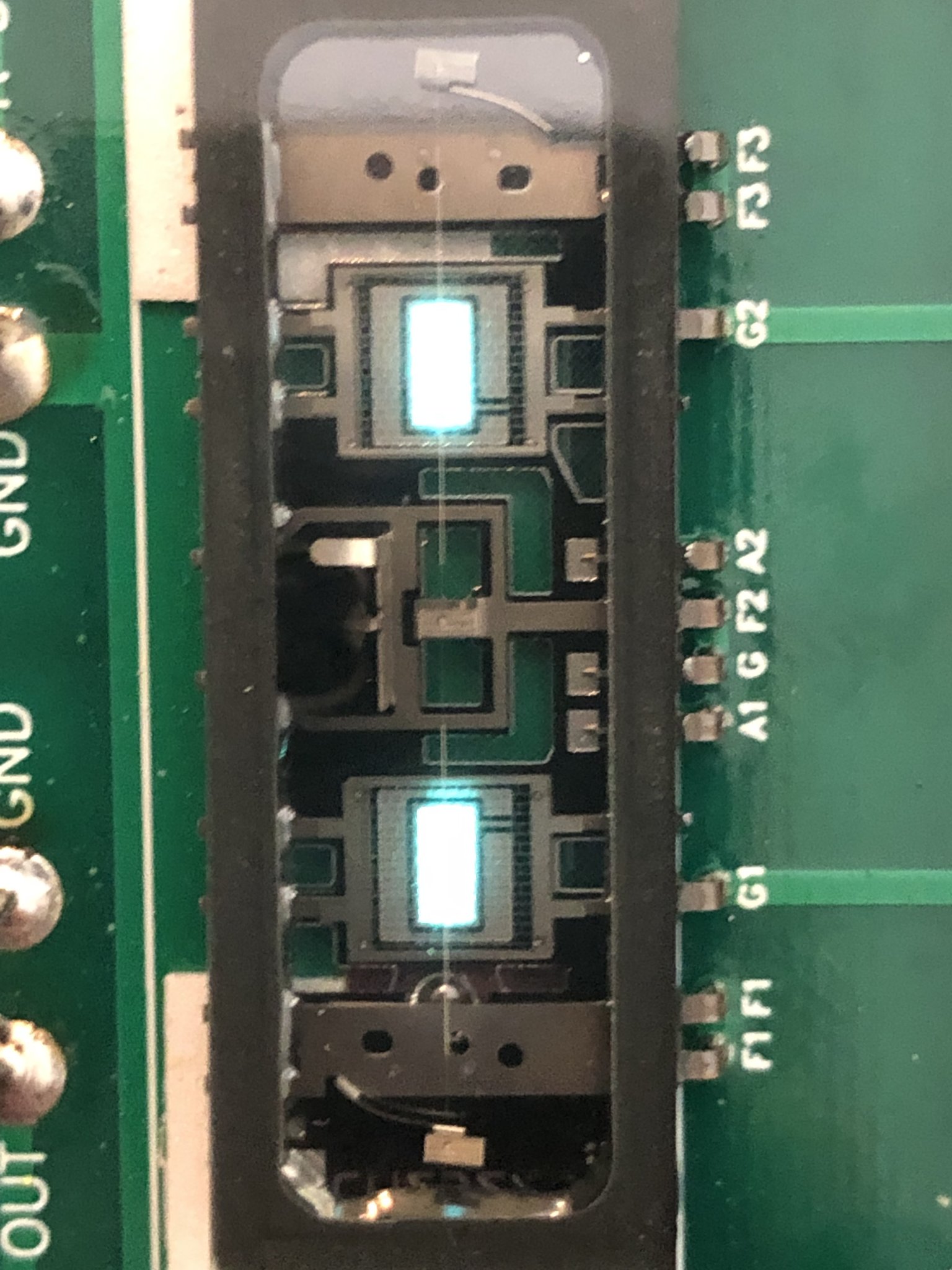

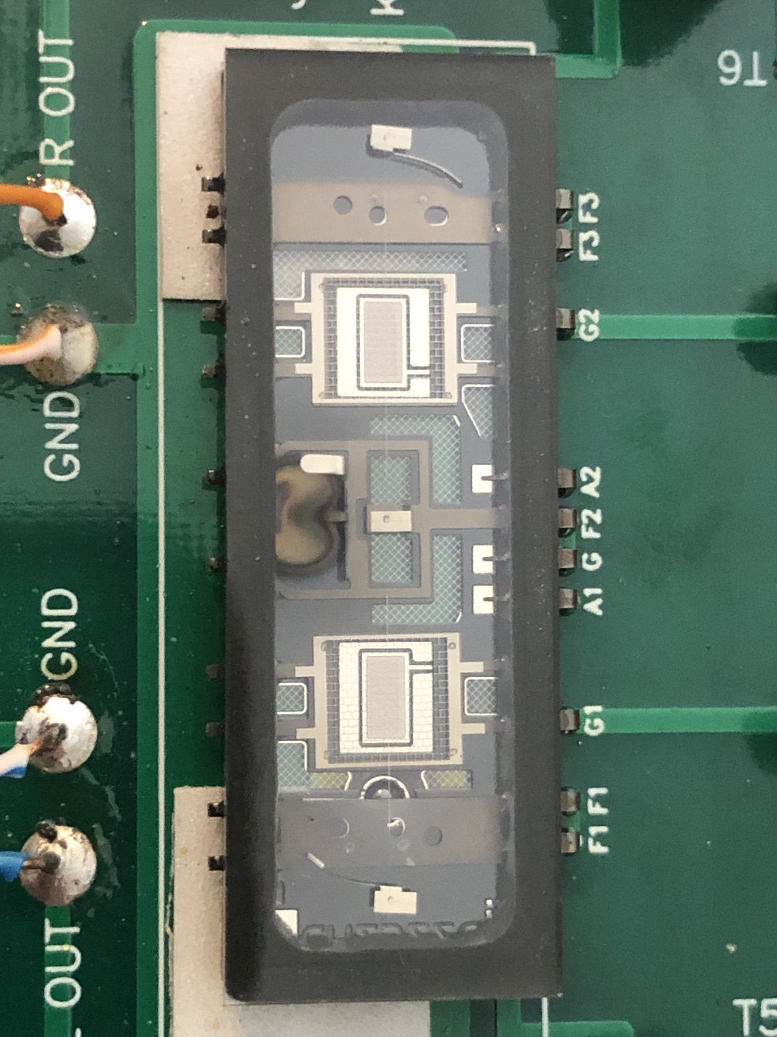

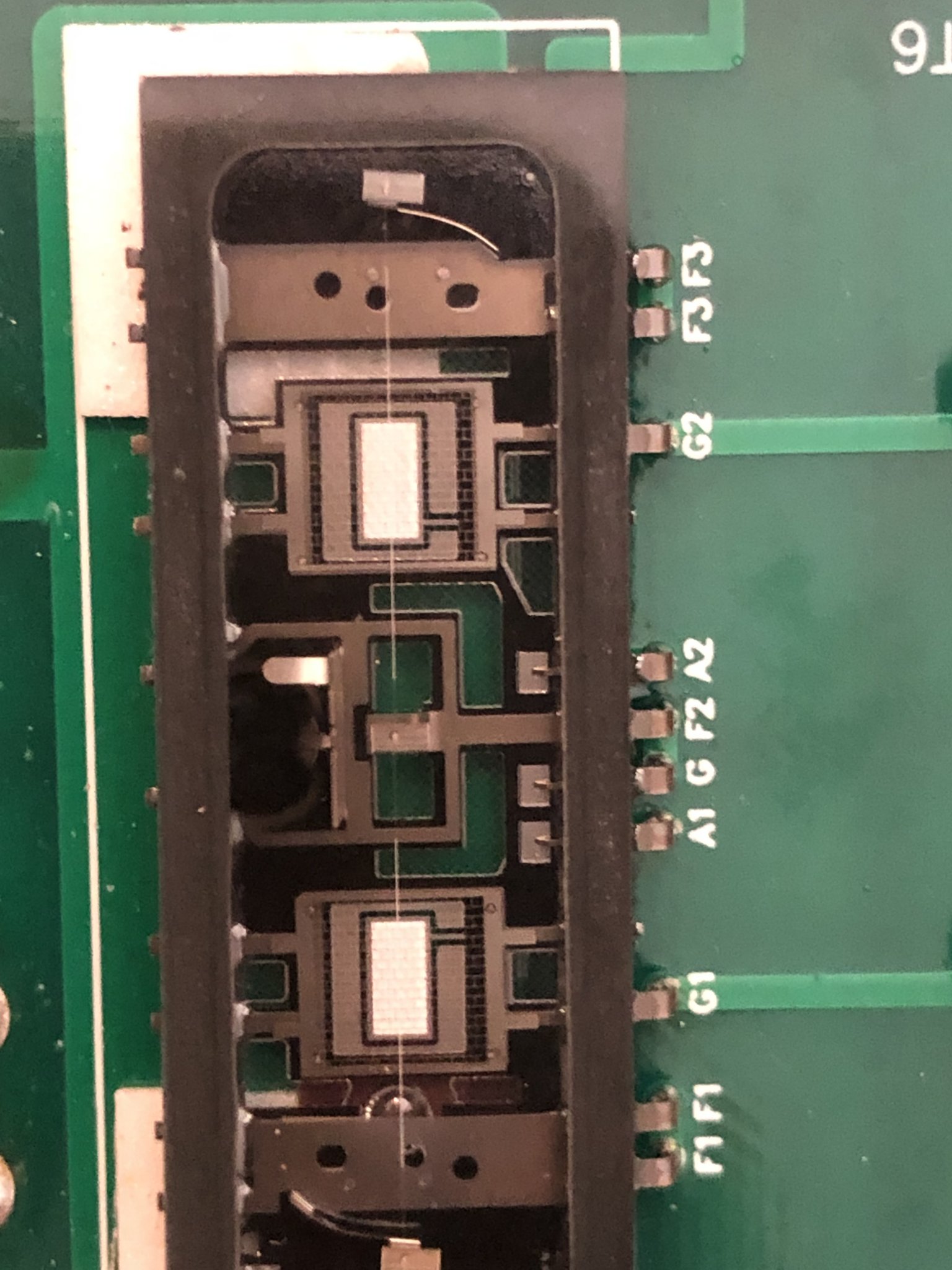

I'm attaching pictures of the nutube because I admit, I am not sure I know exactly what I am looking for. To me, it appears symmetrical. (I had to take the pictures anyway and send to my computer because my old eyes could never see that level of detail anymore...) Ears are still good though.

All your voltages are in range, the Nutube lights up, all point to a working B1 Korg. Have you tried it with a different amplifier?

Both channels of Nutube light up.

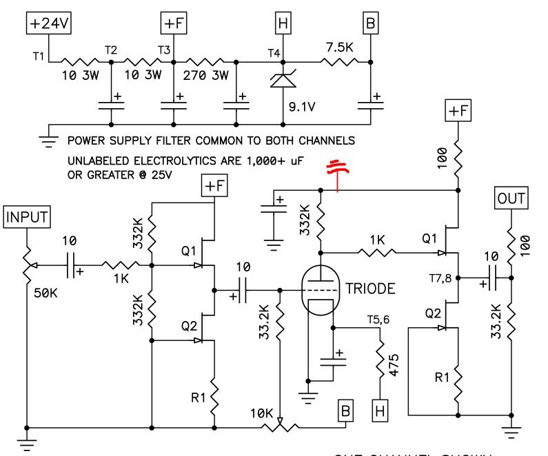

Please check the voltage at Q1 source/Q2 drain relative to Gnd. Voltage should be approximately 12V.

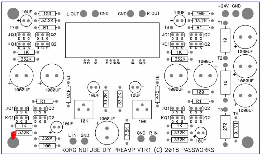

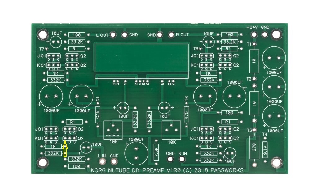

OK, I'm back to this. Thanks for your patients. I checked the voltages on Q1/Q2 as Ben requested. 10.6V for all on both channels. So, I went back through what I know and I made a mistake in what I said previously in two areas. First is, even though I grounded the 332K resister at the bottom left of the board, (see attached) it was not +F, but close. Also, the channel that is not working is the right, not the left. I marked the spot where I grounded the circuit on both attachments on the left channel. So, why am I not getting an input signal coming out of the volume pot on the right channel to the board? Is the pot bad? Or is the signal being pulled down to ground somewhere? Thoughts before I start to desoldering things?Thanks guys. Something more to noodle. I've been poking around tracing the signal. I've got input signal in both channels through both inputs. ( Left, right in both input 1 and 2) through the selector switch to the input of the volume pot. However, the output of one of the channels from the pot to the input on the board is getting pulled down to ground. So, I jumped the known good input signal to the output of the volume pot/bad channel input and that signal also got pulled down to ground. That is as far as I got, then I needed to clean things up. Unfortunately, I am going out of town early tomorrow am. and will not get a chance to pick this back up for about a week. I will start next time looking at the voltage on Q1/Q2. Thanks for the help so far. Regards.

I've flushed all joints and still... then I noticed that the faulty side of the tube has its thin microphonic noise wire broken on the outer side,
attaching a pic, is this it? F1 side
