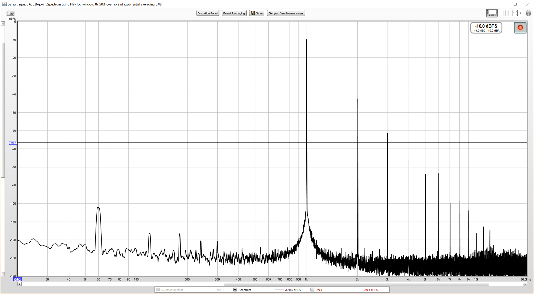

Ok so after realizing the last measurements I posted had some things wrong with it and wanting to know if I just didn't know how to measure properly or if something was wrong with my preamp, I spent some time trouble shooting it.
I figured out that my Focusrite sound card is probably the issue plus there was some interference from my desktop monitors, amps and other electronics.
So I took some new measurements and they look much better.
My signal generator is battery powered and even when plugging that into my sound card i still get a 60hz bump. Even when I plug nothing into my sound card that 60hz bump is there so I don't think it's the preamp.
This is 1v out and the nutube set at 9.4v.
Hopefully this is what it's supposed to look like.

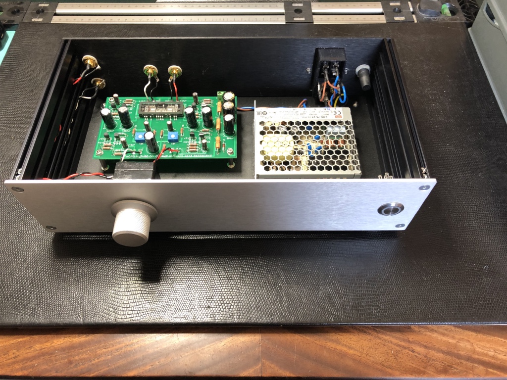

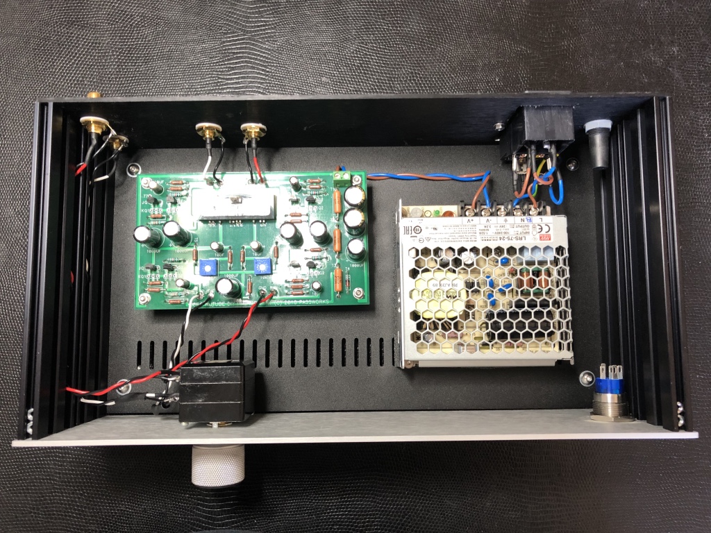

I finished the preamp and tried after 72 hours of heating, the B1 Korg.
A small report was needed because this preamp is well worth it.
I wanted to make it as minimal as possible and for a cost not exceeding $ 200:
One input, a potentiometer, the Korg card of Nelson with its Meanwell 75/24 power supply and one output.
Optimization of the links so that they are as short as possible and use of an excellent potentiometer: the Alps RK40.
The listening base: CD pro2, Dac PCM 1704, VFet from N.Pass, Tannoy GRF + ST100, Belden and Mogami cables.
Although with a sensitivity of 95db GRF, no hum.
However if you tap on the card, a microphone noise is heard, but who would enjoy playing the battery on the card?
In this configuration, the best sound (for me) is to associate with T7 / T8 at 9.7V and the wiring to the out of phase speakers.
The sound is ample, with a nice bass base, well timbre and associated with a great speed on transients (eg CD: The Ozelltapes Marcus Miller disc 1 / band 4)
I compared the Korg B1 with 3 other preamps: Accuphase C2000, Luxman CL360, and a DIY SE 5687 WOT in the same configuration as written above.
The Korg has nothing to envy to these 3 preamps, it is closer to the DIY SE5687.
Now, he misses it to be universal, an excellent phono input.
Thank you Nelson for this great exercise.
Good DIY to all,
Christophe
