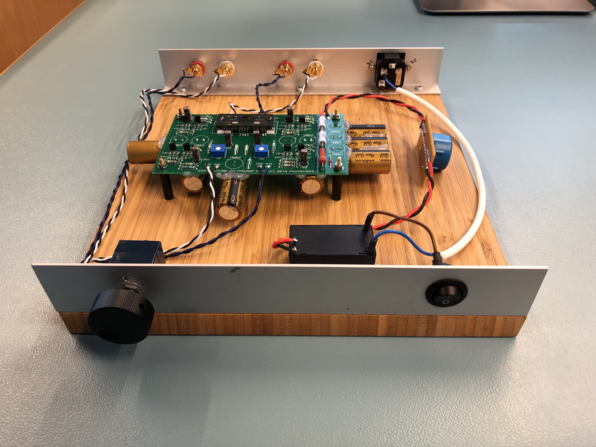

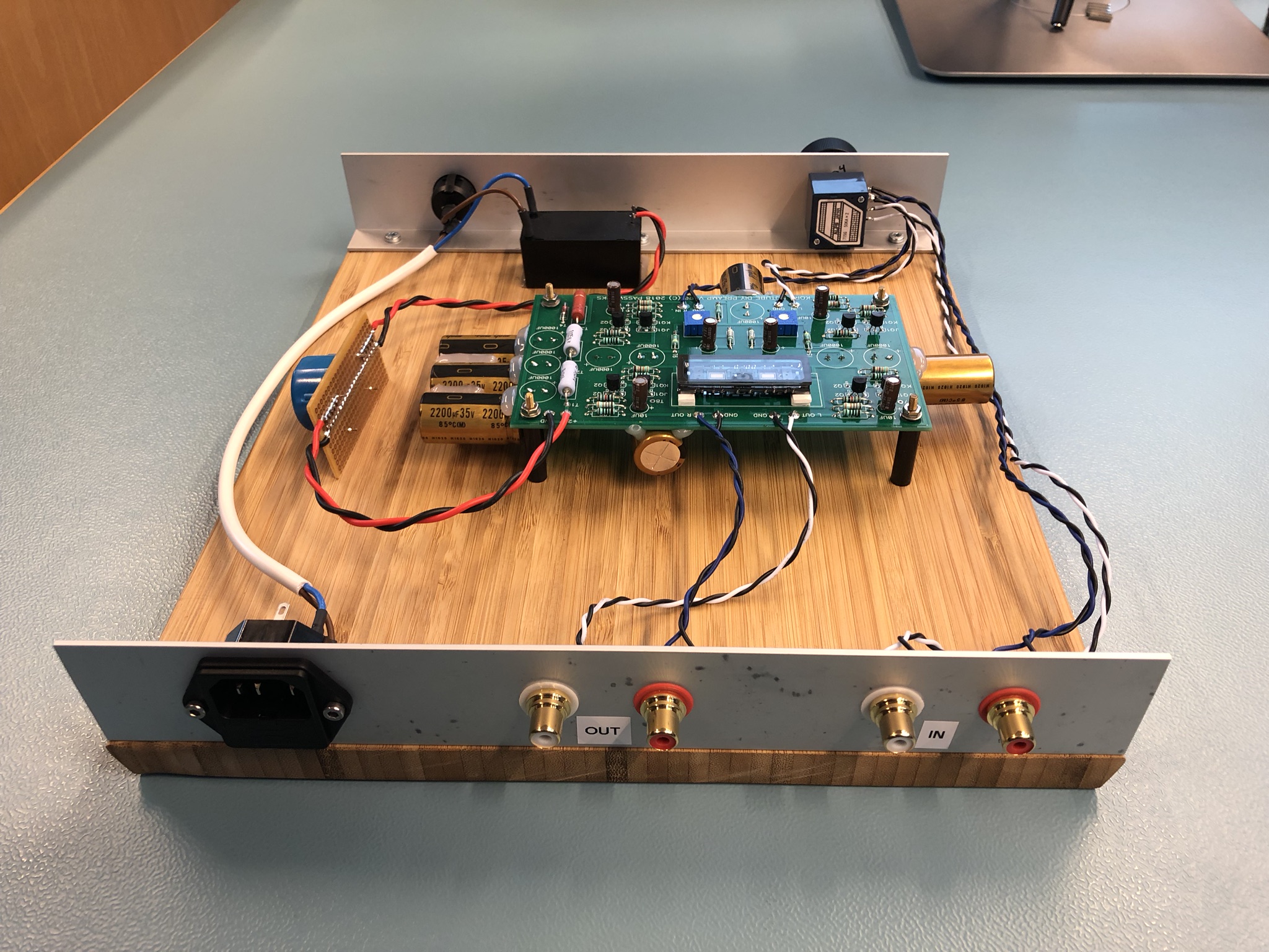

Finally!!! Xmas board. Tube on Sorbothane-felt-foam standoff.
Note the Bass clef shaped leads to play better bass :rofl:

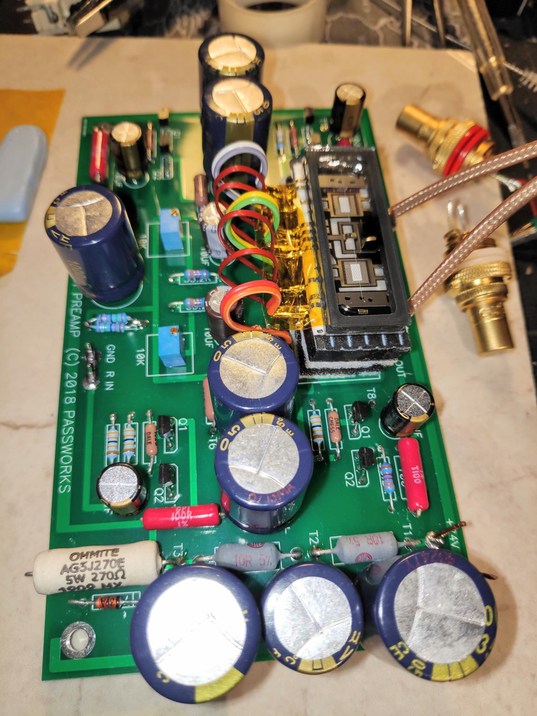

NU Tube B1 Xmas board up and running! Initially I'm blown away by the sound! Frankly I was not expecting it can keep up with my 12B4A dual mono ultimate build preamp but in some aspects it is even better. Musicality, tonality are the first things to notice as strength. Of course absolute transparency and stage can not keep up with stepped attenuator having small 50cent pot for now, and probably some veiling by elcos in signal path... BUT its potential is so obvious that from the first moments I knew it is a keeper!!! It deserves a nice enclosure and proper attenuation.
All my voltages are in suggested ranges:
T1 23.85 vdc
T3 23.09vdc
T4 9.06 vdc
T5 0.623 vdc
T6 0.632 vdc
T7 9.55 vdc (after 1h)
T8 9.55 vdc (after 1h)
BIG thanks to Mr.Pass for this!!!:hbeat:
