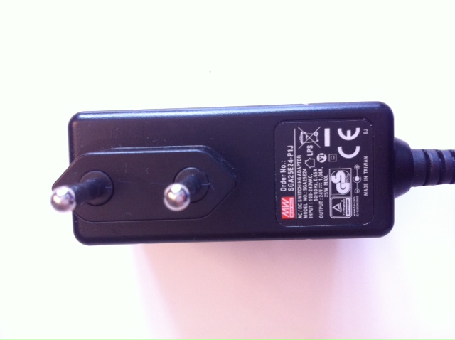

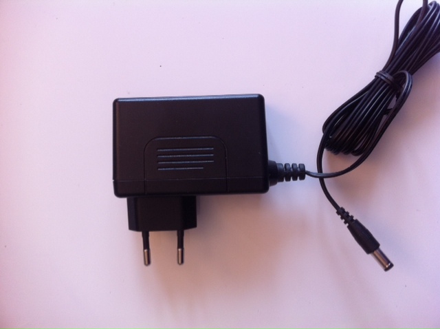

The power supply I (based in EU) have purchased is
MeanWell SGA25E24-P1J
It has a slim form factor, 1.04A rating good regulations specs, is a well known entity, and has a quite low ripple of 80mVpp - but this is just general spec and doesn’t necessarly say something about the sonic quality, but well…
I hope it will perform well with its low ripple while being able to cope with the extra surge when increasing the value of the 3 filtering caps on the board...

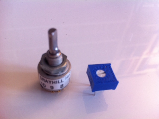

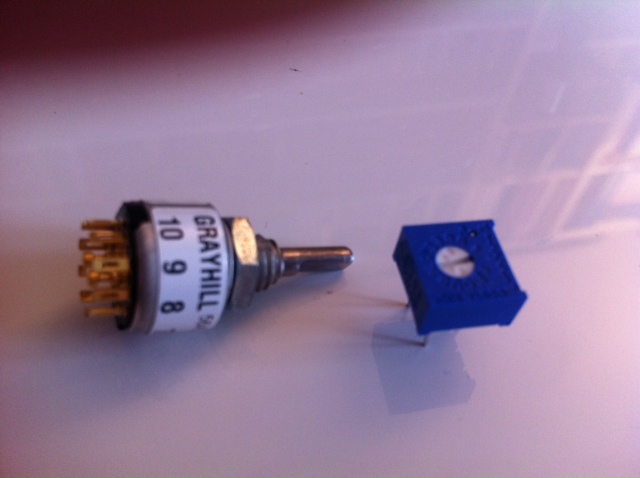

Source switch can be complicated to find as so many options, so here is the shorting one I use, courtoisie of 6L6 Further, source switches can be complicated to find as so many options, so here is the shorting one I use, courtoisie of Jim alias 6L6 who was kind enough to guide me on that aswell
56A36-01-2-03S Grayhill | Mouser
Jim posted already on that, in case the reference wasn't completely explicit here we go again. It is as you can see really a tiny switch, but really cute and well made, with clear contacts and low resistance values.

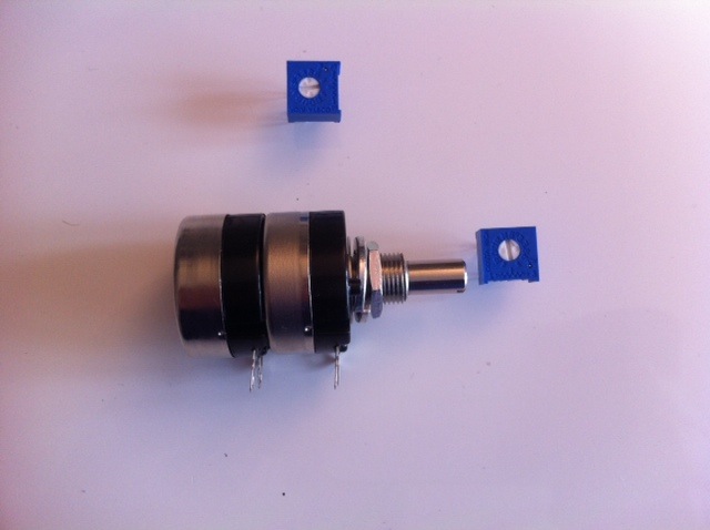

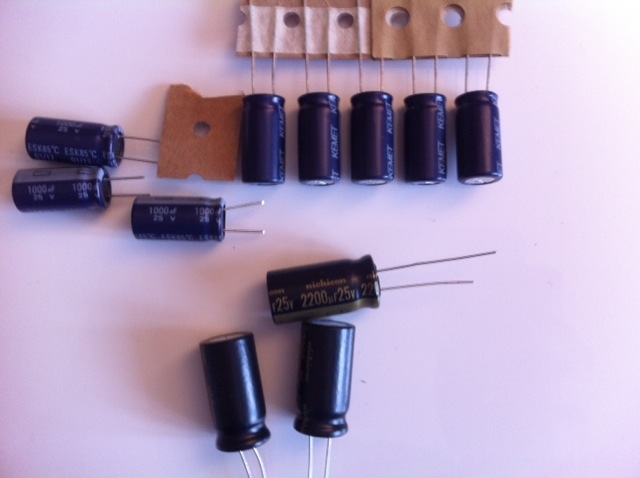

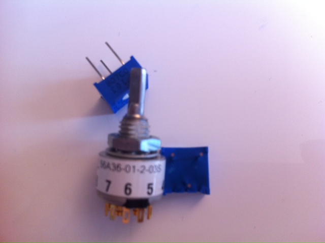

In terms of goodies to test as alternative parts, this is what I have in my bag 🙂

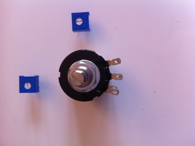

I attached 2 pix of a Tocos potentiometer - no clue if that sounds good but is supposed to be an alternative to my beloved Black Beauty while being really non expensive, so worth digging and I purchased one. It is advertised with 5% tolerance and indeed it measures quite OK - more on this and some further ideas to follow.
Next question I have is: is increasing the filtering caps from 1000uF to 2200uF worth doing, despite the low ripple PS? Will it start again with the wallwart supply? I hope to find out soon and to assess in what magnitude the sound changes... or not. Papa encouraged us to play with and likes big caps, so worth assessing for me.

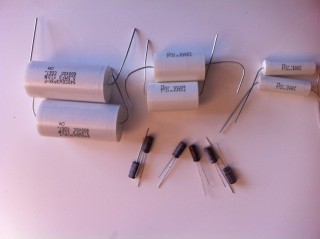

And last but not least, the usual cap in the signal path debate. On one side the recommended ones, on the other big PP. Hope also to do before / after comparison and stick to the best option, as sound preference only matters and I have all parts anyway.

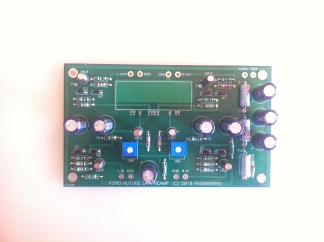

Progress are slow on my side as only able to work when the rest of teh family is away the WE or in bad late night... small fingers are my enemy 😀
To be honest, built is straight forward: just follow Papa's instruction and read 6L6's built guide. Nothing more to say, this should be an easy one. Can't say yet if mine works, but assembling and soldering was really straight forward despite me being rusted on all this.

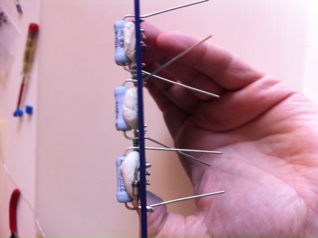

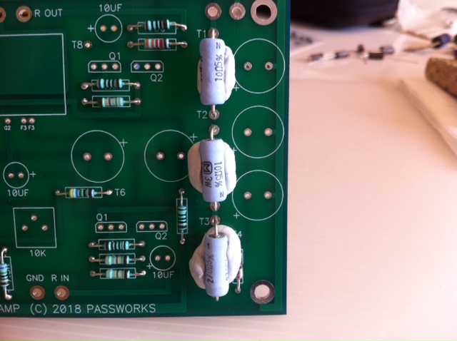

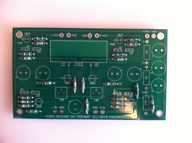

A few pix of my progress and a few notes, well bearing in mind that you are better off taking advices from Jim / 6L6 then taking example on me!
So I started as usualy with the smallest parts, the resistors and the diode. I took then some blu-tack like stuff for the big "power" resistors to solder them slightly lifted to air can circulate. Was only needed for 2 of them, the 10R ones, but it looked better if doing the entire row 😛
I then went on soldering the trim pots. The 10k ones I found don't have the same footprint and pin spacing, so that required a bit of leg bending. Scary, but they do take more abuse then I thought, so adjusting and pressing slightly down worked for me.

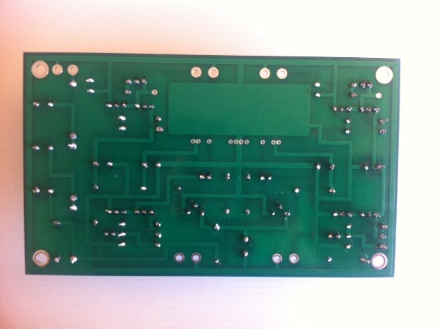

Then I disgressed somewhat from the usual recommandations. Before doing the transistors and smaller caps, I put some big caps in place on all corners so when reversing the board it could rest on my table on these caps and be stable... I found it useful when installing the other tiny and fragile parts. This applies obviously to this built only with caps at extremities.
For the transistors, I simply pushed them in place carefully and soldered them directly from teh back.
As for the small caps, I used Blu-tack aswell to hold them in place, but that was because I didn't want to bend their legs - I intend to solder them in and out, so straight short legs will be easier to undo while being hopefully more board friendly.

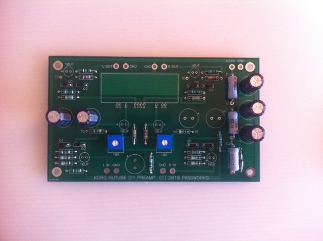

And here we go, the board with all parts - bare the Nutube. That's as far as I went for now, as sadly my expected Nutube never materialised. Not a problem, if you are based in France you can order it quite reasonably from RS - that's what I did, and I expect it to arrive soon.
If you see anything wrong, please shout! I am running out of time but will go through the thread again as I believe I can connect the board to the PS with the potentiometer as load and check some voltages to make sure all is right before installing the Nutube. I will do that... as soon as I get some time again.
Sorry for the long posts, I hope not too boring

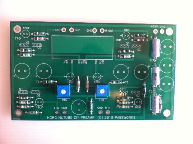

Prototype Store Chassis
Here are some photos of the Prototype store chassis, it's about 98% correct, there's a couple layout issues that will be corrected (move all the holes a bit to the right, move the PCB more towards the center, etc...) but generally this is what it will look like - and I think it looks great!
There will also be a parts kit available, similar to what's shown but not exactly what's seen here. Will be similar or better. 🙂

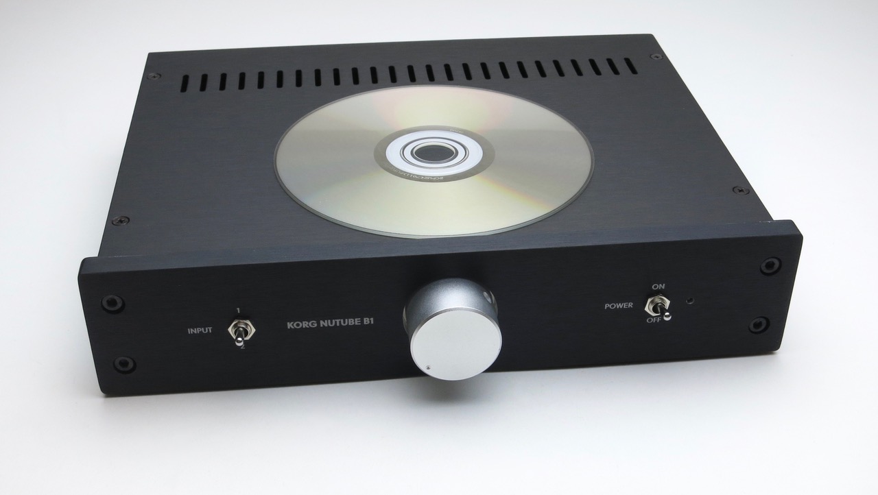

waiting for the official case!
while doing tests in naked mode, perfect performance, just great.

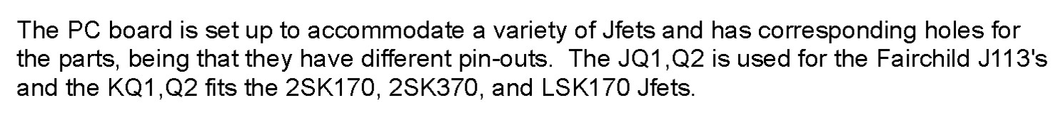

Missing transistors?
I have started building the B1 Nutube, but have become confused about the number of transistors. With the Diyaudio kit, I received a total of 4xQ1 plus 4xQ2 with 4 resistors. However on the print are marked for a total of 8xQ1 and 8xQ2.
Whats wrong? I cannot find mention of this in neither this thread or Nelsons paper?
You can find it in page three of the paper (see the picture 🙂):
http://www.firstwatt.com/pdf/art_diy_nutube_preamp.pdf
missing transistors 2
Sorry to have bothered everybody, it has just dawned on me, J or K transistors right:
