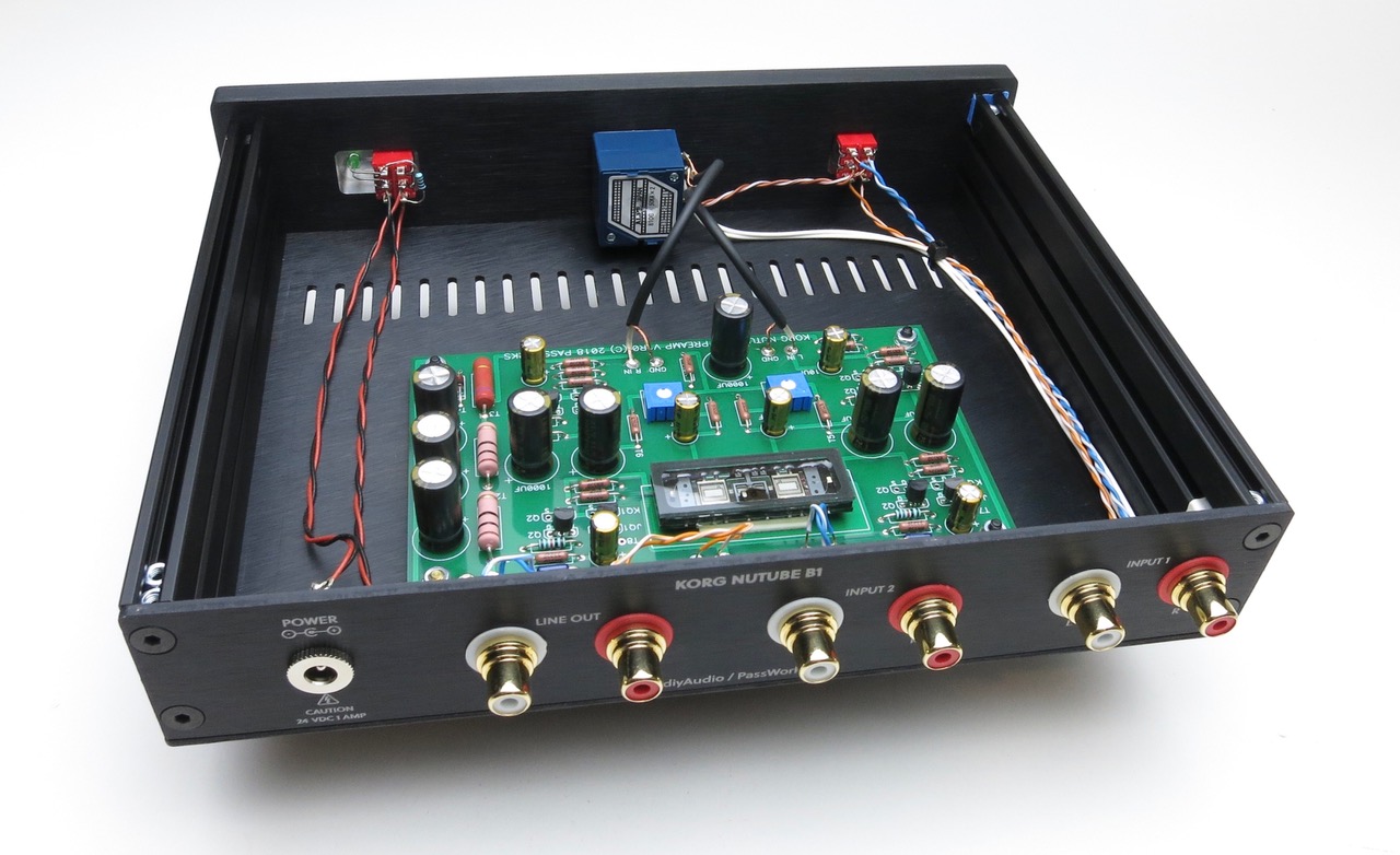

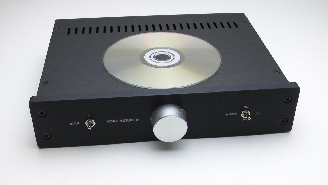

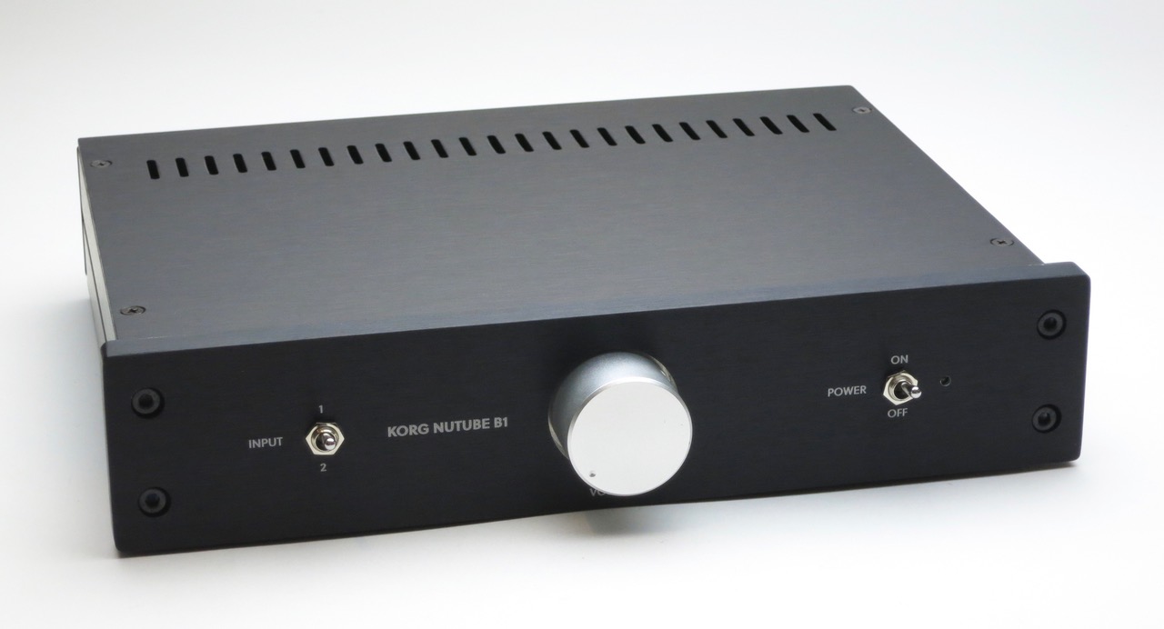

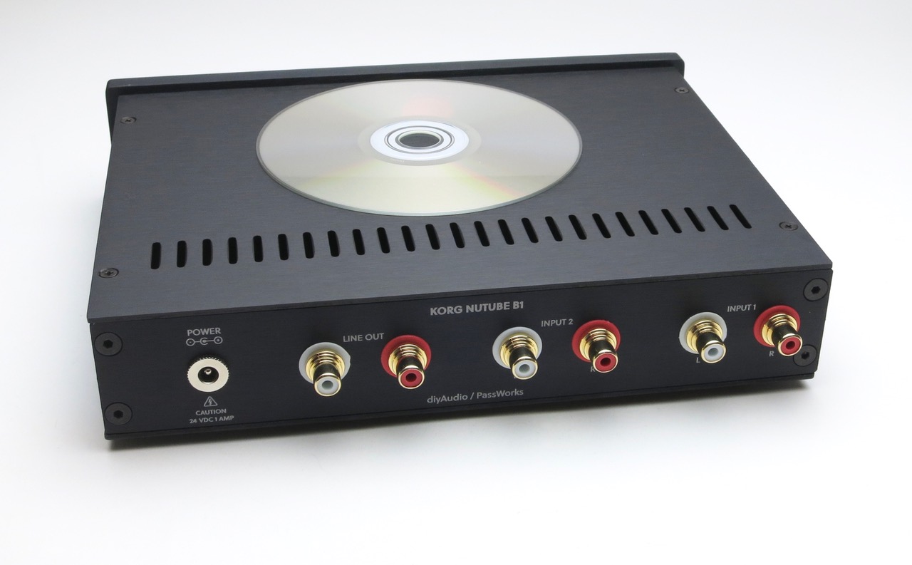

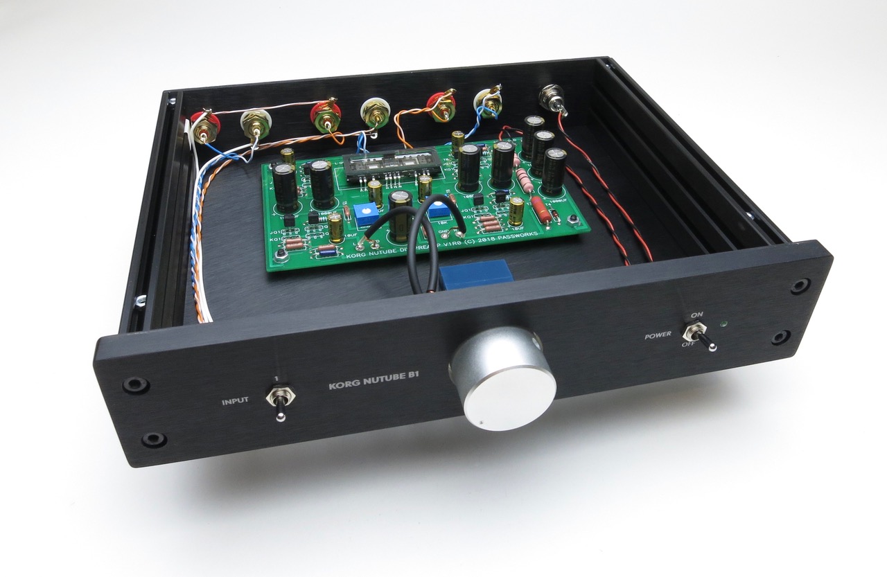

Here are some photos of the Prototype store chassis, it's about 98% correct, there's a couple layout issues that will be corrected (move all the holes a bit to the right, move the PCB more towards the center, etc...) but generally this is what it will look like - and I think it looks great!
There will also be a parts kit available, similar to what's shown but not exactly what's seen here. Will be similar or better. 🙂

Looks really classy!!! From the picture there looks like there's no feet or even pads providing any separation from the resting surface?
It has the little stick-on feet supplied from HiFi2000.
You can of course change the feet to something you like better. I quite like Vibrapods for this circuit.

Beautiful enclosure! Just finished building mine late last night. What an improvement for my ACAs! And no microphonics, unless I tap directly on the glass. Very, very happy with this (humble) setup. My turn to say thanks to Mr. Pass.

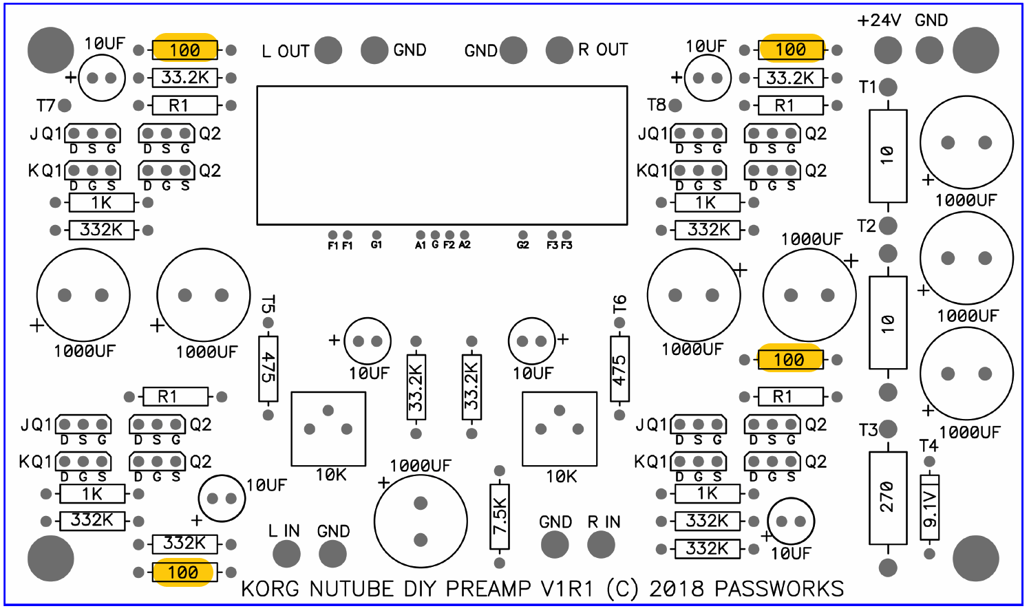

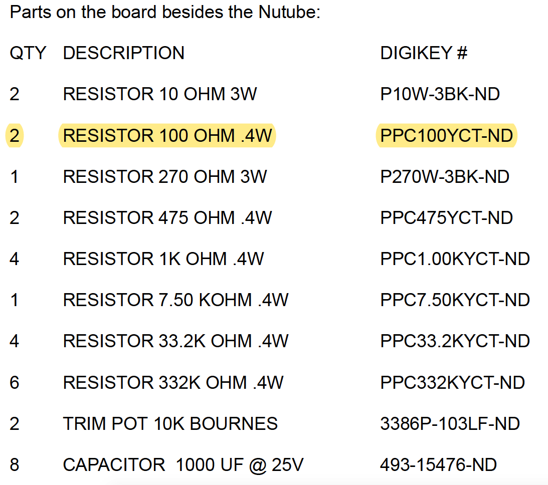

Guys,
perhaps i am wrong, but i think there is a failure in the BOM.
We need 4x 100 Ohm resistors, not two...![]()
You are right. The qty should be 4.
