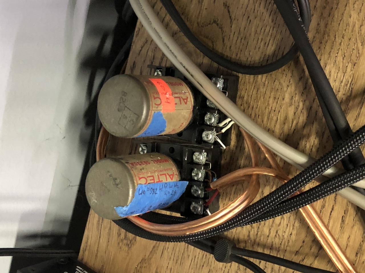

I didn’t see any info on first watt.com and thought there might have been a small production run of the B1s with transformers. It’s disappointing to hear about the back story that it was a gift that was not appreciated for what it was. I inquired about it because it looked like the prototype from Burning Amp but it was already sold on eBay. I’ll just have to live with my cobbled together DIY version Altec 15335As can still be found at reasonable prices (I got a whole box of them years ago for cheap), probably because they don’t have center taps. They work great if you only need 6dB of gain. I connected them to the output of my DIY B1. The nice thing is you can add them to you existing B1 without any mods.
2 15335A
2 octal relay sockets
2 RCA patch cables cut in half
2 jumpers
(I also put resistors across the outputs to keep the load ~15k to maximize bandwidth)
2 15335A
2 jumpers
