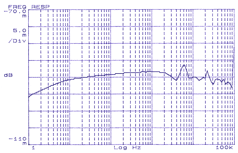

Okay, I have prepared more data for all to use.
I've got the B1 on a regulated +/-5V supply, the results are as follows:
Quiescent current: 14.9mA
14mV offset (input grounded)
Frequency response is within 2dB from 100kHz to 10MHz (measured with HP 654A sig. gen and Tek 2247A scope)
Frequency response graph from 1Hz to 100kHz will follow in an attached image along with graph comparing distortion of HP signal source against amplifier output.
Gain at 1kHz:
Loaded by Fluke 179 DMM: 0.990
Loaded by Fluke 179 DMM and 1000Ω resistor: 0.967
Loaded by Fluke 179 DMM and 470Ω resistor : 0.943
Loaded by Fluke 179 DMM and 100Ω resistor : 0.790
Output Impedance at 1kHz: 25.2Ω (Something weird about that, as if transconductance is very low or something's wrong. Maybe my Iq is too low and I have JFETs at the low end of the spec.) (Or I did the math wrong three times).

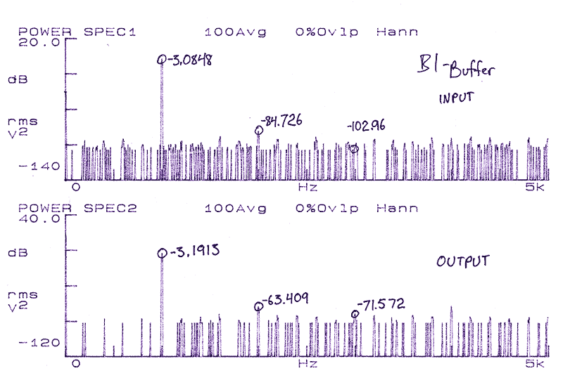

I cannot draw any conclusions from the spectrum analyser outputs. The output has about 20dB higher noise floor than the input (coming from power supply?), but the 2nd harmonics from both the input and the output are about the same amount higher than the noise floor (about 20dB for both).

The FR is essentially flat, as I think 0.01dB is within measurement accuracy ?? Also the dip at LF is due to the coupling cap you are using ? Did you measure the input before or after the coupling cap ?

As far as I know, the distortion is compared to the fundamental frequency of stimulus and not the noise floor when dealing with an amplifier.
Correct me if I'm wrong; and I will research this to be sure.
It seems to me as if the amplifier simply has a higher noise floor than the signal source, and also some distortion. Would others please comment?

I must add that during the frequency response measurement in the image show; I did not use capacitor coupling anywhere in the circuit. This was direct coupled entirely.
That is correct. But since your input signal has already a -80dB 2nd harmonics, and the noise floor is at about -100dB, at most one can say is that the circuit adds 20dB 2nd, but to what (in the case of an ideal input signal, I would say to -120dB noise fllor, which means -100dB actual 2nd). I do not think one can say the circuit itself has a second harmonics of -60dB, because it is not getting a pure sine at the input. The performance you measured is essentially identical to what I posted, and I did not draw any conclusions then because of the same reason, namely the input source is not good enough. A THD meter, which substrates the input from the output, gain adjusted, might improve things a bit, but one needs to have a good, calibrated one around. Not everyone has. And the result is still limited by the level of the noise floor.

Actually, -80dB represents 1/10,000th of the input. But -60dB represents 1/1000th of the output, so it clearly has 10 times more 2nd harmonic than the input, which is much more than the fundamental. Since the two components were not amplified an equal amount, it clearly added some along the way, which we call distortion. In fact, it added about 9/10,000. Since this is almost ten times more than the input had, we can say with fairly good certainty that it has -60dB distortion under this condition.
