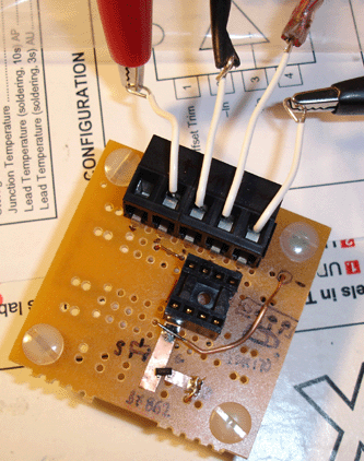

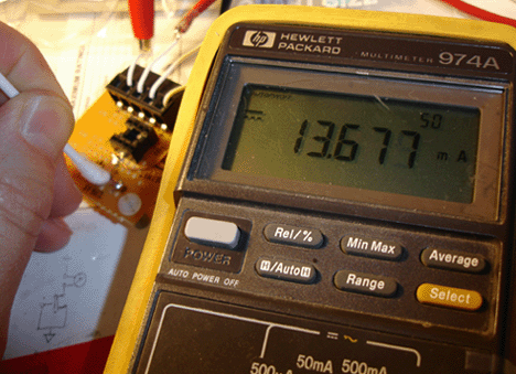

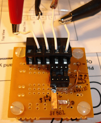

Last weekend I built a BF862 matching rig. I cut two strips of adhesive backed copper and then soldered wires to the copper strips. I can post a picture if needed to "splain" better.
I hold the chips down with a plastic tool and count to 40 seconds with 10V applied. I am seeing parts well centered around 13ma Idss, with outliers at 12 and 14ma. Once measured, I tape the parts to copper foil with a part number and reading. These things are pretty hardy.

The two center leads go to the HP 974A Multimeter, set for a 50 ma current range. This meter has 4.5 digits resolution, and was *not* an inexpensive model.
The two outer leads go to the + (red) and - (Black) leads of the 10V power supply. This HP supply is current limited 250 ma
This shows the BF862 in place and ready for testing.

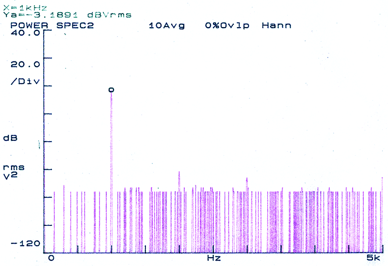

Daniel came home for the weekend and put ours together. Here is a scan of the distortion plot. He'll drop in with comments.

I have put both boards together with some reasonably matched JFETS and taken quick measurements.
I will have to report back with details at a later date as my time is tight right now.
The distortion plot above shows the fundamental 1kHz at -3dBV or so, and the harmonics at -61 and -66 respectively.

As to the distortion levels, the values you obtained are similar to mine :
http://www.diyaudio.com/forums/showthread.php?postid=1774459#post1774459
However, as you can see in Post #11, while the output distortion for 2nd & 3rd are around -60dB or just below, most of these actually originate from the signal generator, in my case at least. The difference between the green and the cyan curves is what comes from the follower circuit itself.
That is why I always measure both input and output signals, as hobbyists signal sources are no comparison to professional equipment. In the ideal world, the green plot in Post 11 should just be one spike with no width at 1kHz, and -infinite dB on the rest of the frequency spectrum.
Patrick
