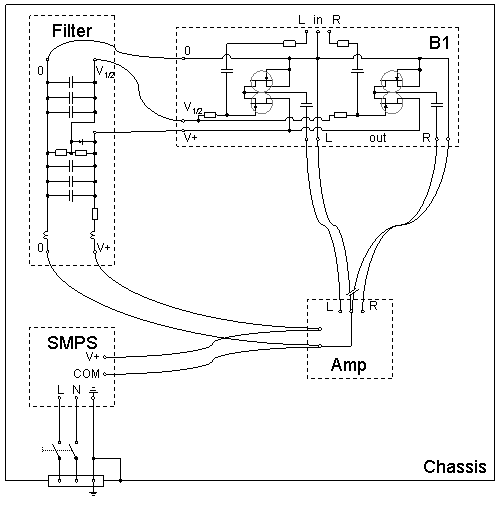

Here ya go, schematic drawing of my setup.
The parts on the boards are roughly drawn how I assembled the protoboards for the filter and buffer. I did the wiring of the boards with enameled wire.
All the wavy lines are twisted AWG 23 CAT5 wire.
I can break the loop in front of the input of the amp as indicated in the schematic. Only it changes nothing.
The only thing that does help is to tie the signal ground to the chassis ground.

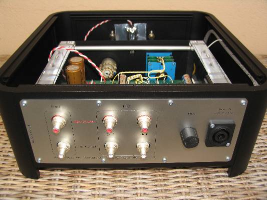

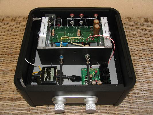

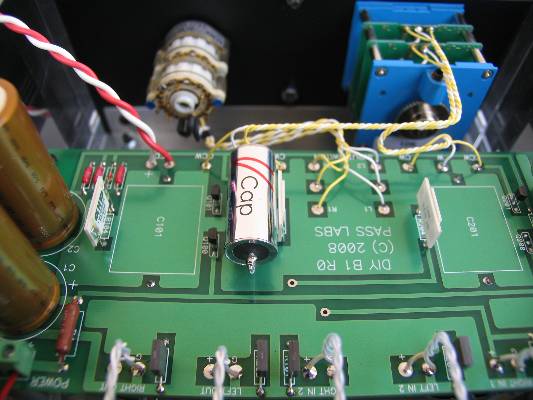

Just Finished my B1
Hi Guys,
Very good information on this thread, I also have built my B1, I’ve used the board sold by Nelson pass, and then implemented my own ideas for component usage, the list it’s quite interesting:
- Fully aluminum body, painted in black powder finish, with solid aluminum knobs, front plate, and black plate with all imprints.
- CMC silver RCA plugs, Neutrik 32A mains plug (the best), and gold plated Bulgin fuse holder.
- All signal internal cabling is Mundorf M-Wire, 99% silver + 1% gold + HGC monofilament pure silver wire covered in pure Teflon sleeve.
- All power cabling from Nordost.
- Input selector from ELMA.
- Volume control based on a Shalco type 41 positions selector, with military SMD low noise resistors – 10K linear type.
- Input resistors Caddock TF020 + Caddock MP130 in other positions. Some PRP, and one MILLS power resistor.
- Signal Caps are V-CAP (the best).
- Filtering caps are Nichicon MUSE gold (> 25.000uF).
- Power transformer is 50VA! R-Core.
- Power Supply based on a discrete Mosfet regulated design, with MUR820 rectifiers.
Sound? Absolutely wonderful. My SF Guarnieri has come to life again!
More photos will follow.
Well, V-caps are new to me, B1 is working since 2 days ago, and they do need quite a big breaking time, nevertheless when I compare with clarity caps (as is), I fill they are much, much better (my opinion), very clear and very much like no cap at all. Duelund, never tryed them
many thanks on your kind remarks!
