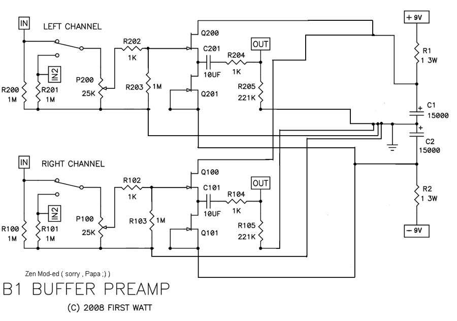

Hi Jean-Paul!
As far as I'm concerned, I'm only referring to the version Zen-Mod has shown (attached below). I don't want to get rid of caps (some caps actually do sound really good ;-), and I don't think the symmetrical ps sounds better than the single one. But, If I want to build this buffer from diskrete parts, hand-wired, on a spare pcb, I find the Zen-Mod version to be much easier indeed.
In this version one can omit: C100/C200, R2/R3 (the 10k's), C3, D1 and R4/D2 (even though one can omit these two in the single supply version, too).
I don't want to use a wall wart, because I really don't like them (again, not because of bad sound, but because I want to have everything in one enclosure). So, if I'm going to buy a small transformer anyway, I could easily go for dual secondaries and wire the whole thing up like shown. My only question was, is it a) necessary, b) recommendable or c) dangerous to leave out C100/C200 in this design?

Sorry guys,
but what does C3 in the original NP design do? It is just parallel to a 15.000uf C2, so what effect does it have? Is it like a small MKP, paralleled to large electrolytics in an amps power supply? Because I never do that (I like the sound of a single large cap better), I'm thinking about leaving this cap out completely.
What do you think?

Nelson Pass said:C3 is a tweak cap to keep the tweakers happy.
Waaaay back on page 56. 🙂
-j
I believe it's to quiet the PS.

Hi Diomedian,
yes, I also found that statement when I rushed through the whole thread, but come on: Take a cheap wall wart ps and a 15.000uF smoothing cap, and tune THIS SETUP with a high-grade-wow-I-can't-believe-it's-so-good- quality-film-cap?
Sorry, but I guess I got something completely wrong here... ;-)

Here on diyAudio we're nothing if not crazy (especially regarding capacitors). Myself I use a $2 cap from BC Components in this position - even that I expect is overkill. 🙂
