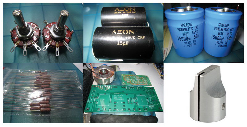

a thought on post 1263's pictures-
good cap, good resistors, great power supply and $5 volume pots- doesn't make sense
there is a readily available stock of decent controls from ALP and TDK- check out welbourne labs and michael percy-
not plugging them per-se- though they are both good to work with, just questioning the balance of the materials relative to the desired finish product
not trying to be mean, just struck me as unbalanced
