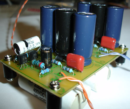

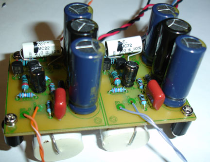

B1 Buffer Preamp
Here's the stuffed boards from above.
I call it a B1 6 pack
:cheers:
Bob

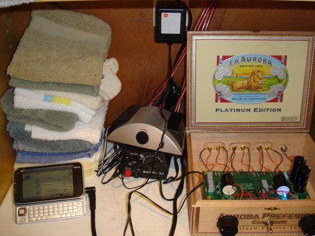

It Works!
I finally got around to testing the Cigar Box B1. I inserted it into my bathroom system where normally a Tivoli Audio Songbook plays through a T-Amp into speakers mounted in the wall. I am using my Nokia 810 Internet Tablet as the source and the T-Amp cranked up all the way as the power amp.
Right now I am listening to a flac file of John Mayall's Bluesbreakers playing loud and clear.
This system is certainly not a big test of high fidelity, but it sounds pretty darn good. I am so psyched!🙂
