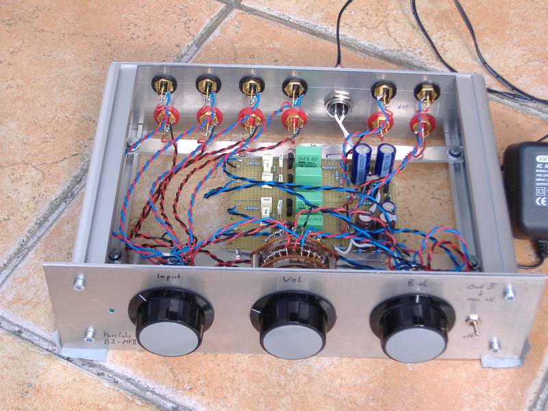

Hi gents,
apart from some cosmetics my buffer amp is finished now. Last night I did some testing and found I like the "sound" very much. The high quality of this buffer will urge you to find out the "weakest link" in your audio chain, it won`t be the buffer-amp. At a first glance it sounds very transparent, just as if it isn`t there.
Attached my "form follows function approach" without the covers mounted. Tanks to Mr. Pass for sharing his brilliant ideas.
I am already unpatient about what the B3 will be like.
Regards, Jürgen

Nice one. Is it 4 channel? buffering some crossover? Single supply version right? Output cap values?
Hi there,
yes, these are 4 channels, more like a B2. I am using the second pair of buffers together with the second output for two purposes:
-buffered output without attenuation for a tape deck
-buffered output with attenuation for sub applications
The switch on the right side serves this purpose.
The output caps are 10uF MKT.
Jürgen

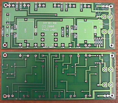

Nelson Pass said:Here's a picture of both sides.
Why are the tracks so thin and the traces of the holes so thin?
They look fragile.
And why did you choose to do double sided?
