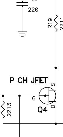

Nelson Pass said:Actually, it's just two switched inputs. They both go through the
volume control and buffer.

The devices are either 2SK170 or 2SK370
Krzysztof said:Hi Nelson,
Did you used in B1 buffor pre following transistors : 2SK170 and 2SJ74 ?
I refer you to posts 45, 46, and 47
for folks that want to read about design of the jfet single ended buffer, i wanted to share again this article from dennis feucht.
i first saw this circuit in the early 70's (yes, i am an old phart 🙂 ) in some old (even back then) national semiconductor datasheets showing test circuits for some of their parts.
i don't have access to an audio precision (maybe mr. pass can share some data at some point), but you can get pretty good performance from this circuit using some cheaper, easier-to-get jfets like the 2N5484, etc. so, save your 2SKxxx for your phono preamps.
enjoy!

mlloyd1 said:for folks that want to read about design of the jfet single ended buffer, i wanted to share again this article from dennis feucht.
An oldie but a goodie. I dropped the Source resistors on mine.
I don't have 2N5484 distortion curves, but the 2SK170 is pretty
spectacular, and the LSK170 is available and cheap enough.
agreed!
also, oddly enough, the 2SK369 is still around and relatively cheap as well.
