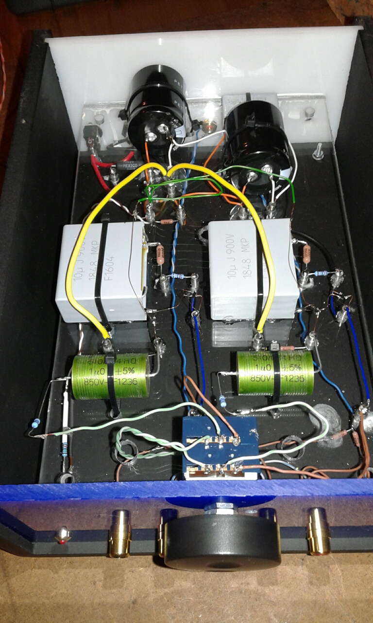

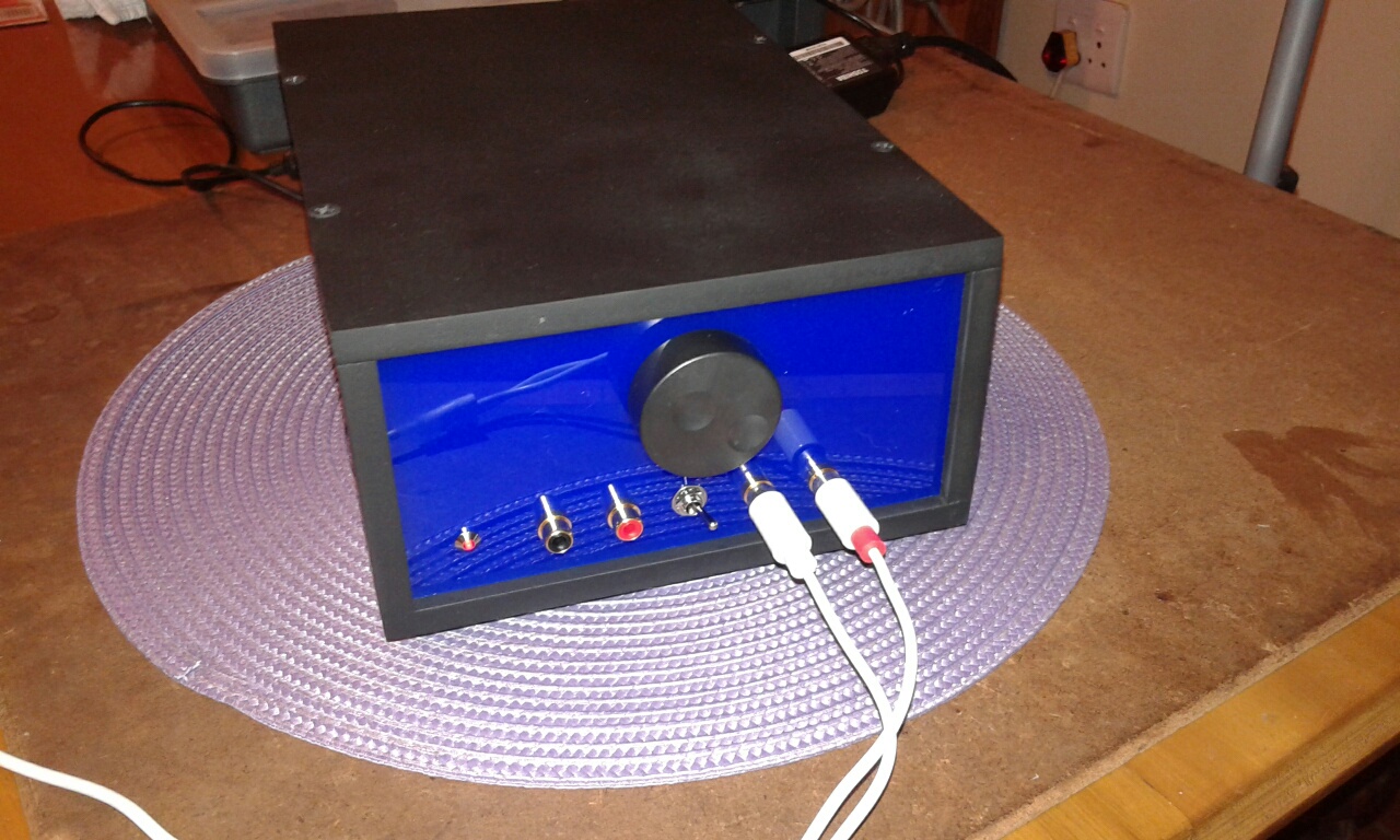

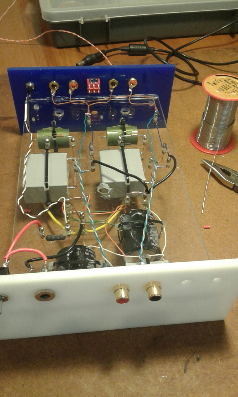

Finished my low cost B1 the weekend. I used matched BF862’s as straight replacements for the 2SK170’s. The PCB is my own implementation of point-to-point, by positioning the components on Perspex. I am not clever/crafty enough to do dead-bug style. Largely Vishay components used – MKP 1839 and MKP 1848 caps with RN55 resistors. Powered by a 19V laptop brick. Apart from using BF862’s the only other mod was changing the output resistors (R104, R204) from 1K to 100R.
The enclosure is made from 9mm MDF and perspex. The most expensive item was the can of spray-paint. A slight upgrade compared to the enclosure in Post 4107.
How does it sound? Well, GREAT so far – compared to my existing 30 year old Hafler clone (long overdue for retirement). More detail, better definition, more natural, not harsh on the top end, deeper and better defined bass. I am very happy. My B1 will be driving ACA’s soon.
Awesome build diyRookie! I like your implementation of the perspex and colours in this build.
I like the perspex p2p solution.

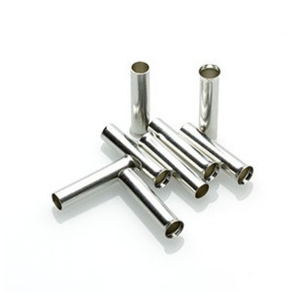

What did you use as soldering posts mounted on the perspex?
I use 1.5mm ferrules (with a 3.7mm drill bit), available here at any electrical shop - used for joining electrical cables. Got the idea from the old turret boards used for the older tube amps (Fender and Marshall amps I think). Probably not the best solution to get short signal paths and eliminate emf - but it works fine for me. This the 3rd amp I have done this way.
what is this?use 1.5mm ferrules (with a 3.7mm drill bit),
Ferrule is the thin plated copper tube that slips over a stranded wire for future fixing/screw down?
OT, sorry, but ferrule is obviously a generic name for many similar things. The ones I use are for joining cables. Not sure what they are called in your part of the world.
