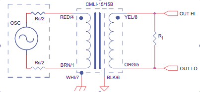

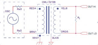

John,
I just got my transformers and I have a question. Since I am running, initially at least, unbal to unbal, my input would be Red/Brwn; output Yel/Or. I would tie White/Blk together to common (and chassis in this case) ground. Is this correct on the White/Blk? I am using Cinemags. See photo attached.
Thank you. 🙂

grounding, when using transformer isolation
I presume you are using the input transformer for isolation, to break ground loops and avoid tunneling noise into the audio circuit. In this spirit,
I would make black to be signal ground for unbal output. White to be ground for unbal input, and DCPS. I suggest that chassis ground should be tied via (dual diodes, transorbs, or varistors) plus resistors (eg 1 MegOhm) separately to both grounds.

John,
Thank you. 🙂
attachment.php
Tom Intrator
Tom, you are very patient, much appreciated, thanks.
Yes, this is primarily for isolation and to hear if I like the transformer sound.
Following your advice, I would tie the WHITE lead to DC PS ground through a 1 megOhm resistor. I assume that resistor will act as a drain and will limit current in the event of a major malfunction.
For the BLACK signal ground on the transformer output, I will tie that through a 1 megOhm resistor to pot terminal #1 or it's corresponding pad on the circuit board.
This is very instructive and doing it has made your elegant B-1 differential setup come into sharper focus.
use the diodes as well, or 10 ohm resistor. MegOhm is only useful in parallel with something of much lower impedance like the diodes.
