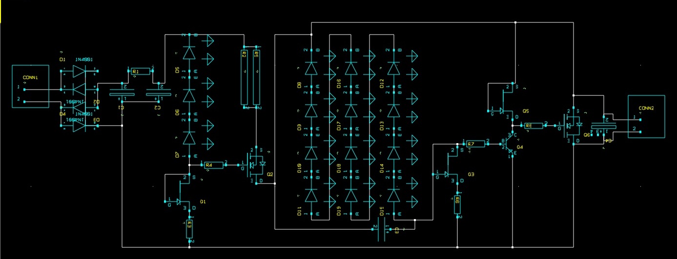

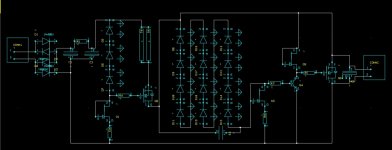

After reverting back to the B1 with the Dual Regulated Salas supply I thought what a waste of a dual regulated supply.
I'm just throwing together some spare components to see if I can produce a single rail Shunt Reg Supply so that I can use the +/-10 V Dual Reg for better things.
You might wonder about my choice of components, but they are what I have lying around.
I'm using 2 x IRF130 which would normally produce the -ve rail but this makes no difference to the B1.
Can anyone spot any obvious design flaws. I'm aiming for about 22-24V out but its not that critical.

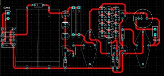

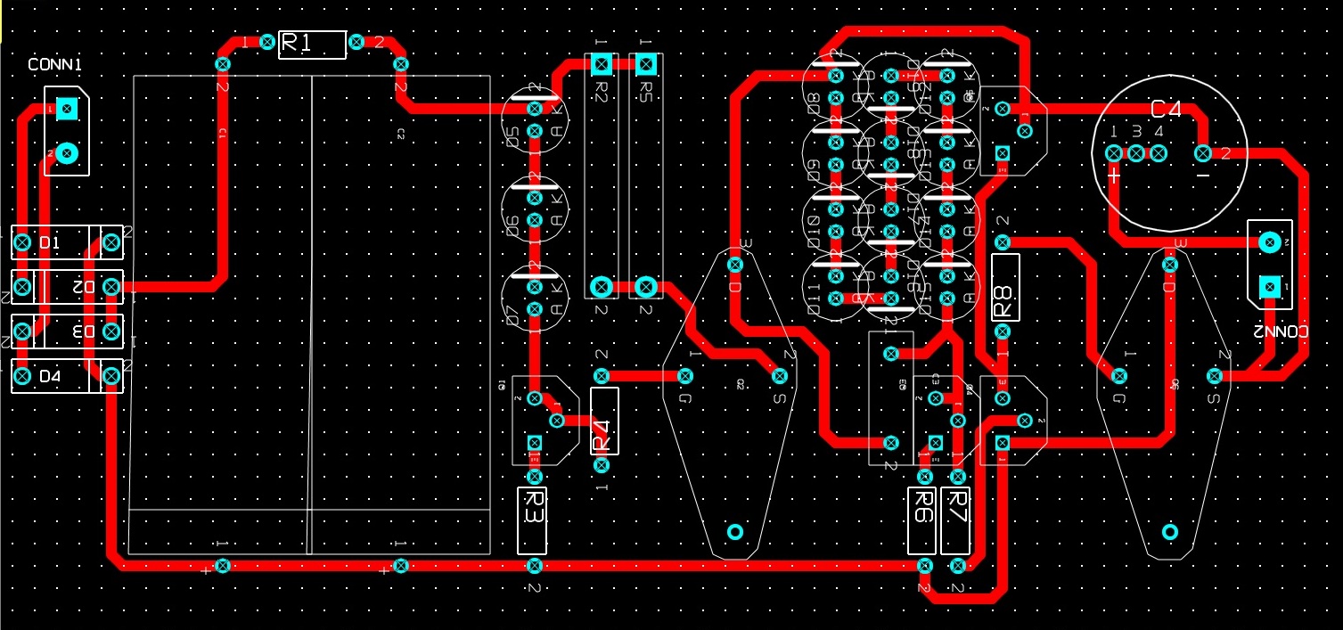

The PCB design checks with the schematic so any errors are not with the transcribing of one to the other.
I know that C3 is shown the wrong way round, that's the cap across the long LED string. It's unimportant as its a polyprop anyway.
22V only calls for 11 x GREEN LEDs. I've only put 12 in the string to allow for adjustment.

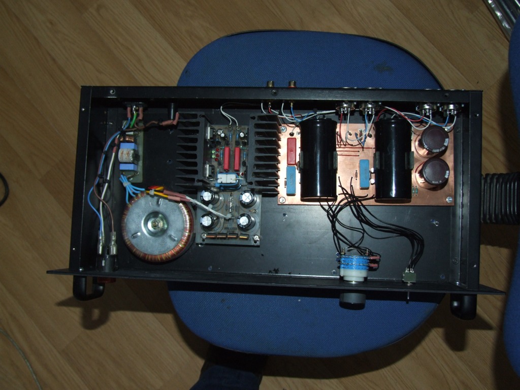

Personally I couldn't hear any difference between the Salas Dual Reg and the LM317 Reg running at 22V.
Do you reckon there might be any benefit in building the single Shunt Reg supply over the Dual Reg ?
The photo is the previous incarnation with the LM317.
Assuming you used the recommended huge filter capacitors on the B1 board, I'd say it shouldn't make a bit of difference which regulator you used. Heck, use a wall wart and make it even more simple. Mr. Pass did that, didn't he?
A laptop-style SMPS power supply, but still a wall wart.
KatieandDad - If it sounds good, is fully functional and hummm free probably the best thing you could do is put the cover on it and listen. Start a new project. Power amps are rather fun, as are speakers. 🙂 🙂 🙂
Nelson did it his way for a reason. I'm tempted to agree with the original design.
A cheap Wallmart might be pushing things but a decent CRC supply certainly sounds, to me, just as good as a full blown Shunt Reg.
I started with a 15VA standard bridge with 4700uF. This was betterred by a 30VA with an LM317 regulator. Above that I couldn't hear any improvement.
And YES, my B1 does have the 2 x 15000uF Panasonics, all PSU caps are bypassed with 100nF Polydrops and even the Obbligato 10uFs are bypassed with 1n5F Polystyrenes.
I'm more than happy with the result.
